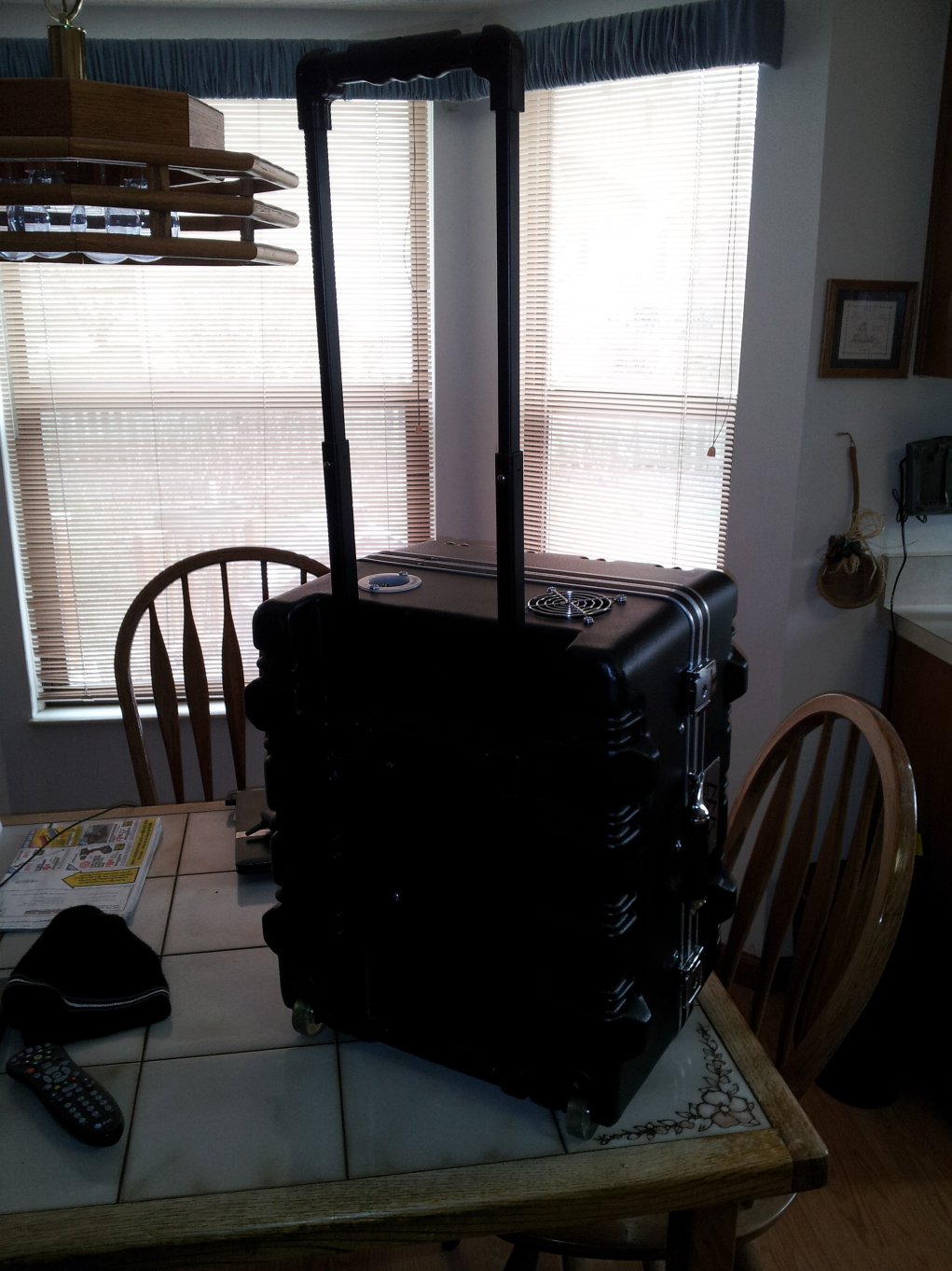

Cyclone hobbies is actually located inside a professional audio store called Sound Ideas (ok, now it is more like a 50/50 split of storefront space :D). That is a HUGE advantage as they have access to a lot of different items, including this case. There are a lot of great features with the case. The first is the size. It is large enough to fit large power supplies and still leave plenty of room for a charger and batteries to not only throw in together when you go to the field, but to also spread on with parallel cables while charging. This case has a telescoping handle and wheels that make it very easy to move around.

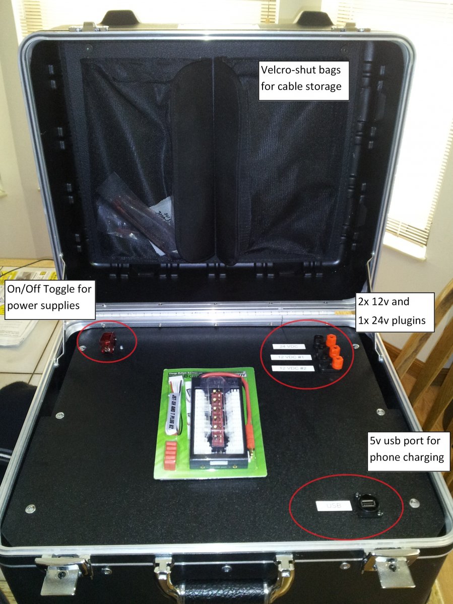

The case also has velcro pockets on the inside of the top which is great for cable storage, paraboard storage, and any other miscellaneous items that you like to have with you at the field like voltage checkers, a common screw driver, etc. The meat of the setup is really phenomenal. On the top left of the platform is a on/off toggle switch that has a cover so you don't accidentally turn it on or off. With my power supply setup, using 2x 12v power supplies, I had him wire it up so that I have two 12v taps and a 24v tap, so theoretically 3x chargers can be plugged in at any given time, allowing me to use a power 1000w 24v charge and a smaller 250w 12v charger, both running at full power (with the power supplies I used). Then, my favorite feature, is a USB jack on the bottom right corner of the platform. There is a 5v regulator tapped off of the power supplies so that I can charge a phone or any other usb device at the field! Really a must have for fly ins!

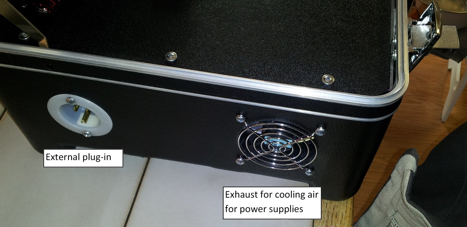

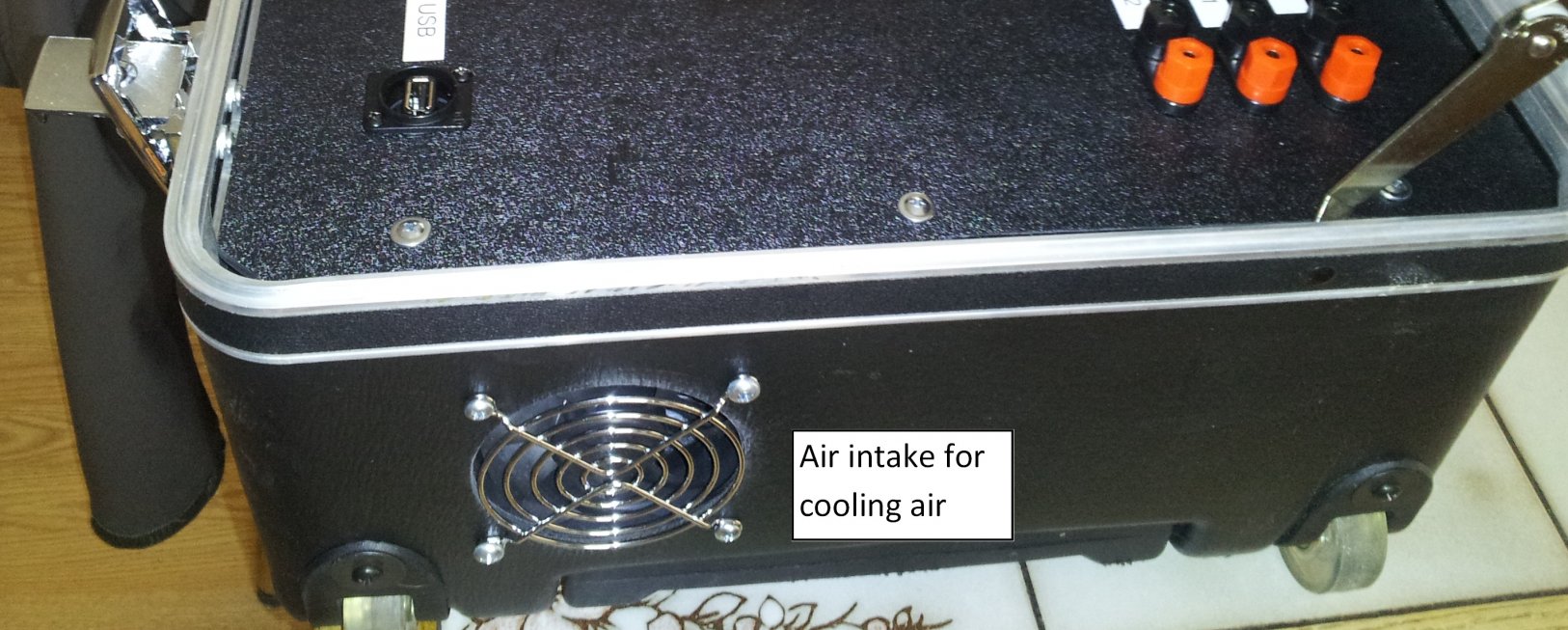

For the business end, there are both intake and exhaust fans wired up to keep the powersupplies running cool. This is an absolute must for any case as these power supplies can get over worked if not properly cooled. I used to have 2x feathermerchant power supplies in an old setup, but burned them up to what I assumed was lack of cooling. There is also an external plug in that is installed in the outside of the case. Very convenient to keep wires from getting tangled and such.

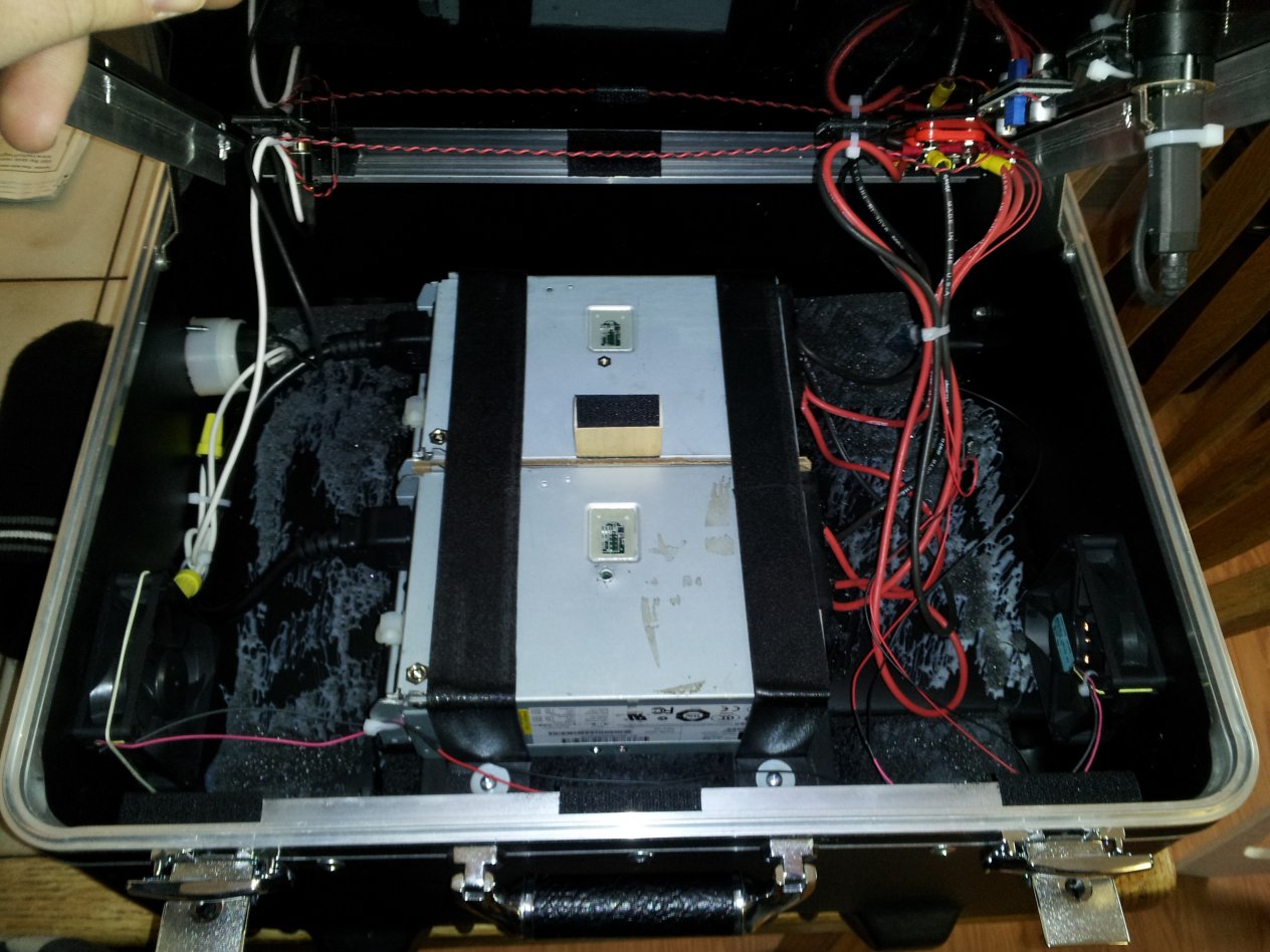

And finally a picture of the amazing wiring job that Stu did for this case. Really makes you appreciate how much time and effort went into not only getting everything wired up correctly, but keeping a clean install.

Info about the case.
I like your setup. Can you post a better picture of the case or do you have its make and model?
rcbirk21
it is made by Vodavi, but i can not find a model number online or anything. its approximate outside measurements are 12"x15"x18"
