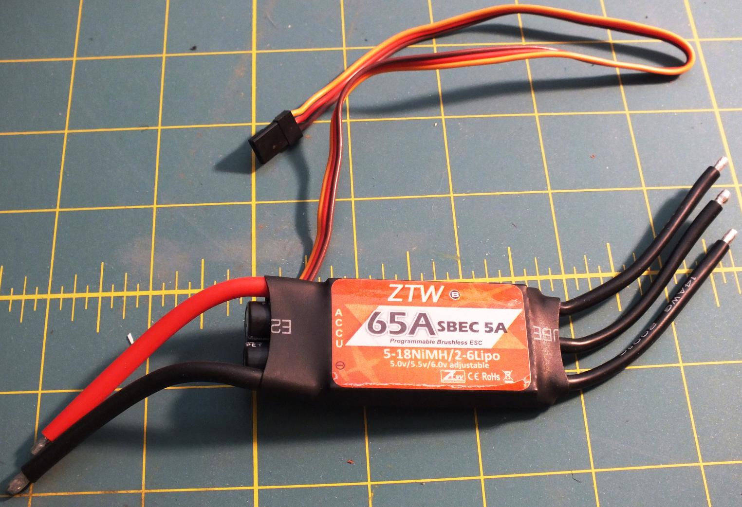

    3DRCForums recently did a review of the 42" Vyper Bype, and we used the new ZTW "B" Series 65A programmable ESC in it.
    What we love about this ESC is that it’s the first ZTW ESC released that has a programmable BEC voltage, allowing a choice between 5, 5.5, and 6v output. With today's servos getting better and better, many newer models optimal voltage starts at 6 volts, and goes up from there, so we really like the 6v option.
    We also liked the simplicity of programming the ZTW with the available program card, which we felt was much easier to use than the original, or "A" series card. Also, there are lot of new features on the new ESC and card: forward/reverse, start up strength, timing, and more!
    Some of the other differences between the B-Series and previous versions are the better internal components and the larger heatsink, and the improved programing circuitry. The ESC felt more responsive to throttle inputs and generally smoother.

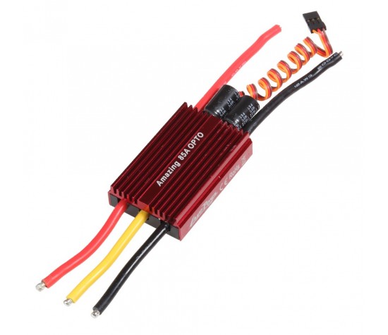

  6. I'll give you one bad thing - on the 85 amp models (and others with exposed caps), the capacitors need some reinforcement. They are just sticking outside the heatsink and will break off rather easily. I had one break off on my 64" MXS. Fortunately its a super easy fix. I replaced the cap, reinforced them both with welders glue all around the base of the capacitor and problem solved.
    I think ZTW plans to address this in a future revision to the product from what I was told by one of the sellers of them.

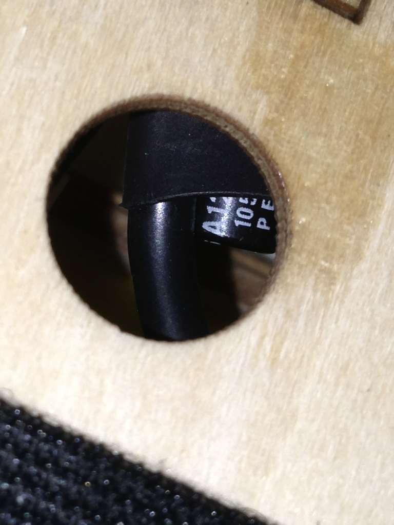

    Ryan, I think you're speaking specifically about the Land Power's capacitors, as on the "B series" they are completely enclosed by the ESC's shrink wrap.
    Sorry for the crappy pic, I only have my MXS with me and its mounted underneath the battery tray.
    The 85a's design and appearance is the same as the "B series" 65a picture at the start of this review.

  8. maybe... Garrett at altitudehobbies told me that their first step was going to be to shrink wrap over the caps, mine is a landpower one. I thought they were identical except in programming, but you appear to be right, looking at quantum's site the B series do look different than the landpower ones. Mine was like this pic.
