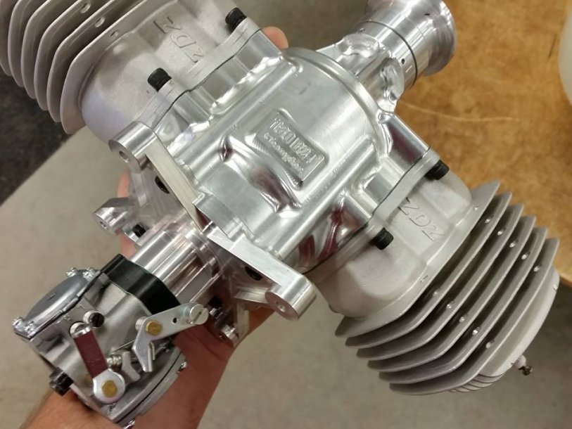

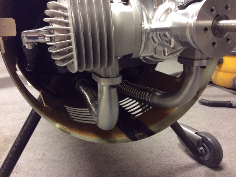

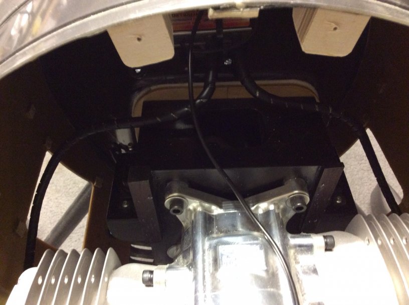

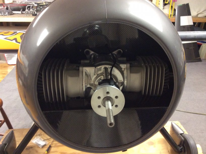

I am putting this brand new ZDZ180B2RV-J champion motor in a recently purchased comp arf Yak 55 3M. We are going to be testing the Nester flex headers and tuned pipes. It needed a stand off so instead of stacking a bunch of wood I decided to build a box 2 3/4" long with some hard pins in the corners. By doing this I can mount the servos on the sides of the box, making it so that choke and throttle are a very clean setup. I did cut a small hole in the fire wall to ensure it has enough air. This plane previously had a DA 170 in it so I did not have to refigure my motor placement.
