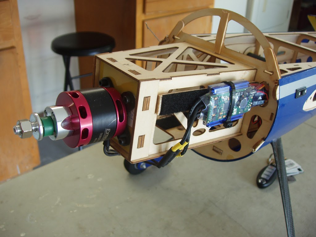

Reviewing The Equipment Set Up
My friend Dan posted one of these videos on Facebook and that generated some interest in my set up. So, for all my facebook friends, here it is.
Extreme Flight strongly recommends the use of Hitec 7245MH servos for the Yak, but at the time I built this plane I was scratching pennies together to make it happen. This was a turn-the-couch-upside-down-and-shake-out-the-change kind of project. I almost had to go to the field and sell pencils to make this plane happen! The plane became available at the worst possible financial moment. All the co-payments from this summer's hospital misadventure (which is being charatible) came in the week before, to the tune of about $3000 that I did not have. I had to use what I already had on the shelf. I took the entire set up of Hitec HS5245MG servos straight out of my red MXS, with the ball links even still connected to the servo arms, and dropped them into the Yak.
Also part of the set up was a trusty Torque 4016/500 Mk II motor and Airboss 80 Elite ESC. To me, all Torque motors are interchangeable, simply because they are so bulletproof. Even one that's been beaten for three or four years is every bit as good as a new one, and the same with an Airboss ESC. This power system is the one bit of used equipment I will confidently put into a brand new plane and not even think twice about. As you can see, it works.
The beauty of coupling this power system with the HS5245MG servos is that those servos run straight off 6 volt of current delivered by the Airboss and it's on-board BEC. There is no need for a separate BEC, it's extra wiring solder joints and potential failure points.
This is a nice, simple set up. You just plug everything in and go. If you are going to hammer a plane every day, you have just got to keep things simple and tidy.
The 5245MG is the exact same size as the HS7245MH, right down to the matching mounting holes. I can drop in 7245MHs any time I please, but the plane is fly so extraordinarily well that I am loathe to change even a single thing. I am almost even afraid to clean the plane for fear of wiping off some of the magic!
Last year I had a few servo arm issues, so I switched to Hitec's PN55709 pack. These are fiber filled nylon and stay tight on the splines, assuring a solid, slop free connection. One thing I have since done differently has been to change to 2..6 X 8MM allen head bolts to secure the arms to the servos (which I get from Micro Fasteners). The arms are very solid and don't compress much, so you have to stay on top of keeping the bolts tight. You can either locktite the bolts (which makes a mess) or crank them down good with an allen driver. The Phillips head that come with the servos can round off unless you have exactly the right screwdriver, but the allens won't.
If you follow the mechanical set up in the pictures, and set your end points at 140% (all I can get with my Futaba 7C), this will give you the exact same plane that I am flying. I run -75% (remember, Futaba is negative) on all high rates, and run the low rate from the manual. All of this is extremely simple and easy to remember, so I use it on all of my planes. I do not dink around with running different amounts of expo on different surfaces or try to get tricky. I took the set up from the manual years ago and simply learned how to fly it. I figured the guy who designed the plane has a better handle on how to set it up than I do, so the manual is the best place to start.
Set up with this equipment, there is next to no maintenance and absolutely no problems or complications. It is all extremely simple, which is a keystone to reliability. I will be able to fly this plane absolutely every day this year, beat it hard, and not worry about anything coming apart. Of course, you have to check things every so often, and I like to tighten the allen bolts on the servo arms at the beginning of every day at the field. Outside of that, all that is left to do is simply fly it.
