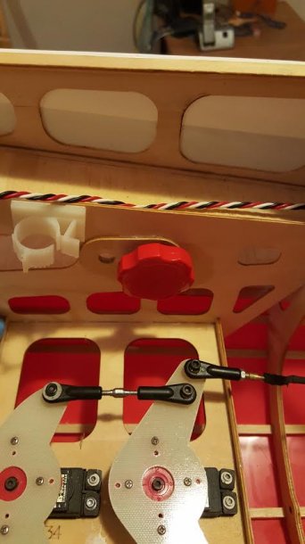

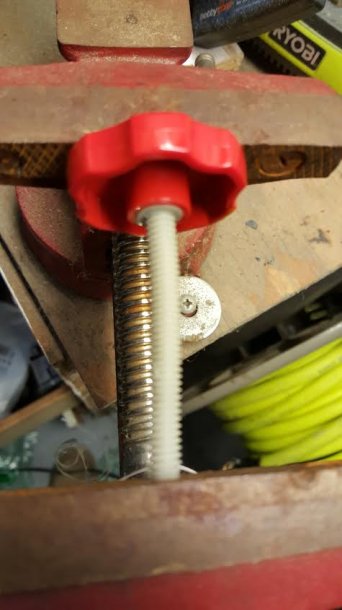

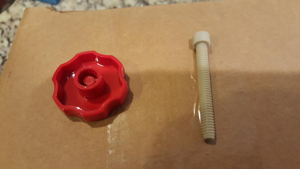

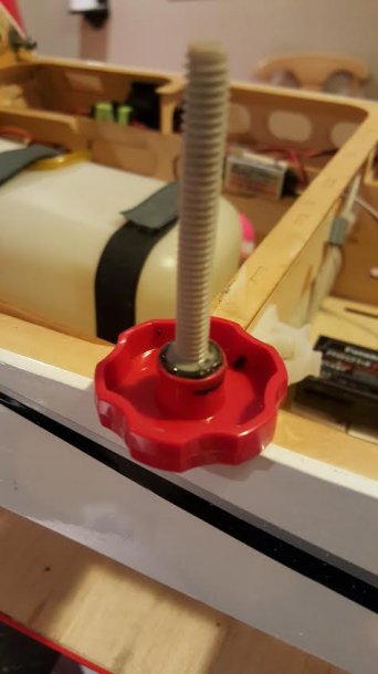

I saw these thumb screw gadgets online and decided to try to add them to a 1/4 nylon bolt. I think they would press fine on a steel bolt but the nylon bolt required some quick dry JB Weld. Looks like it will work.

Yeah, I have some Carden wing bolts that are exactly like this idea (with the steel bolt). Somebody makes them I'm sure. I could probably ask Dennis about where they came from. I do like the nylon version too. The EF 104 has a nylon wing bolt with a smaller type of cap on it. Nylon seems to stay snug. I use nylon thumbscrews on my EF104 canopy now with a bonded washer on it. Faster to take on/off and stays put.
