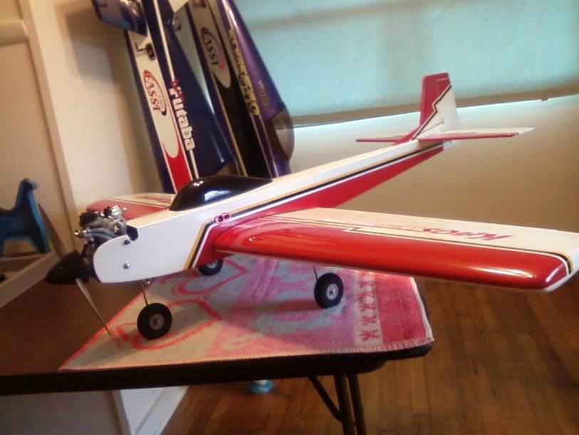

That design taught me how to handle high performance and control it smoothly. It was my first low wing. I put the tower ARF version together this past summer and flying it brought back some great memories. Your plane in the picture looks great and I know it flies "like it's on rails" now that the covering is not allowing "dirty air" on the wing. I got mine to do about 135mph.
Nice Kaos! 135? That is smokin fast and without a pipe? And yes it does fly on rails. It has taught me a lot and enjoy flying it. It is really fast but lands like a dream and glides forever!
-Paul
-Paul
Yep 135! DZ70 12x10 APC. Mikeee.."Try it you'll Like it!"
