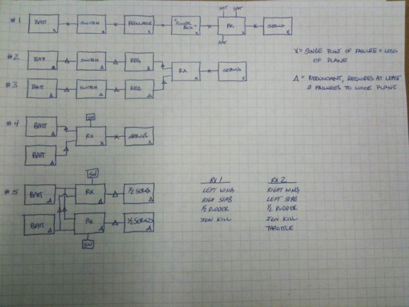

Since you mentioned redundancy, here's a drawing I did a while back trying to explain to people how dual satellite recievers weren't as good as dual receivers.. Throughout the years my setup evolved, eventually settling on setup 5 as the best possible solution I could come up with. It has the least number of single points of failure possible (0) and the highest redundancy. Mainly I wanted to show what single points of failure were since it seems like a lot of people didn't understand that one the forums. Of course other things come into play like budget, space in the airplane, radios ability to run dual rx, etc... I know you didnt ask but I thought it might be a good place to post this pic, hope you don't mind.

9channel power safe RX and done. K.I.S.S. With that you get batt-share, HD power in from both batts, failsafe switch and no fancy switch(s) to purchase and try to put in the side of your plane without looking like :dancing-poop:
M
Matt
Also with the power safe rx you can actually just use a bind plug as the switch... So an extension from the switch port to the outside of the airplane... Pull the bind plug to turn on and out the plug back in to turn off... Simple and no chance of a switch failure at all
The switches that come with the power safe rx are too easy to slide in my opinion and could too easily be slid to the off position
