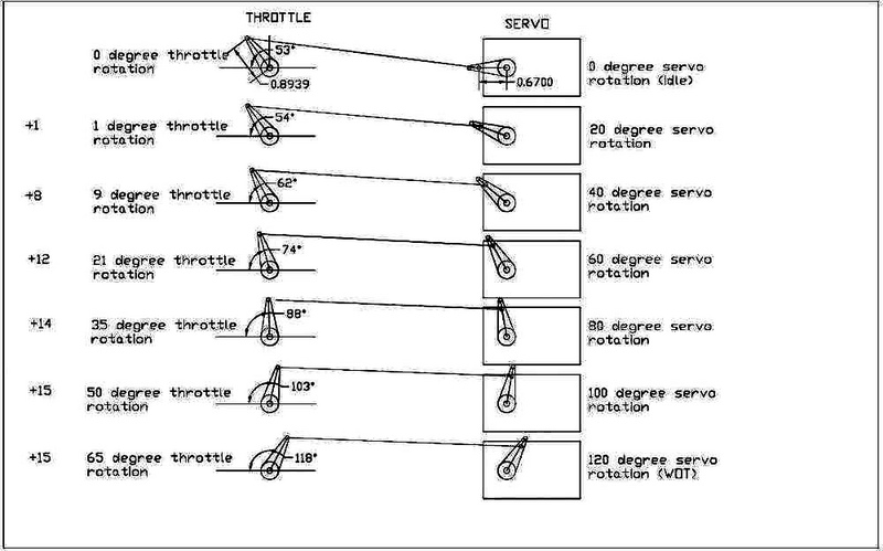

The monitor screen setting is your friend. Look at the throttle channel first, and make sure that at half stick the little indicator for the throttle channel is also at half. Then go to low throttle and make sure it does the same, and then high throttle. It should go down just as far as it goes up (low vs. high settings). It won't go all the way to either end unless you have your endpoints set at 150% on both. Anyways once you have confirmed all that is good, you will know that no mixes or throttle curves are interfering with things.
Like Yakken said, it sounds very much like you have a throttle geometry problem. Take a look at the pic here. It shows a good place to start that tends to lead to a more linear feeling motor. Definitely sounds like you need a shorter arm on the servo (the small blue metal one included with most hitec digitals usually works well) and then set it up like the picture here.

I second that. Find the monitor screen and check there to see what the transmitter is telling the receiver to do. Watch it through the stick travel and make sure its linear.
For the best linearity, you strive to get 100/100. That is a straight line, diagonally from L to H. Once you have your linearity, you fly and see if you need a curve for low power stuff, like 3D.
I am making different pushrods or moving a hole location on the servo horn if it takes less than 90 on L and 110 on H for ATV. You dont want 30% on L and 140% on H. You would be full throttle at 3/4 stick, by at an idle at mid stick. Ive run at 70L and 115H, with no issue. If you are taking the time to set the airplane up, finish doing it right by making sure your throttle is set up right as well.
I get a chuckle everytime someone says they go max ATVs for throttle travel. There is nothing to gain there, and you certainly dont gain linearity. All I could see a gain is in low throttle, in how fast it moves that first 25% stick travel. Perfect if you like rapping the throttle while you fly. I personally find that annoying.

I always set my throttle up the same every time.
Set throws to 100% each way. put the stick at half throttle. Then move carb butterfly to half open (or closed if you're a pessimist). Then make your link 90 degrees from the arm. This gives you pretty close to 1/1 on throw. Then adjust your endpoints slightly as you look at the travel of the butterfly so you don't over turn the butterfly either way. Then as BFK said....use a throttle curve to fine tune for your flying.
