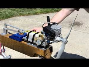

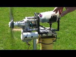

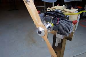

Here are some examples but you could just use a 4x4 post and some plywood or 2x4's. The PSP is a nice unit and you could easily adapt it for thrust measuring. I plan to build one for gassers to just see that they run ok. I always break new engines in on the plane as well. A stand is nice to have for just that....testing.
