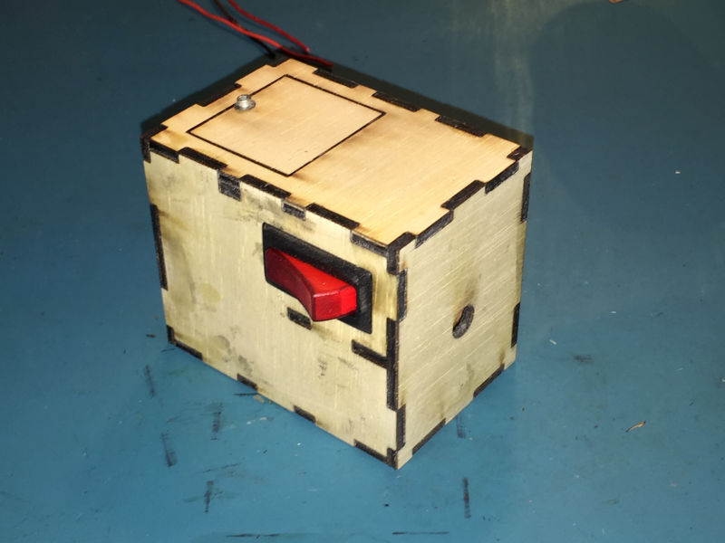

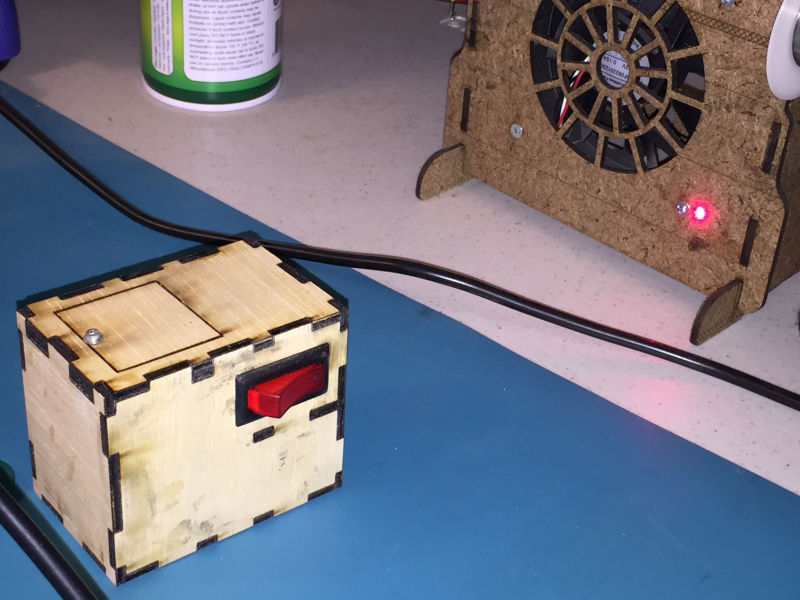

Well... I don't have one of those cool laser level tools... so... I made the poor mans laser marking tool thing...

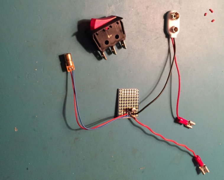

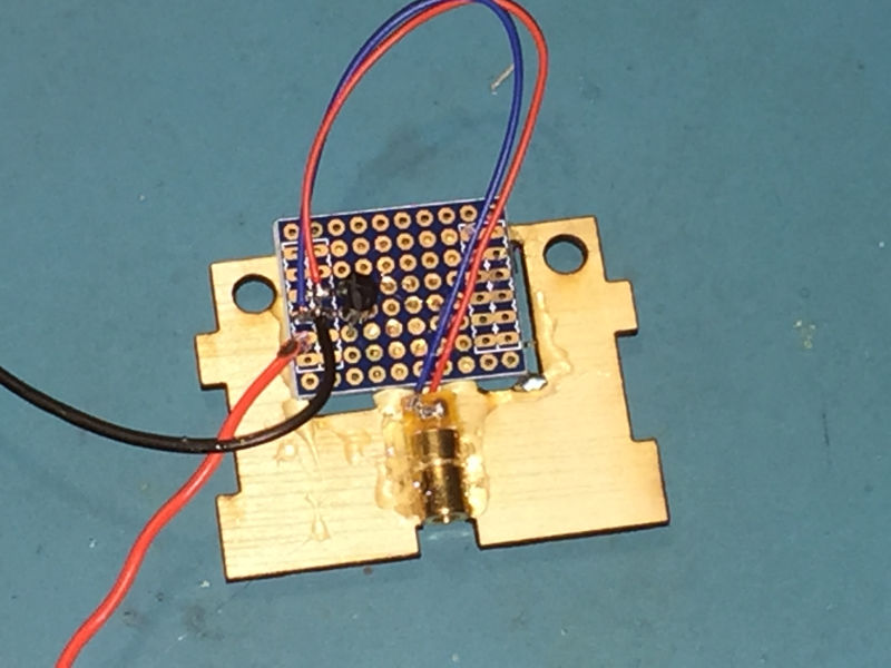

Probably don't have $5.00 in this. You can buy these little laser modules on ebay for next to nothing. A switch, 5V regulator and a battery... done !
http://www.ebay.com/itm/10pcs-650nm...020440?hash=item25aab8b058:g:upoAAOSw9N1VuKm1
And, just to finish it off in full Terry fashion... I glued the laser module in place with goop... !! :)
Not going to be very useful for much else, but it will work for marking spots on the cowl !!

Very cool! I actually thought of that idea some time ago but kept forgetting about it. Couple times I've used it works really well!
If your laser has a frequency adjustment you could lower the frequency and it would not burn as bad.
Thanks Terry... I'll play with it... but, I think my laser cartridge is simple old, and I'm having to run things too hot and slow... Need to replace it, but they are not cheap.
