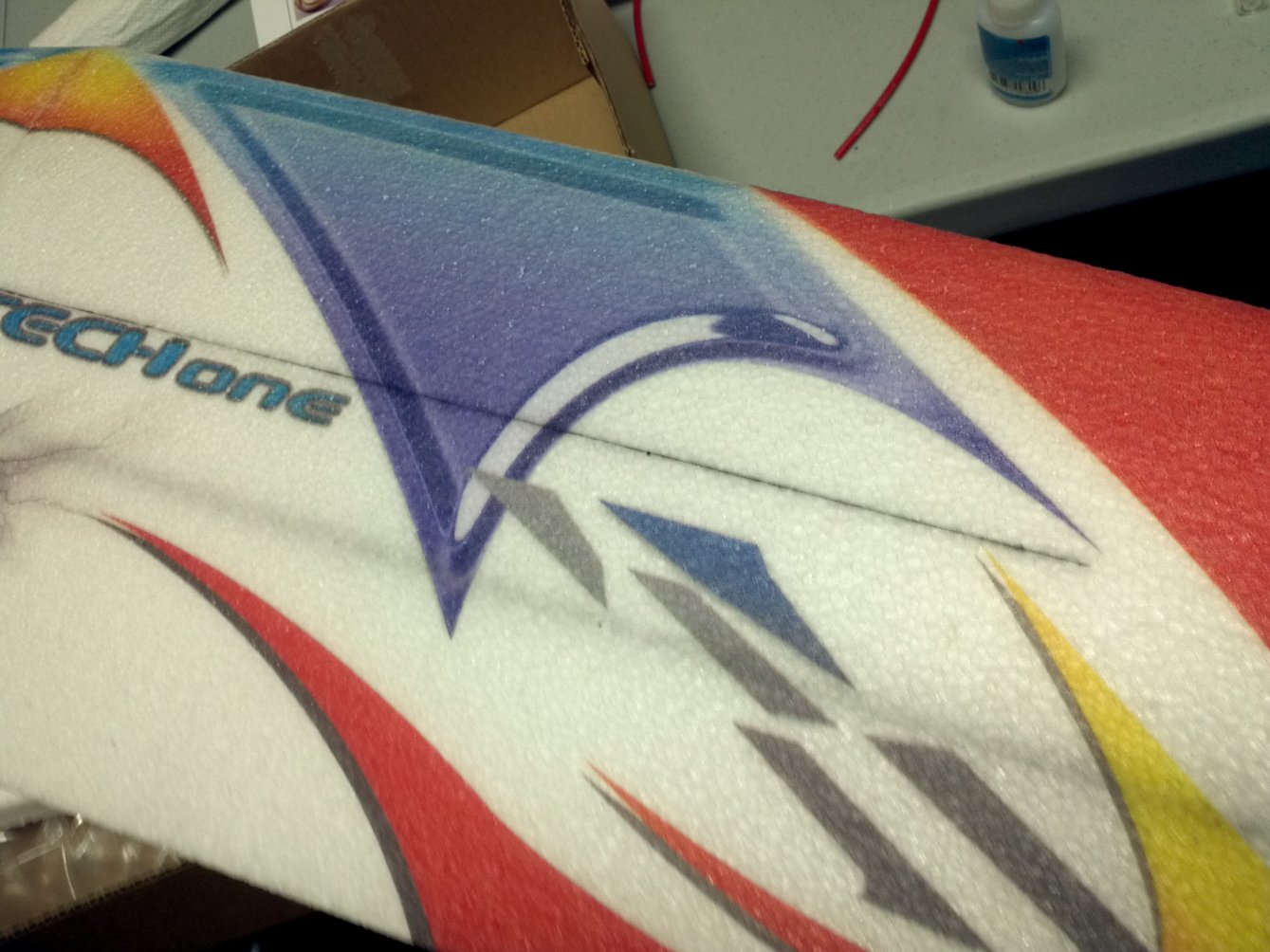

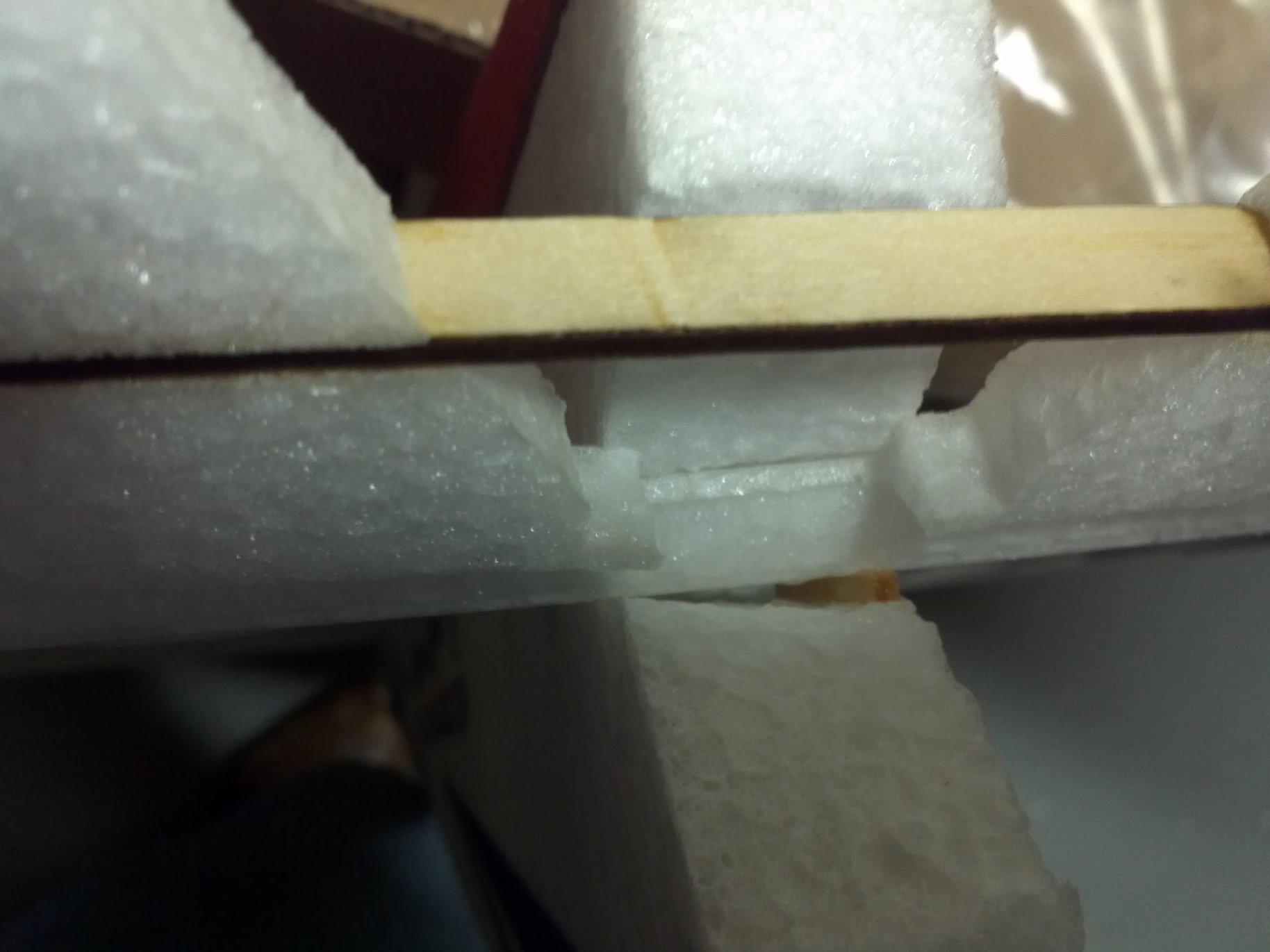

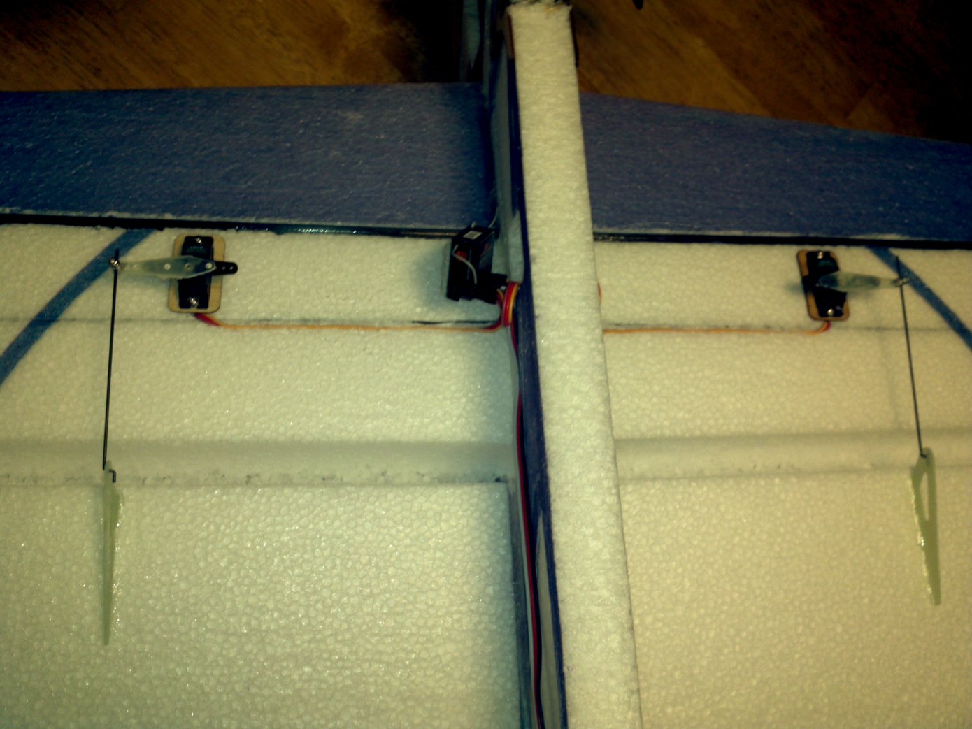

All-in-all this is a pretty impressive foamy for the price. The hinging is nice and moves freely and the same on each side. My only complaint (if you can call it that) was that they included some wimpy spars for the wing. If you watch some of the videos on youtube of this plane you will notice the wing flexing pretty good in some of them. My fix is that I took a much larger carbon rod and cut a groove to embed it into after glueing the two wing halves together with CA. The pics below show my new rod as well as the included small (think control rod size) rods glued in.

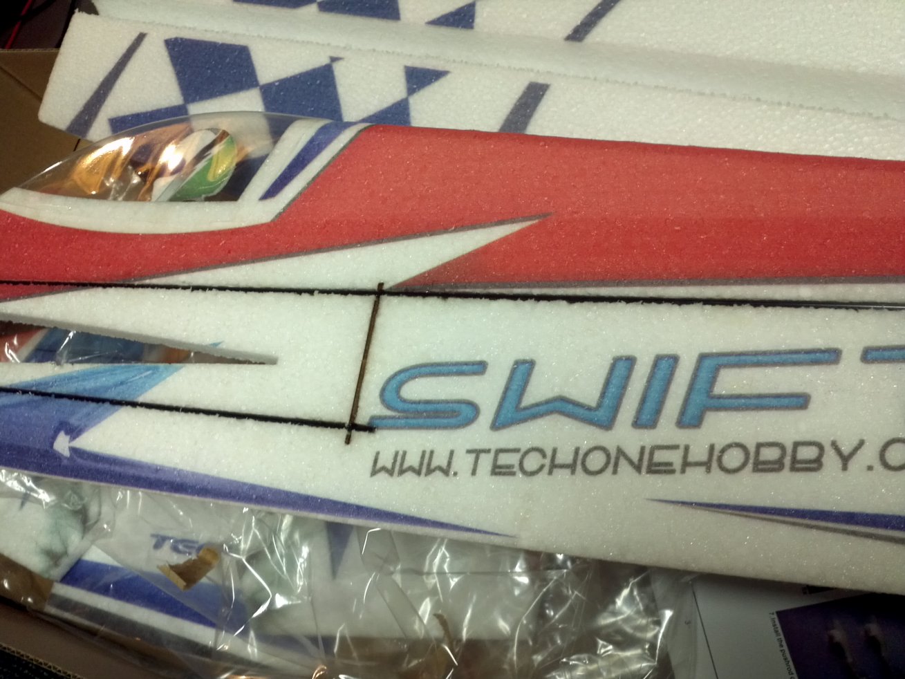

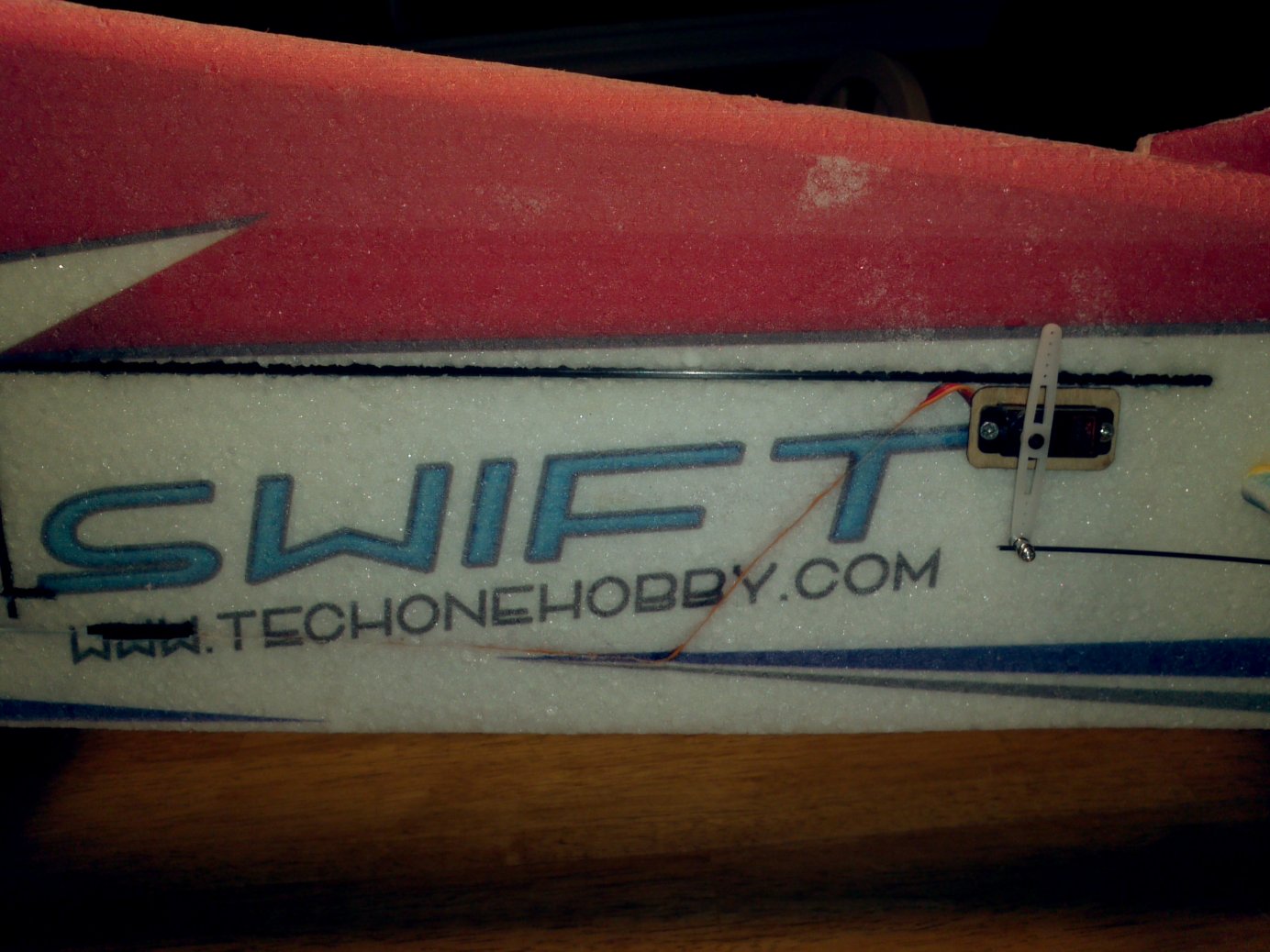

Here is a side view of the fuselage. You can see the nice carbon already installed that it came with. Fuselage seems pretty stiff so far and I don't think it should need additional rods of my own. I already had another use for the canopy glue I bought for the Toledo special as I used it here on the included cool little actual canopy they include for this foamy. (By the way, you can glue EPO and such pretty well with Canopy glue, something I would not have guessed. Also, it's nice in that overspill dries clear!)

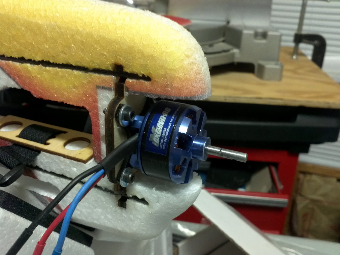

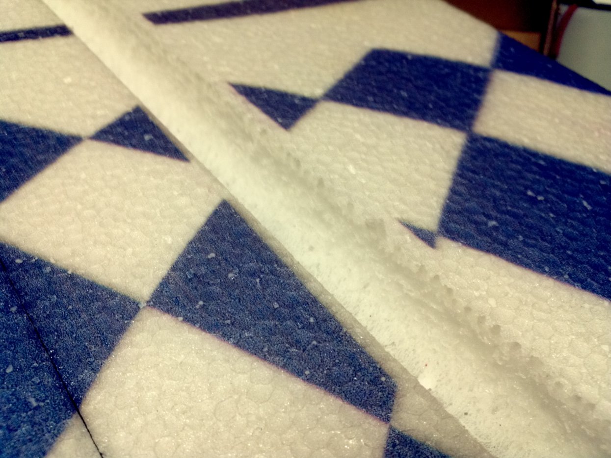

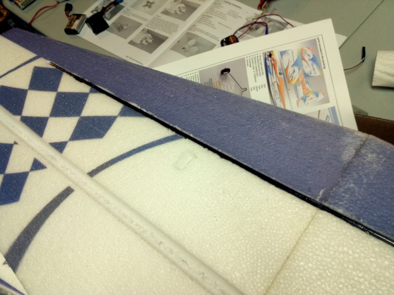

Oh yeah, one more thing. The grooves cut in the wing for the ailerons were a bit rough. It does not sand easily given it's pretty tough EPP but I was able to sand the rough edge of the groove off to make the ailerons extend fully. Not sure if this pic will be able to show the rough edge or not but anyways...
