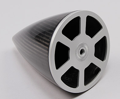

So I understand where you are coming from with the budget. When I was putting together gear for my 91" EF Extra a friend suggest these carbon fiber with aluminum backplate from Hobbyking. I am not a HK fan at all but I pulled the plug on the 4" for mine for $27.89. Hard to believe but I saw his and the quality looked good so I ordered one. I ended up selling it because I needed nose weight so I went with a Tru Turn with a solid backplate. The 5" are a little more at $44.82 so here is the link. http://www.hobbyking.com/hobbyking/...Alloy_Backplate.html?strSearch=carbon spinner

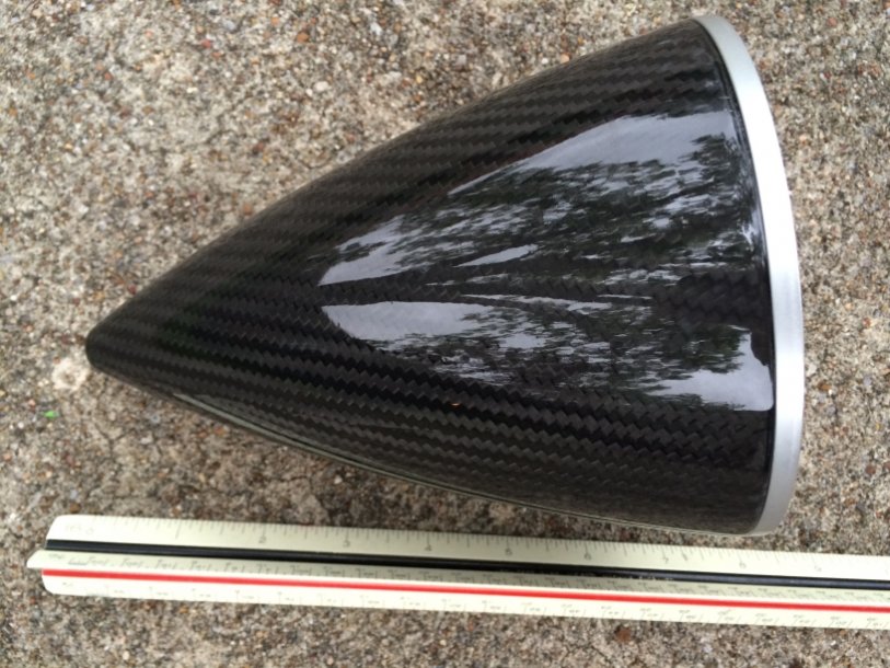

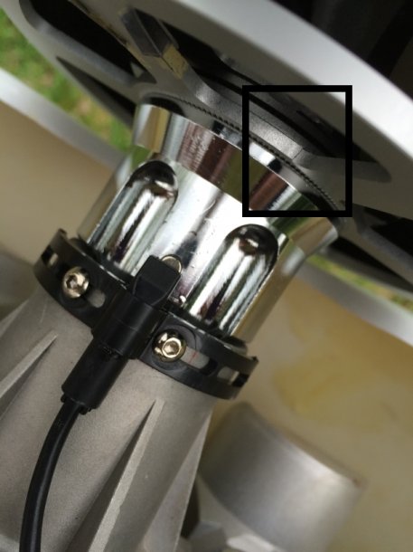

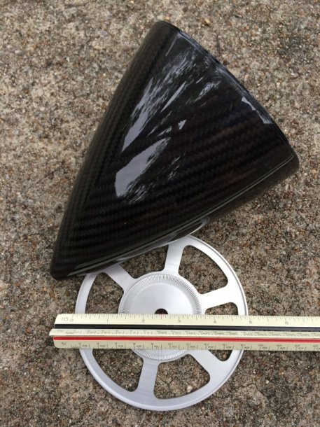

Here are a couple of pics of the HK 5" CF Spinner with the aluminum backplate. I have this on hand for my EF Extra 300 should I try a 3-blade prop at some point in the future. For the money they seem to be a decent quality spinner. One thing, the aluminum back plate is cast and could be prone to developing crack(s) where the spokes meet the hub. I had a 4.5" on my Extra 300 that cracked after 3 gallons. I'm still using the CF cone but with a different aluminum back plate.
If I use the 5" spinner I will order a Tru-Turn aluminum back plate to have on hand in case the stock HK one starts to develop cracks.

It is convenient to use a single bolt spinner, but they easily develop cracks on the aluminum back plate, since you have to tighten the cone against the back plate to prevent slipping.
CF back plates have other documented potential issues.
On a powerful gas engine prone to vibrations, I would not use a single bolt spinner with a lightened back plate.
