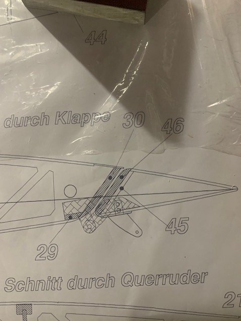

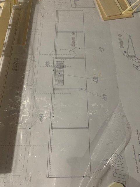

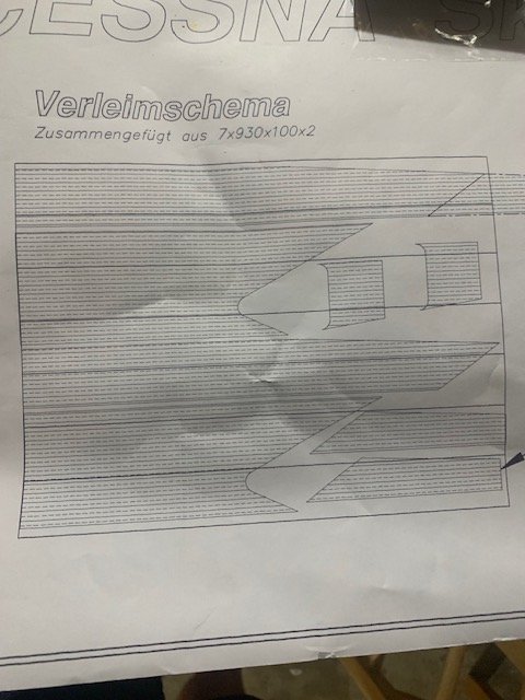

I've had this kit for several years and I'm attemping to build it. The fuselage is all fiberglass and the other parts are build out of wood. I have watched others build kit planes, but never tried it myself. I am confused on how to build sheet the plane wing, and building the flaps. The instructions are in German and I used google translate to translate them. I think some words are lost or something during translation. The plans show the sheeting pattern for the wing. Do I need to cut the sheeting as shown on the plans? The plans are very confusing to me, as I lack experience in building.

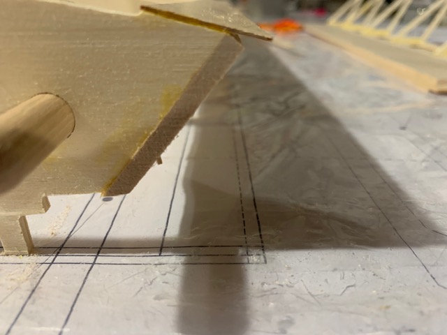

I found a mistake in the top trim for the flap. The wood under the trim did not touch the trim. The plans show it flush with the trim. What should I do?

I am happy to find an online description of how I do wing sheeting. Let me look around or I will write it up if I can’t find anything.

Can you describe the problem more?
The part that over hangs the rib is flush with the rib but not the balsa part below. The bottom part was supposed to be touching the over hanging part too. Part 30 on the plan picture. Not sure if I could fill the under it or it will be ok?
