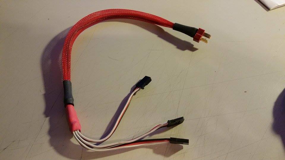

I make up pigtails like this for my 30cc and bigger for my Futaba recievers. Two J-Plugs for 30cc-70cc, Three for 100cc+.
