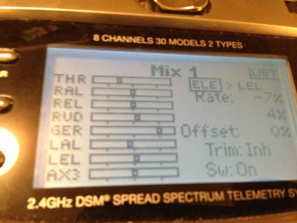

  2. Gazza do you run separate channels for elevator eg L elev ch7 R elev into elev on your reciever?
  3. gyro
    gyro GSN Contributor
    7,806
    129
    63
    Texas
    Not unless I have separate servos back there. On my 89 and 106 I do, so yes.
    But, that won't affect how you program the ke mixing
  4. I have 2 servos up the back on the funtana and yak and I can't get the ke mixing working right can you post a screen shot of your ke mixing for dual elevator when you get the chance?

    Sure, be about an hour or so

    This mix was put in by Mike Wargo because for some reason the end point adjust didn't work right on one side. The plane flies well so I haven't messed with it. It's not specific for KE though, more to make the elevators move correctly together.

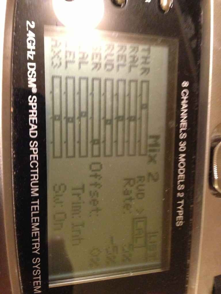

    This is rudder to aileron:
    Don't have any in right now, (will be working on this over the weekend) but this is how I setup the elevator mix for KE: rud to lel, and rud to rel
    Put the same value in both.
    Hope this helps
