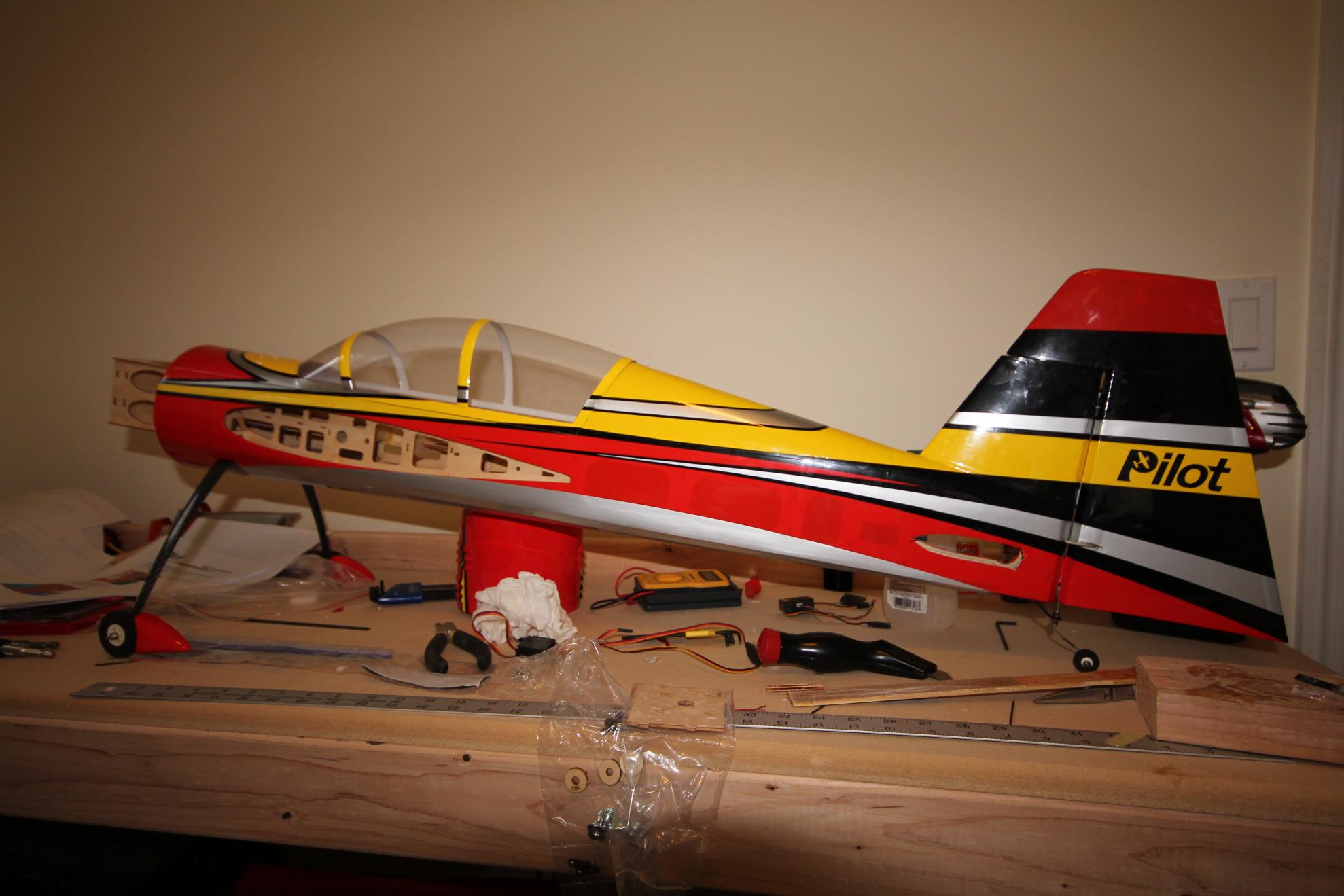

As some of you know, I recently got one of these beauties and I'm currently working on the build. It's going really well so far and the quality of the airframe seems excellent. I will post a more thorough build thread/review soon.
Here she is on my workbench:

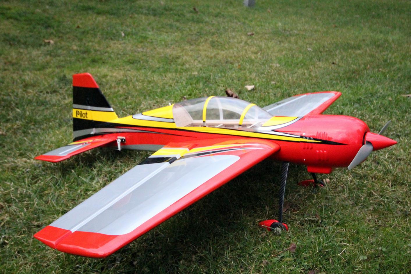

I just finished my build! Now all I need is sub 15mph winds, above 40F temps and no rain or snow to take her for a spin.
Here's what I ended up putting in it:
* HURC FirePower 46 Sport (720kv/1000W)
* ZTW A-series 70A
* Hitec HS-5085MG all around
Should be pretty nice, I think. I'll get back with more info as soon as I've had her for a spin!
