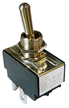

    Not sure what I'm going to do. Was thinking about a dual pole aircraft grade toggle switch in a little compartment with a cover held on by magnets. Something like the 12-200 will switch both batteries at once for $7.50
    https://www.aircraftspruce.com/catalog/elpages/metlevswitch.php
