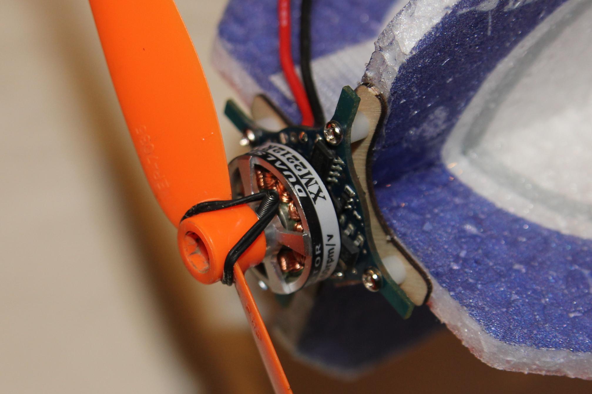

    There are two versions of the kit. One comes with airframe only and the other has power system and servos included. We strongly recommend getting the power system combo, as it can be a bit challenging finding the right motor and ESC for a plane this size.

    • DualSky XM2212RTR-25 Motor/ESC

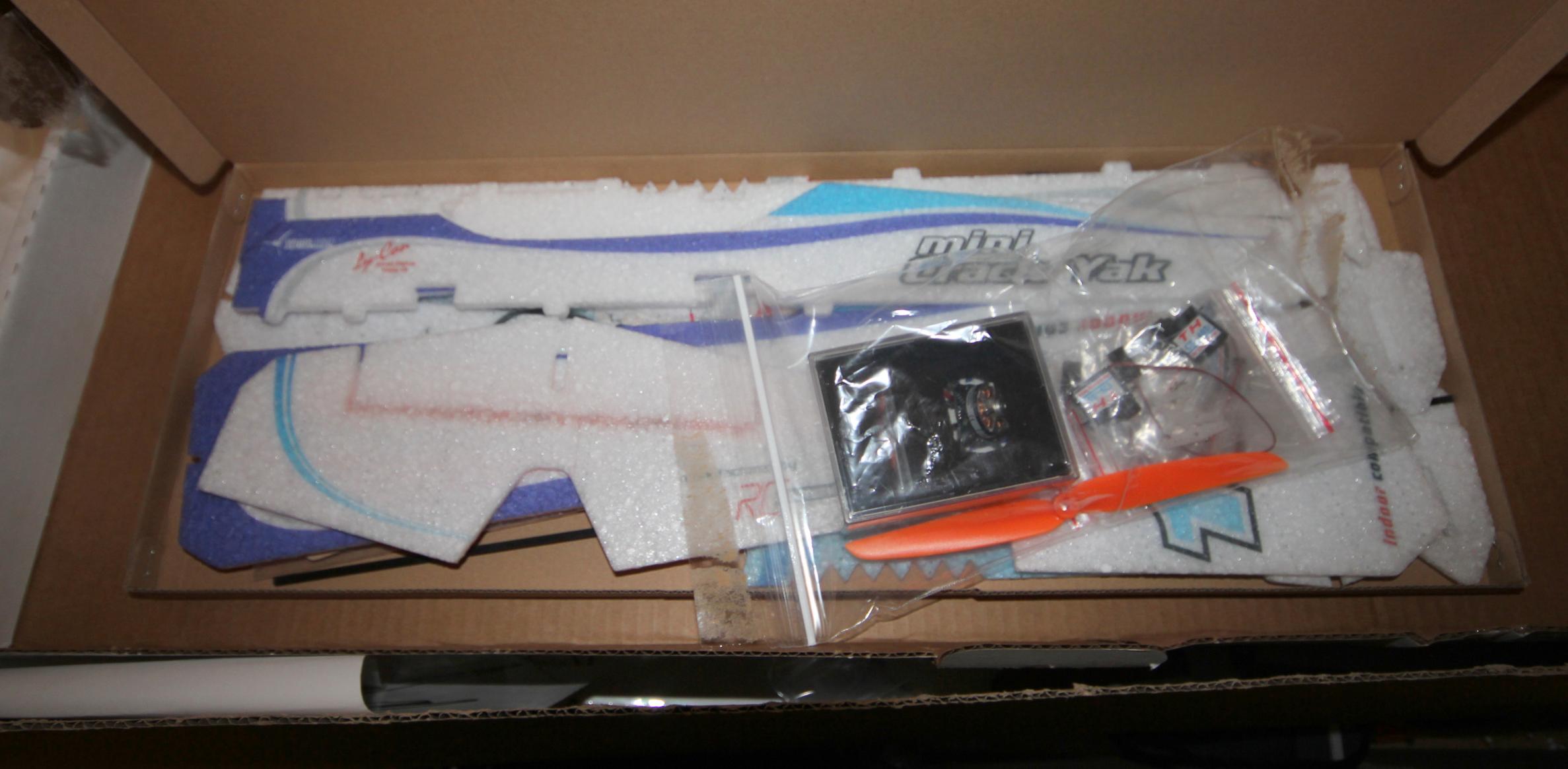

    [h=1]Unboxing[/h]
    Good things come in small packages and the Crack Yak Mini is no exception. The plane arrived neatly packaged in a small flat package containing laser cut foam pieces, a sheet of laser cut plywood parts and assorted hardware. One thing we noticed right away is the generous use of carbon fiber parts. Our kit also came with three 4g servos and a DualSky motor/ESC combo.

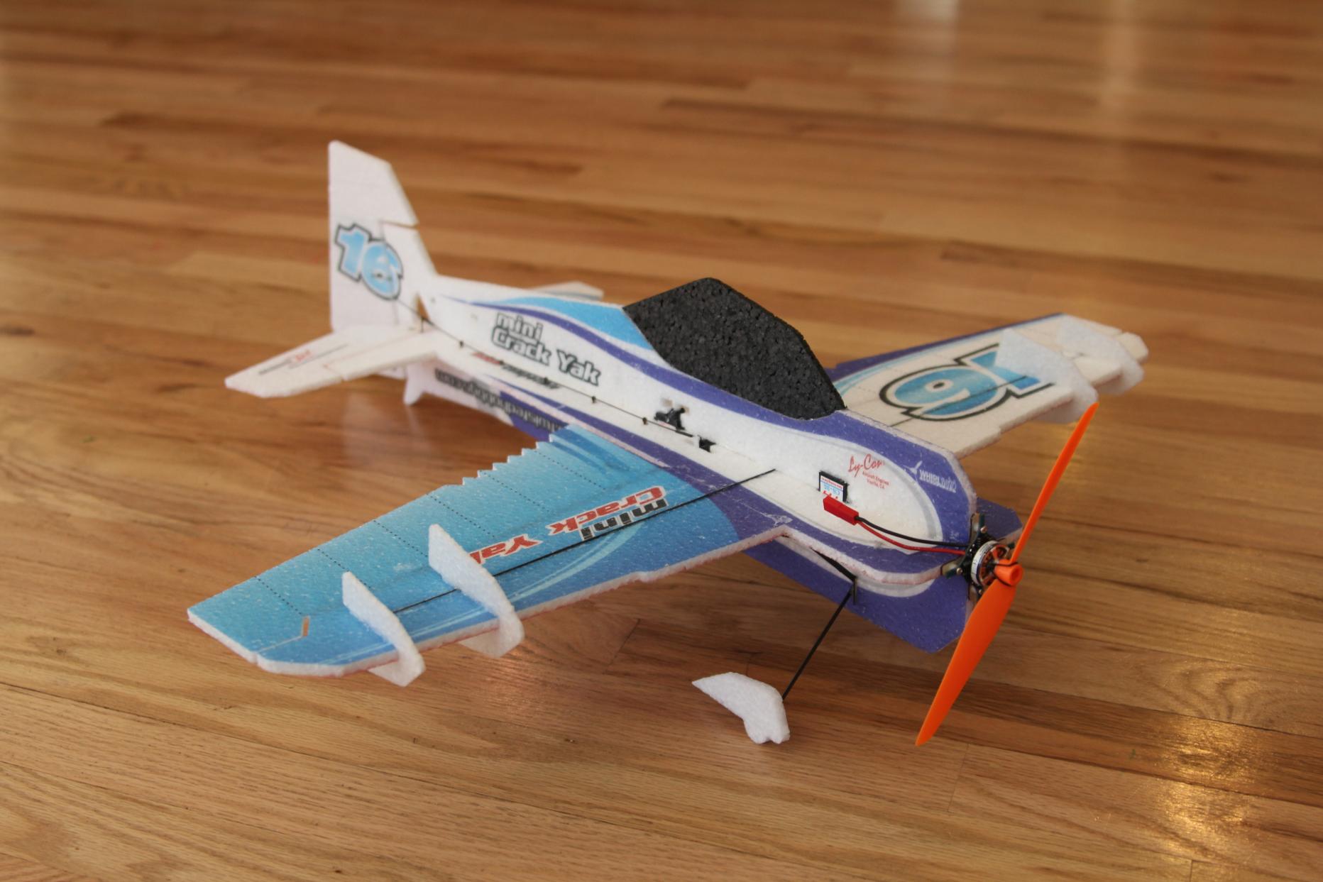

    [h=1]Flying[/h]
    We tested the model with 180mAh 2s batteries. This is a very light battery and we found we needed to push the battery almost all the way to the nose to make the plane balance. A slightly larger battery is probably easier to balance and should help with flight times too. We are planning to retest the plane with 260-300mAh batteries.
    Unfortunately we didn't have access to an indoor venue for our maiden, but we got the second best thing: An absolutely calm afternoon!
    The first thing we noticed was how highly maneuverable the plane is. Rudder response is awesome and in a harrier the plane almost turns on a dime if you give full rudder and lightly bump the throttle. The same thing is true of the elevator response. Walls, waterfalls and parachutes are spectacular if timed correctly.
    As you've come to expect from a plane from TwistedHobbys, the knife edge performance is flawless, virtually free of coupling and requires very little rudder input. KE-loops requires some roll correction, but are probably as easy as they're ever going to get in any plane.
    Post-stall is plain beautiful without even a hint of wing rock at any alpha and the stall transition is unnoticeable.
    Initially we had some issues holding a steady hover, but we soon realized that this plane wants a generous amount of expo, especially on the rudder. The reason for this is the strong and direct rudder response and we found that manuevers requiring precision, such as the hover, worked best if the controls were "tamed" a bit using expo.
