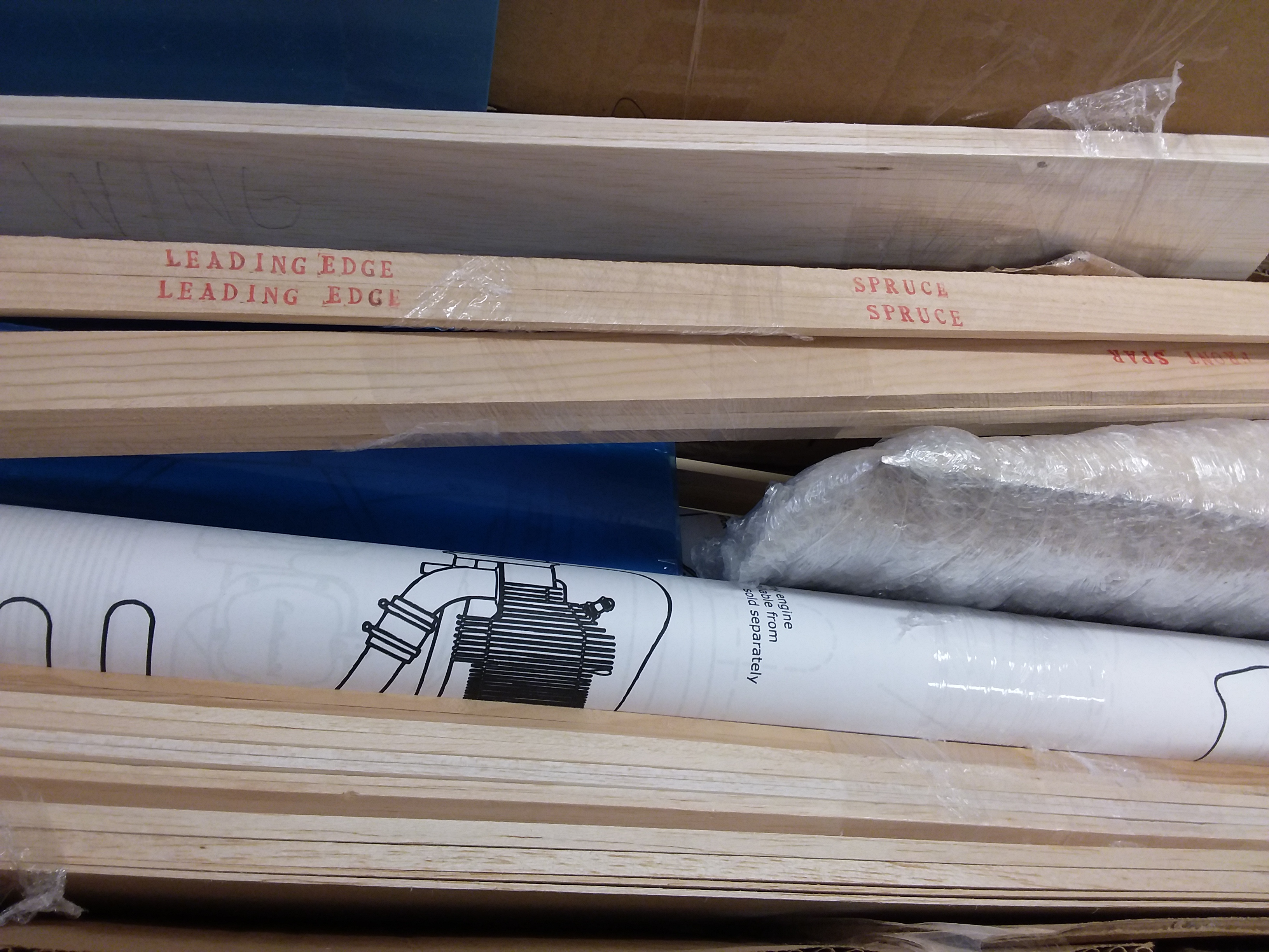

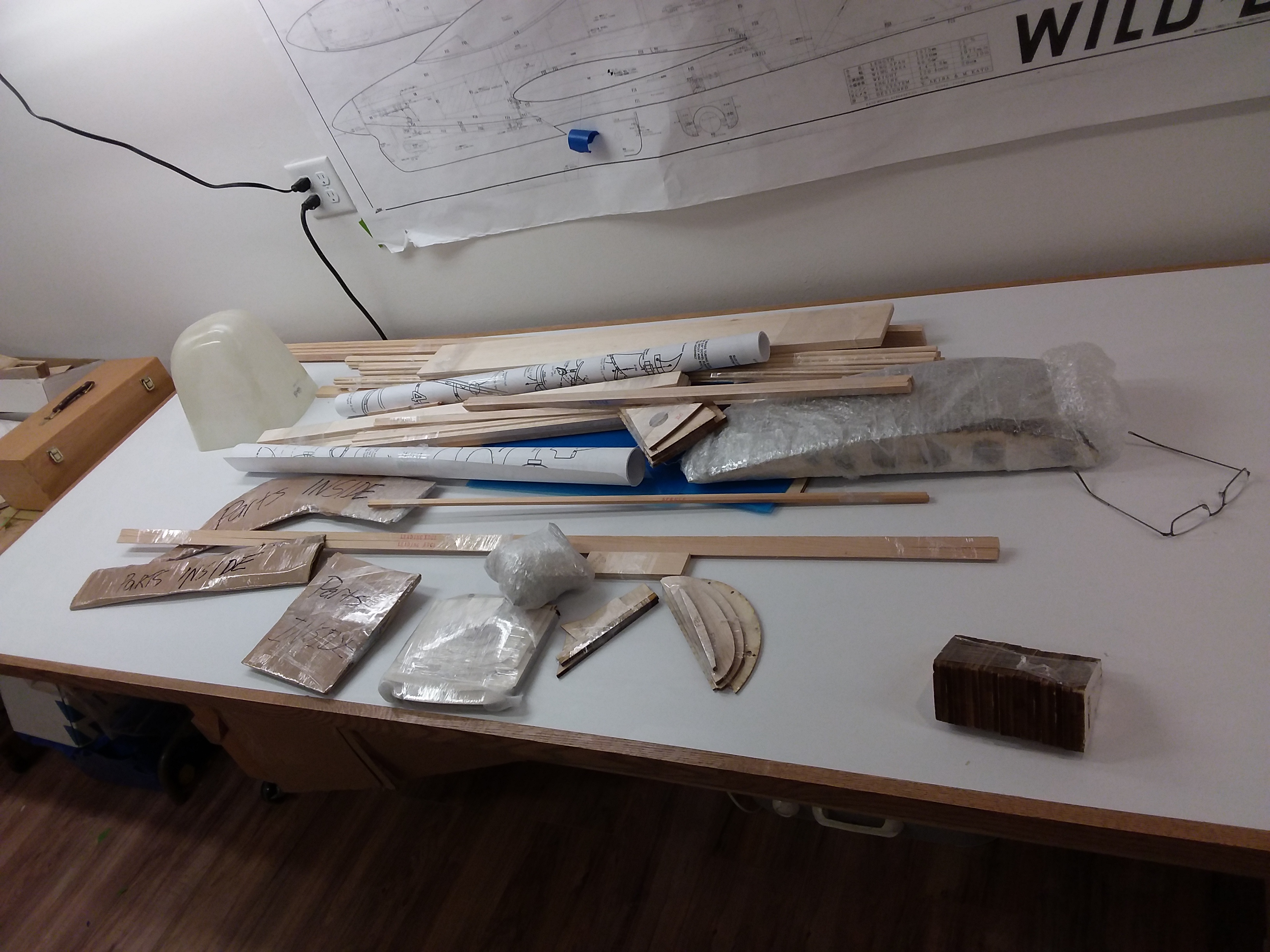

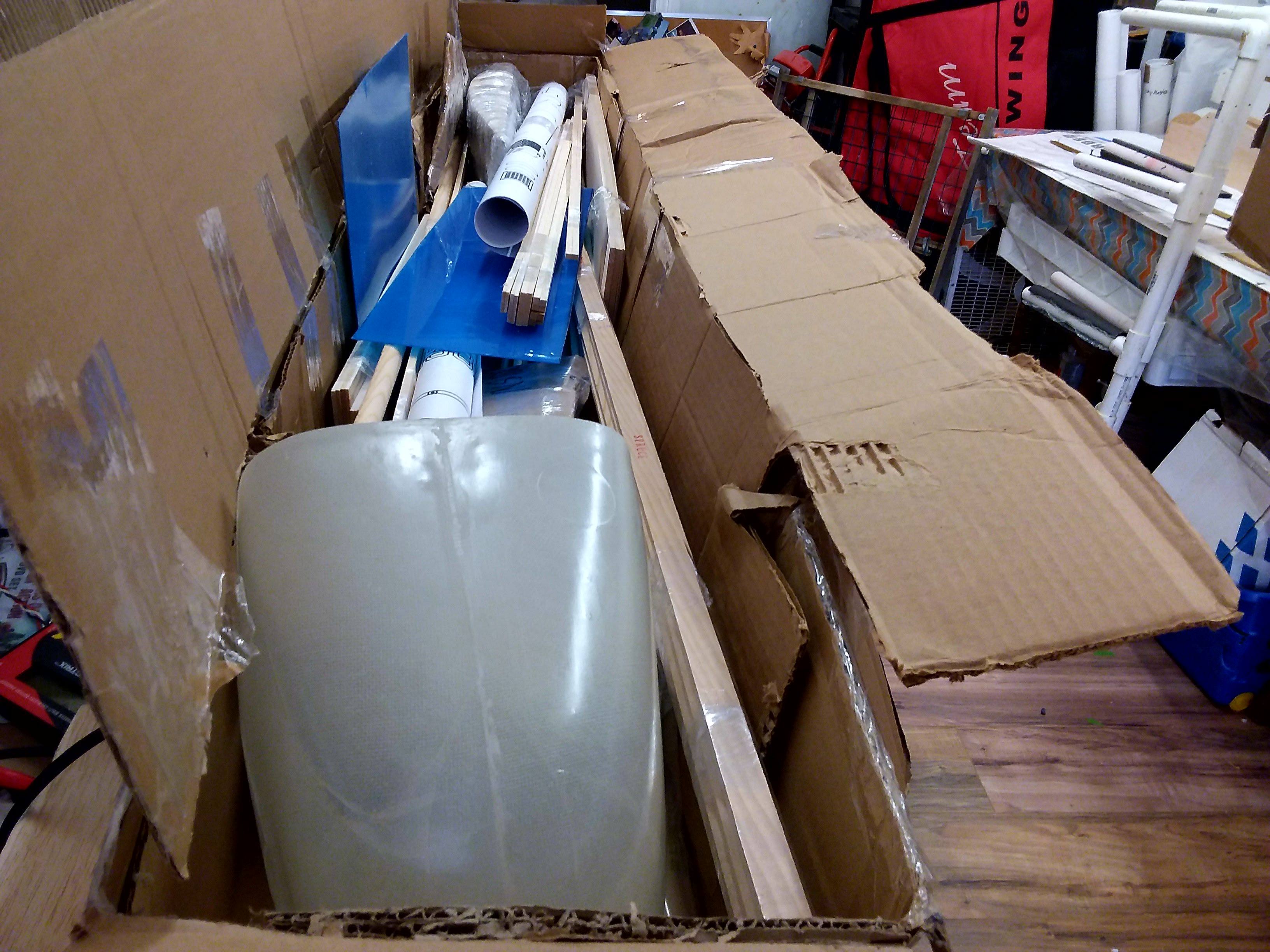

    I have bought a Nelitz 1/3 scale Cub kit from Don at Rcaiir.com. Don primarily sells classic pattern plane kits (I have bought a few of those) but he sells a few giant scale kits as well. Looks to be a nice kit. Very smooth laser cutting.

    Some more photos of the kit.

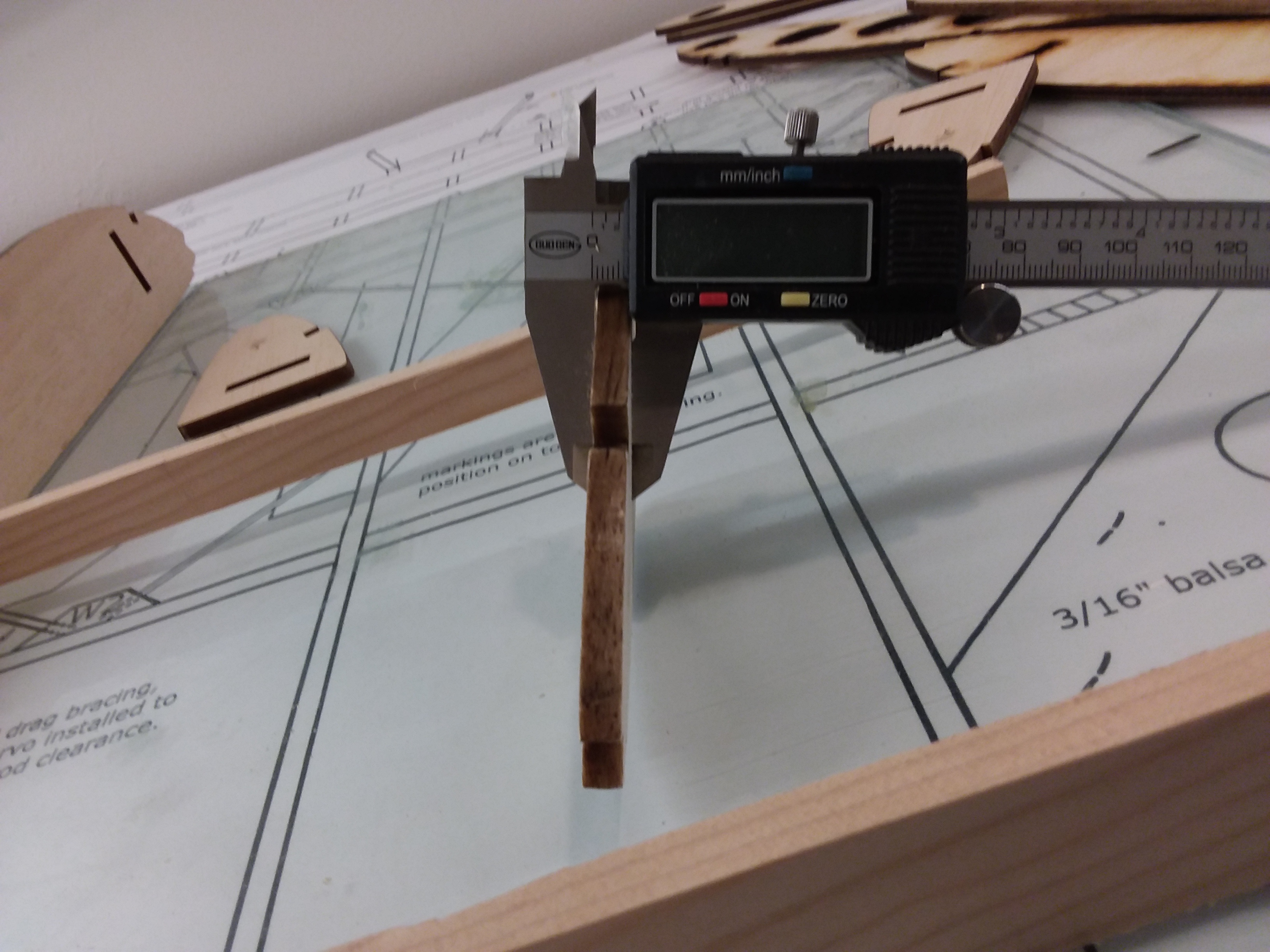

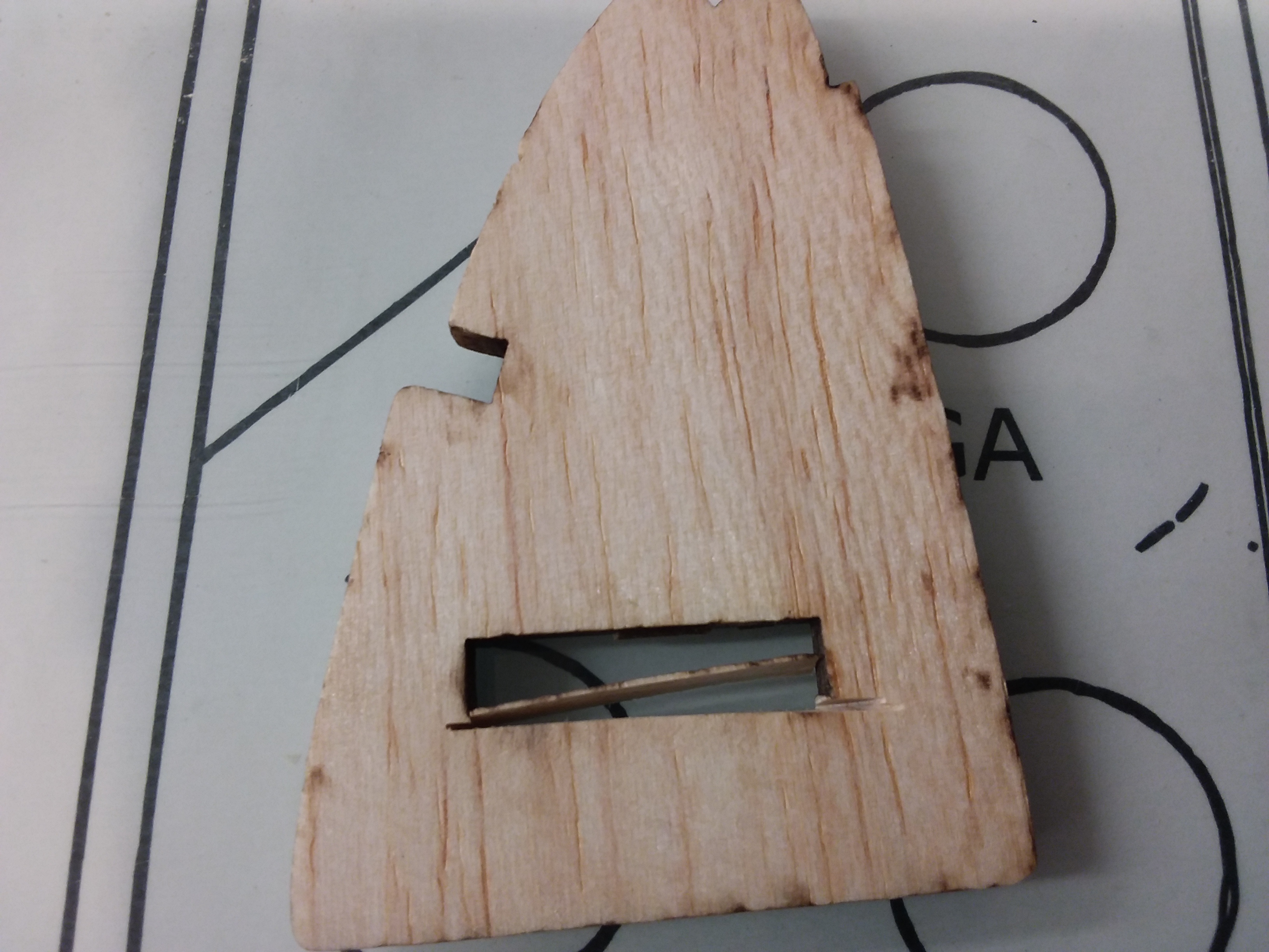

  7. dhal22
    dhal22 GSN Sponsor Tier 1
    A little issue pops up. Main spar is 5/16" but rib slot is 1/4".

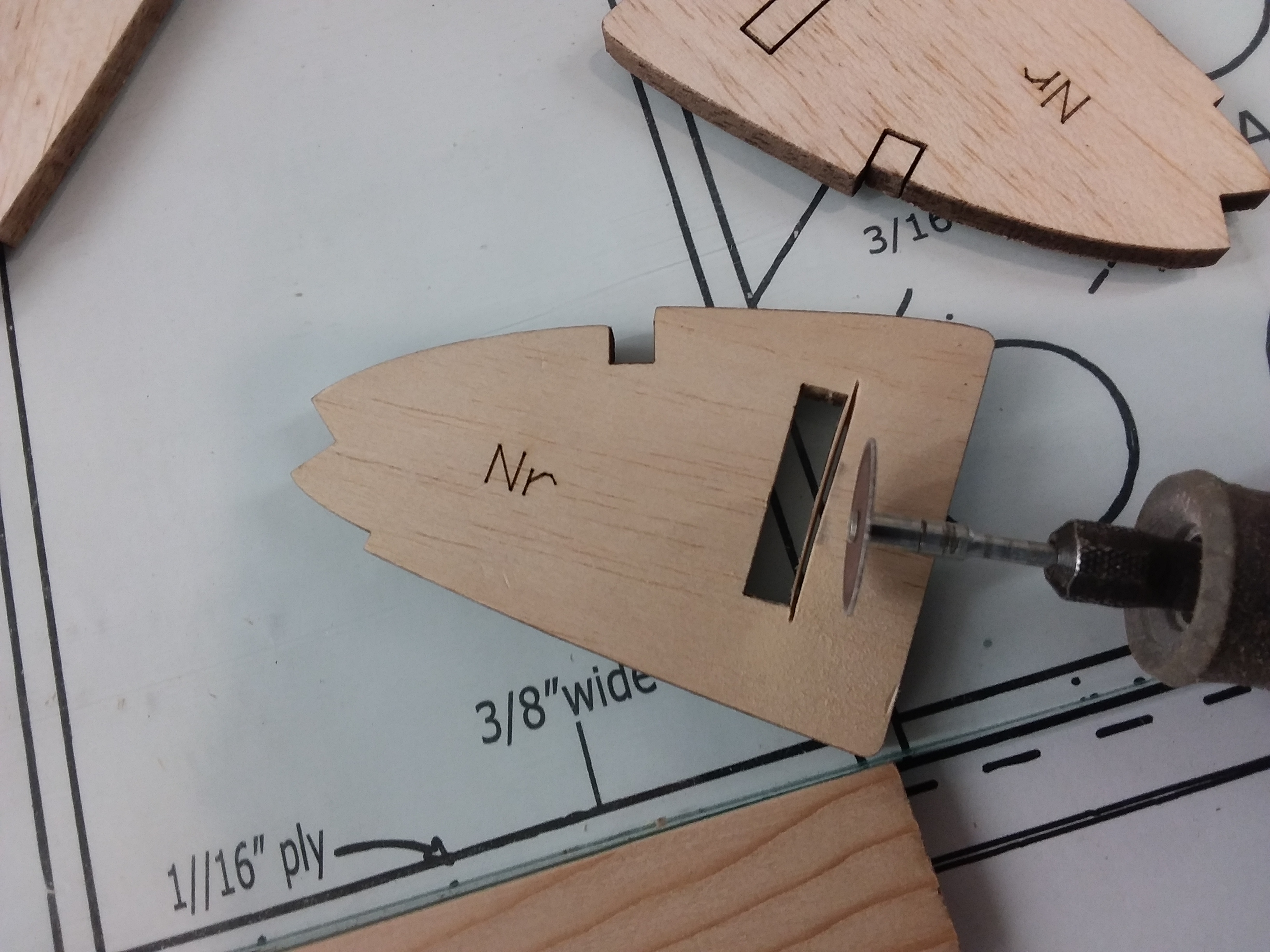

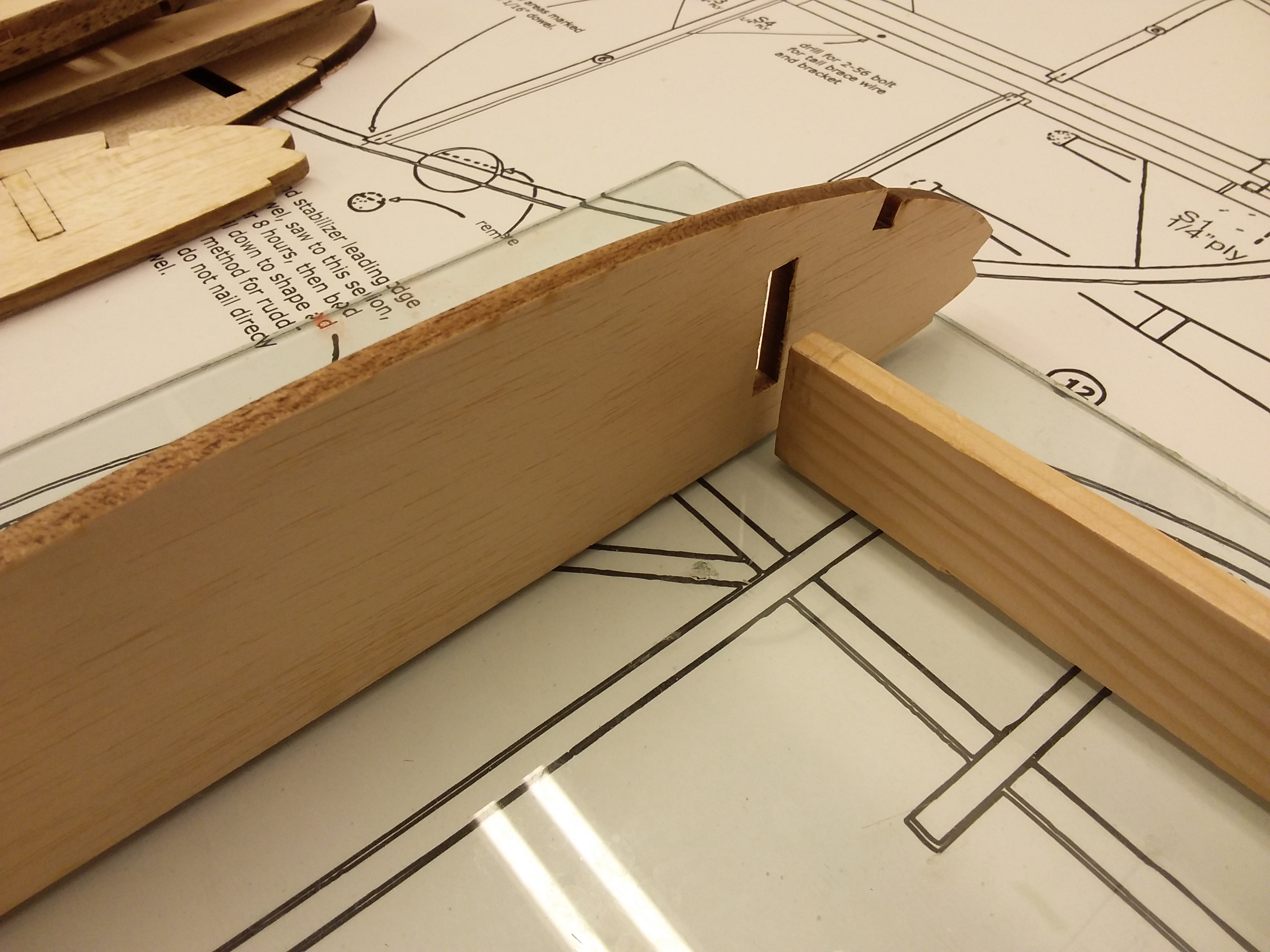

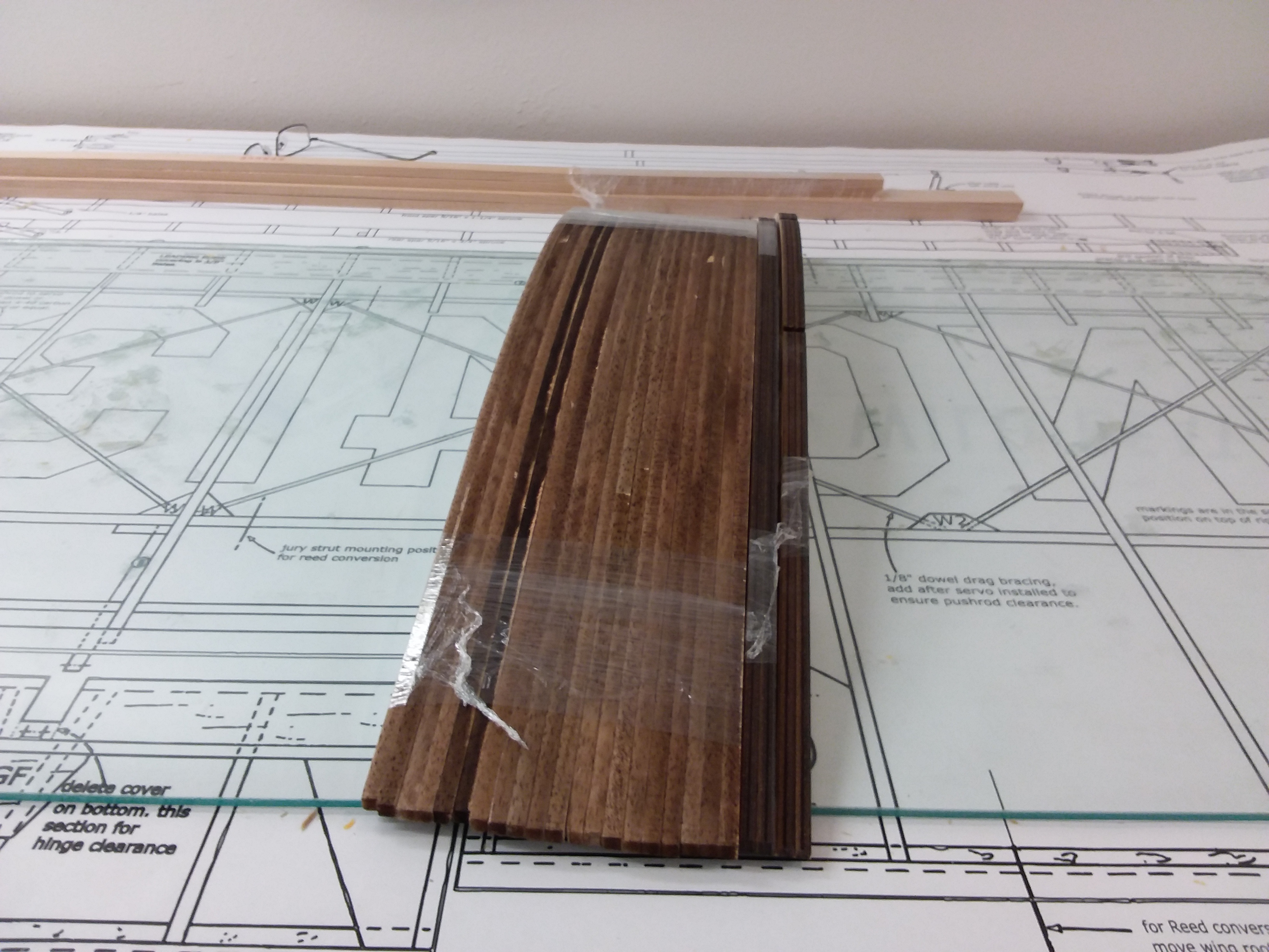

  8. dhal22
    Pretty easy cut with a Dremel. Except I have about 40 cuts.

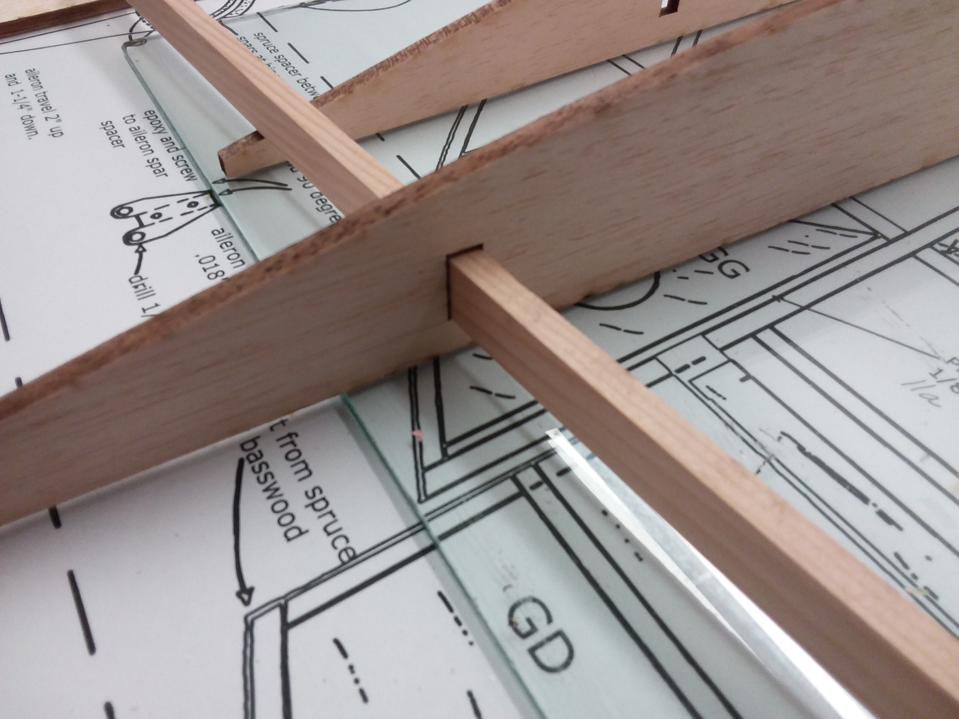

  9. dhal22

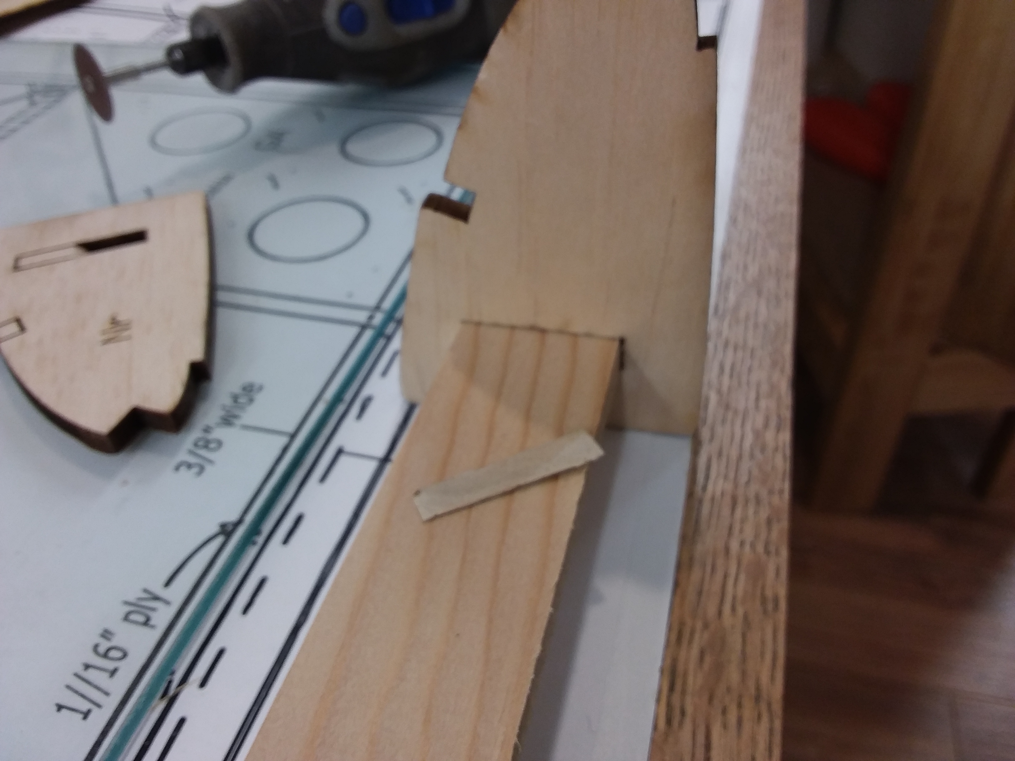

    Rear spar fits fine.

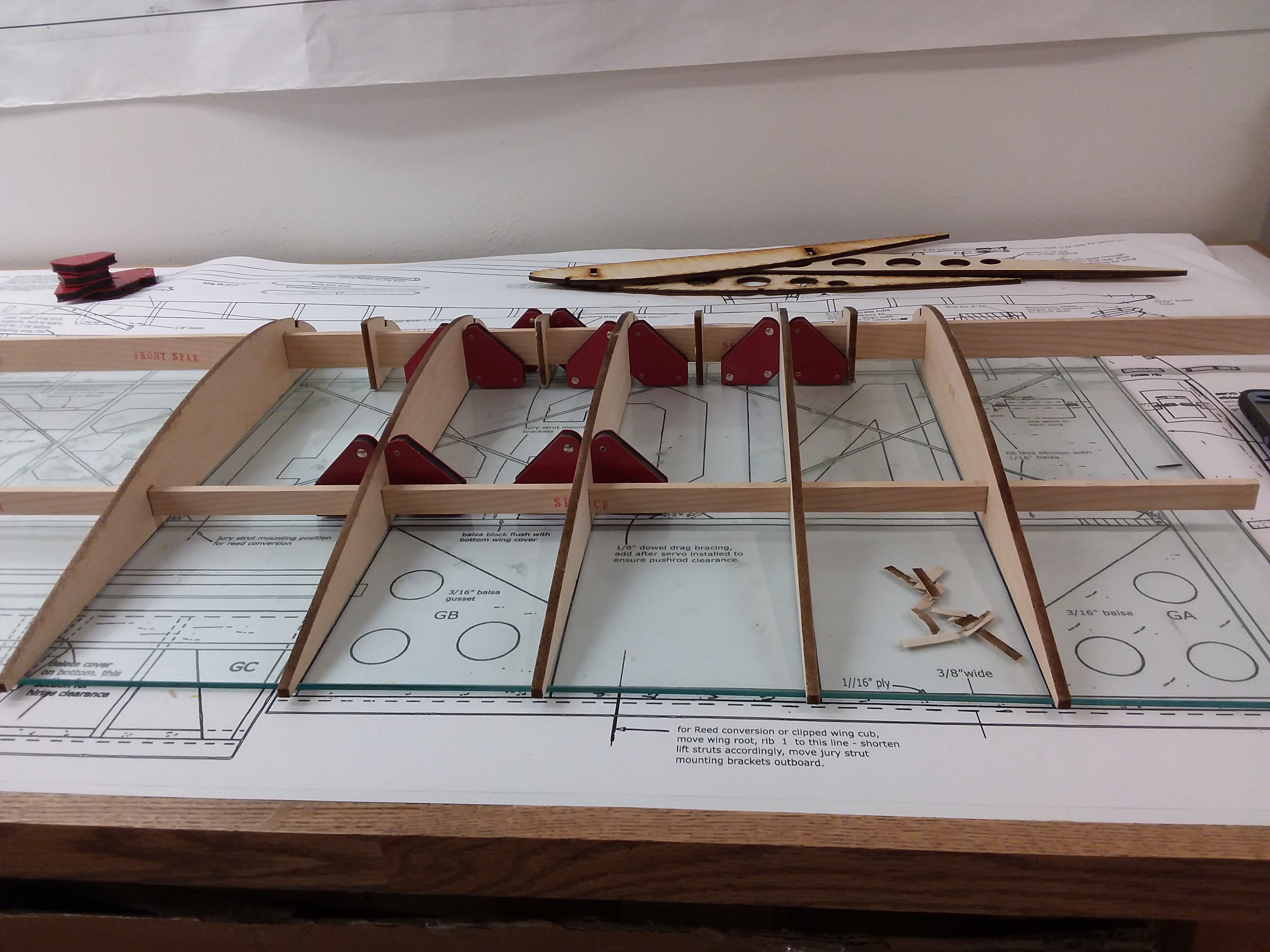

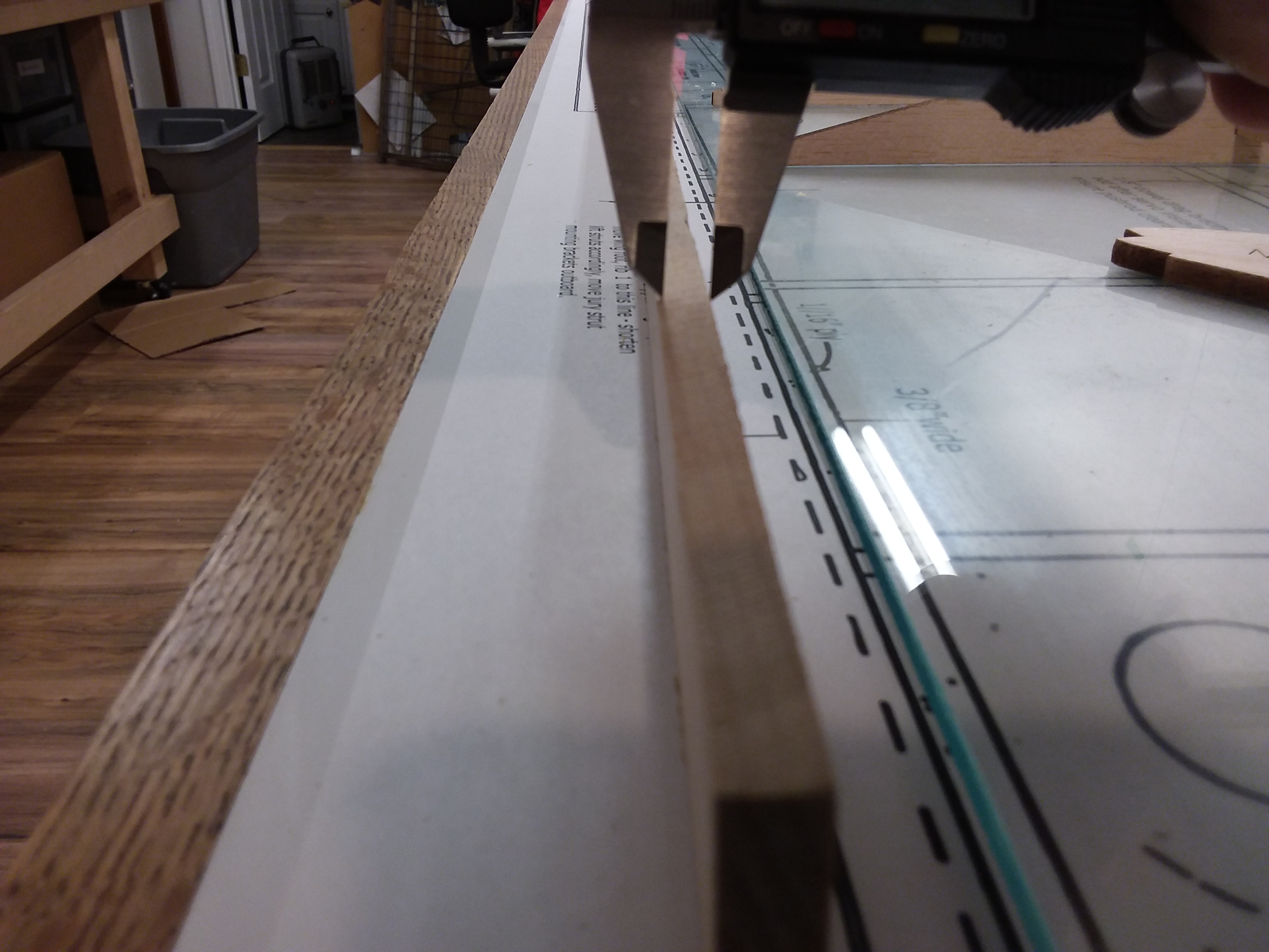

  10. dhal22
    Building on glass, I will get a bigger piece before I start gluing.
