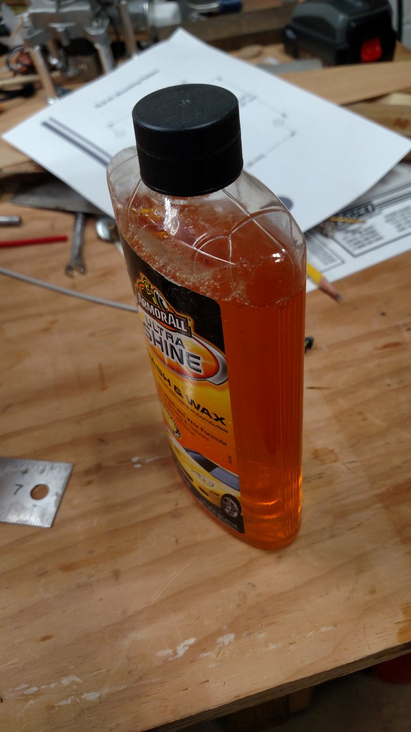

    Just figured I'd look around to see what I've got on the shelf and found this! Woohoo! 16oz and fits perfect!
    But, for the heck of it, how would I make a fiberglass tank if I wanted to?

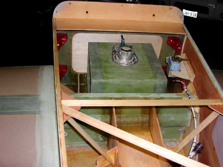

  8. Here is a fiberglass fuel tank, I made many when I was still building home builts, but this one was in my R/C Staudacher. 096.jpg
    Alpha20, Jetpainter and Bartman like this.

  10. Bartman
    Bartman Defender of the Noob!
    Thanks for that! What was the trick to keeping it sealed? Epoxy type/brand? Or will any good quality epoxy like West Systems do the trick??
