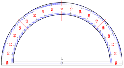

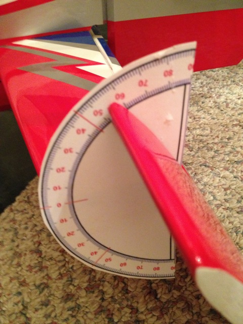

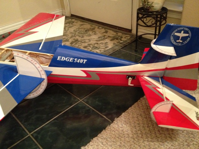

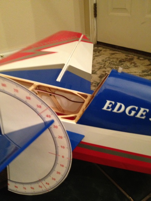

I saw something someone posted and I lost the link so I cannot give proper credit to them (sorry) for this. Very simple and costs basically nothing. Below is a file for a protractor that has been re-done to be used for RC. I brought this into Adobe Illustrator to have better control of the dimensions but with fiddling around in a graphics program you can scale this to suit your needed sizes. Anyway size one for each surface to read close to the numbers for the width of the control surface at the gap line. I spray mounted this printed paper to some folder stock to make it stiffer and I cut the protractor on that line close to the 90º dimensions. A little double stick tape on the back and place it in the gap against the fixed part of the plane and align the centerline and the "0" position to the control surface and you have a nice and easy way to set your surfaces. I will run this tomorrow and double check this with the throw meter. If you are on a budget or find this easier than what you are doing now have at it.
If someone knows who originally posted this protractor please let me know so I can give them credit here please.
