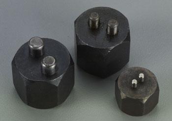

I have used these before with great success...... highwb011.jpg But this is would be cool....Cant find any info on it yet......

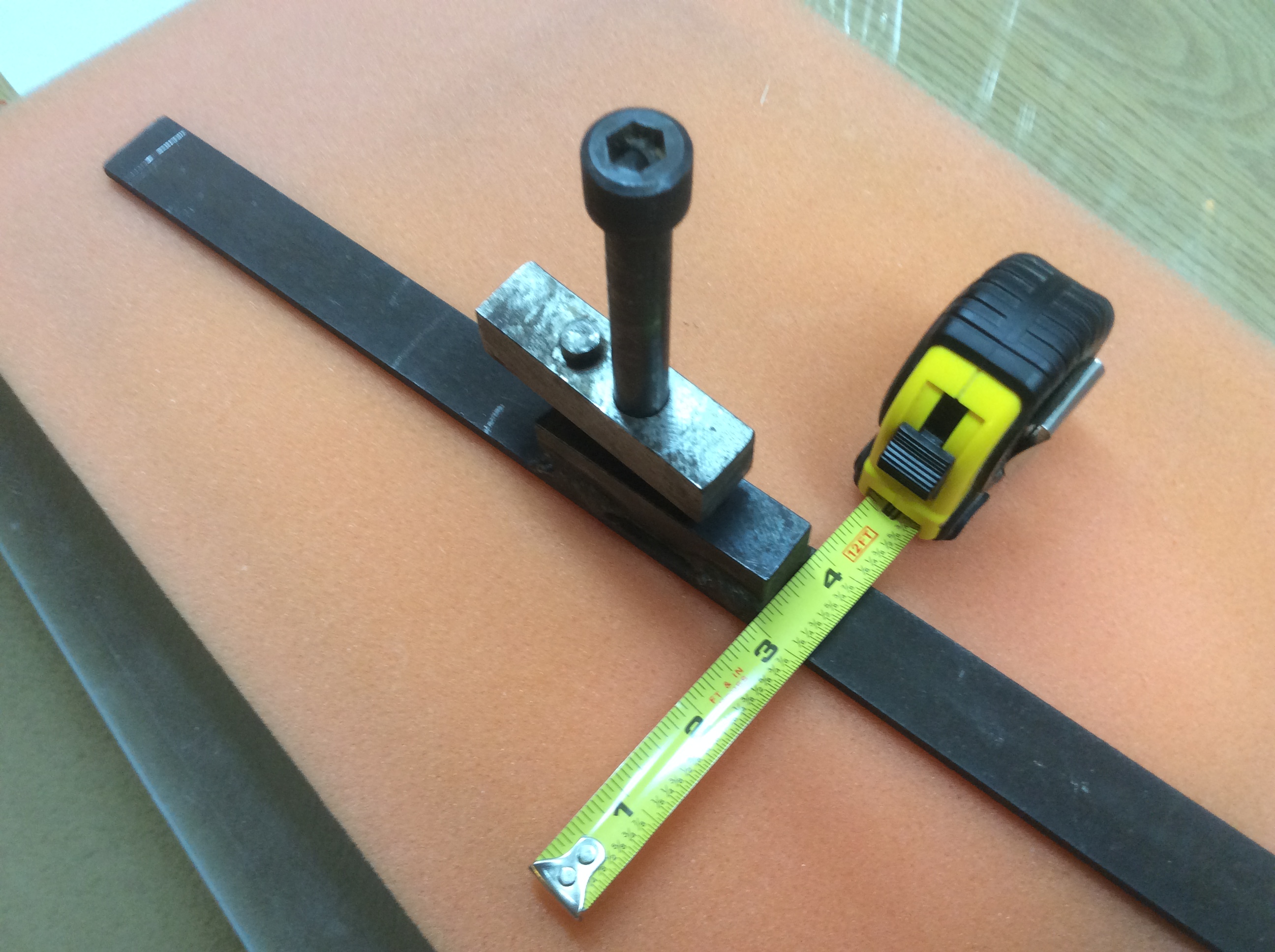

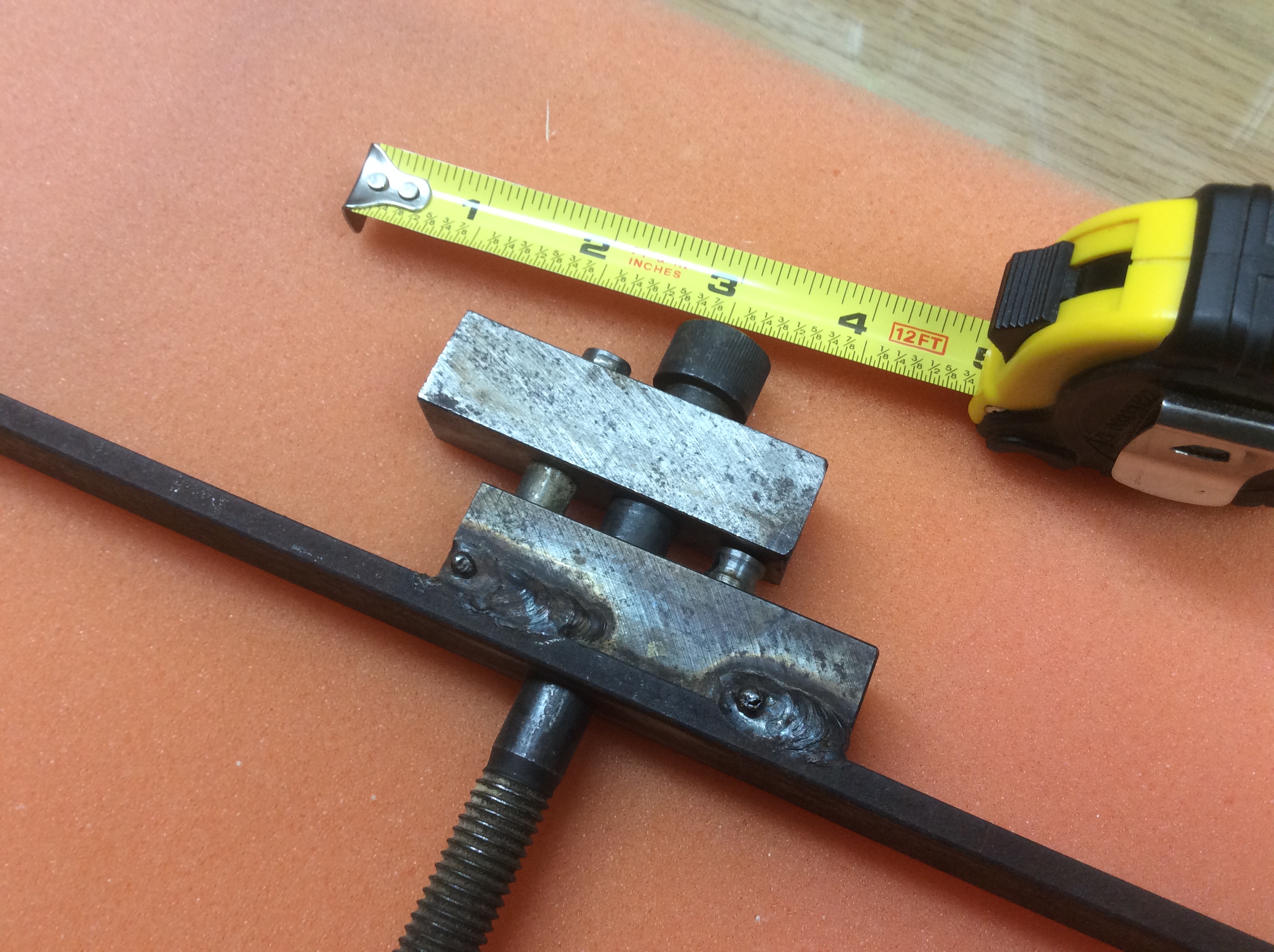

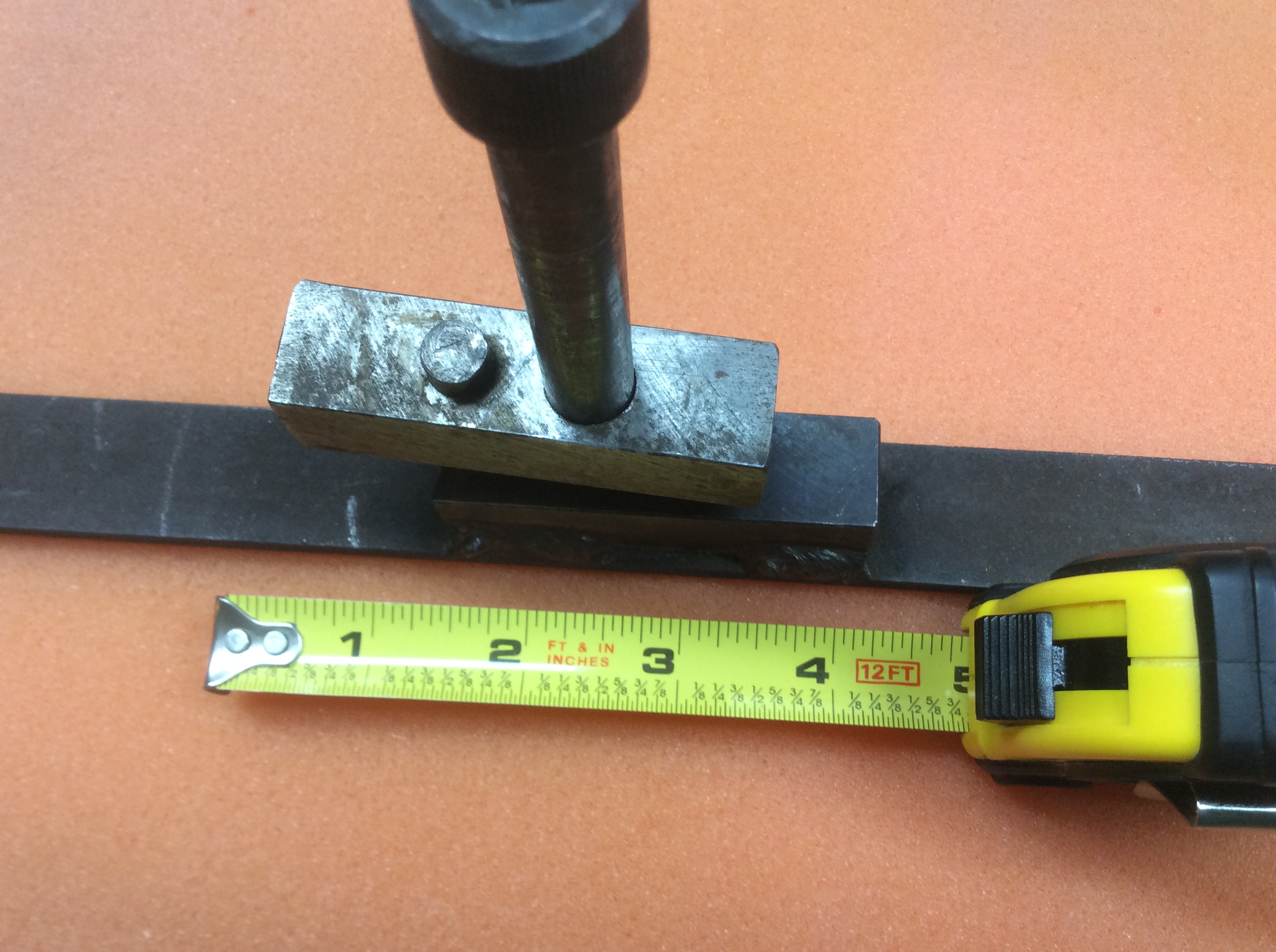

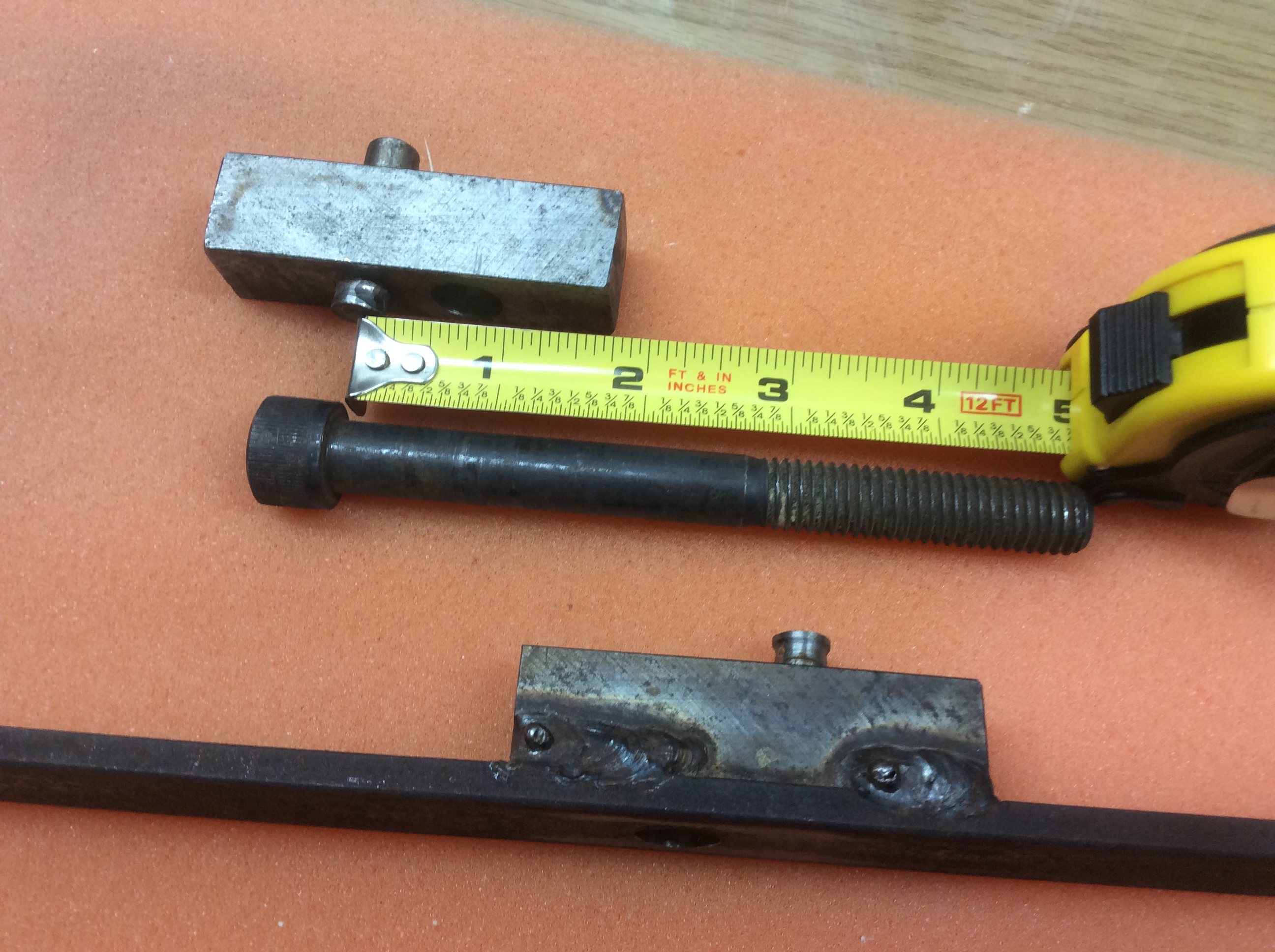

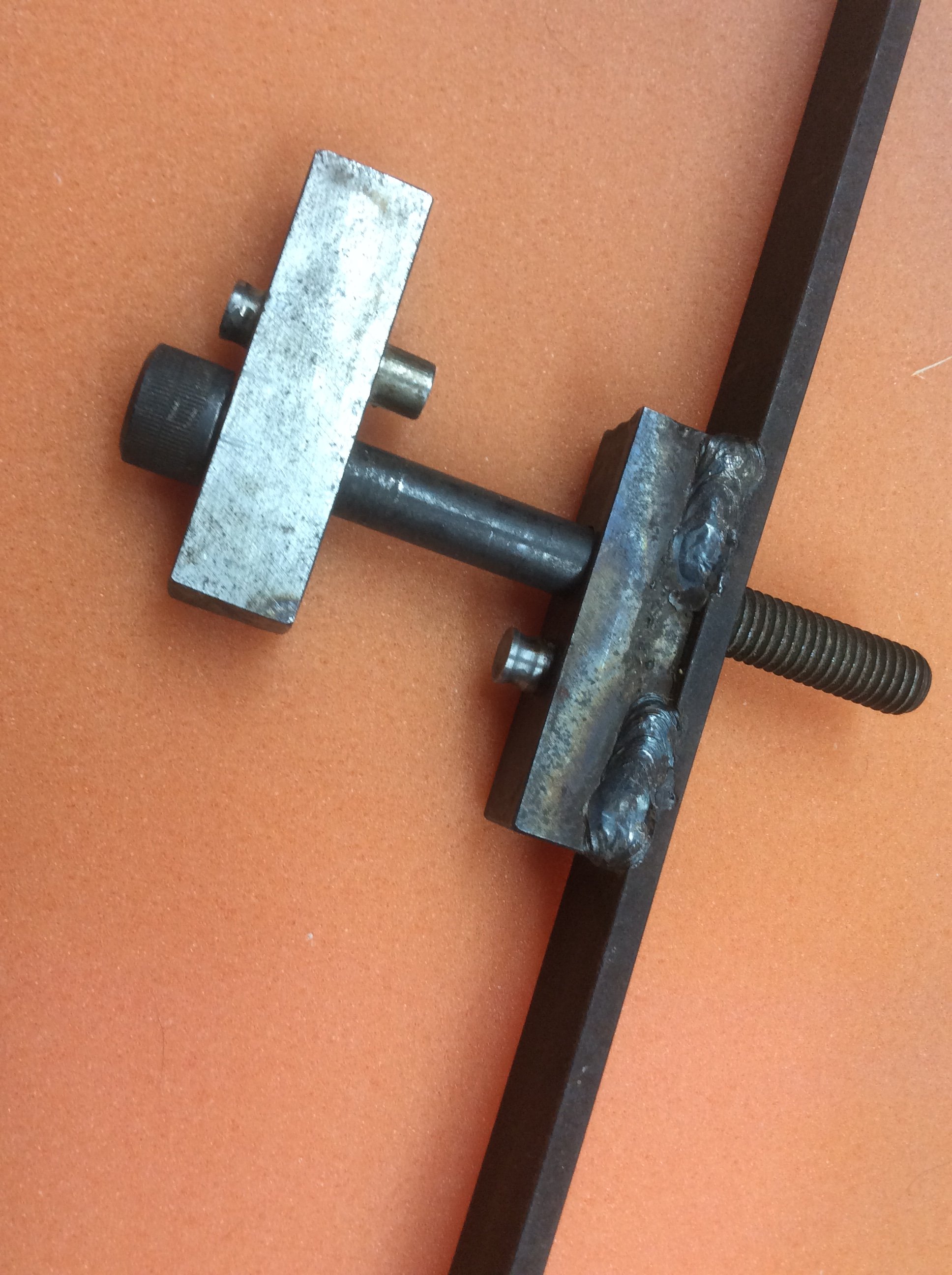

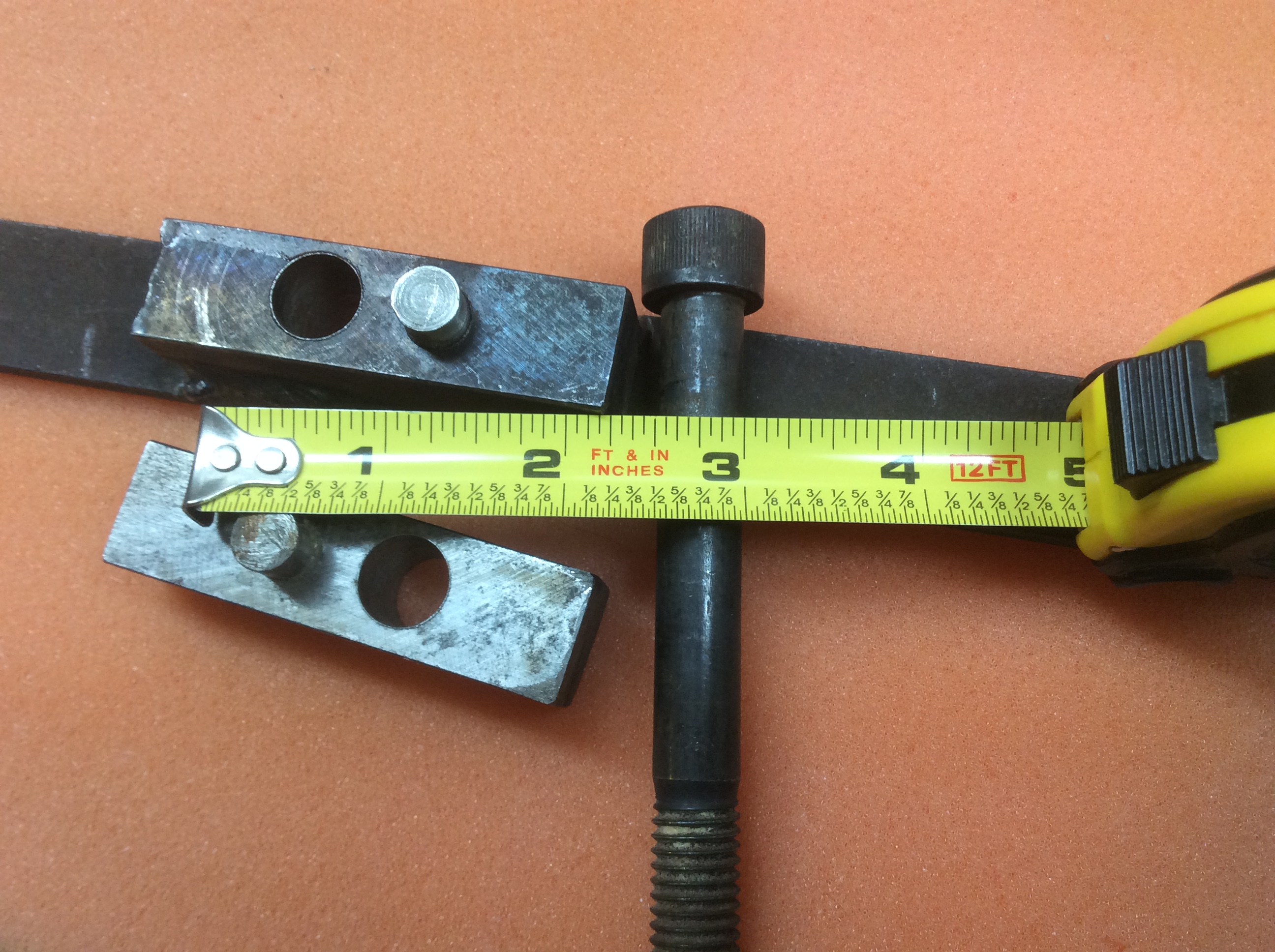

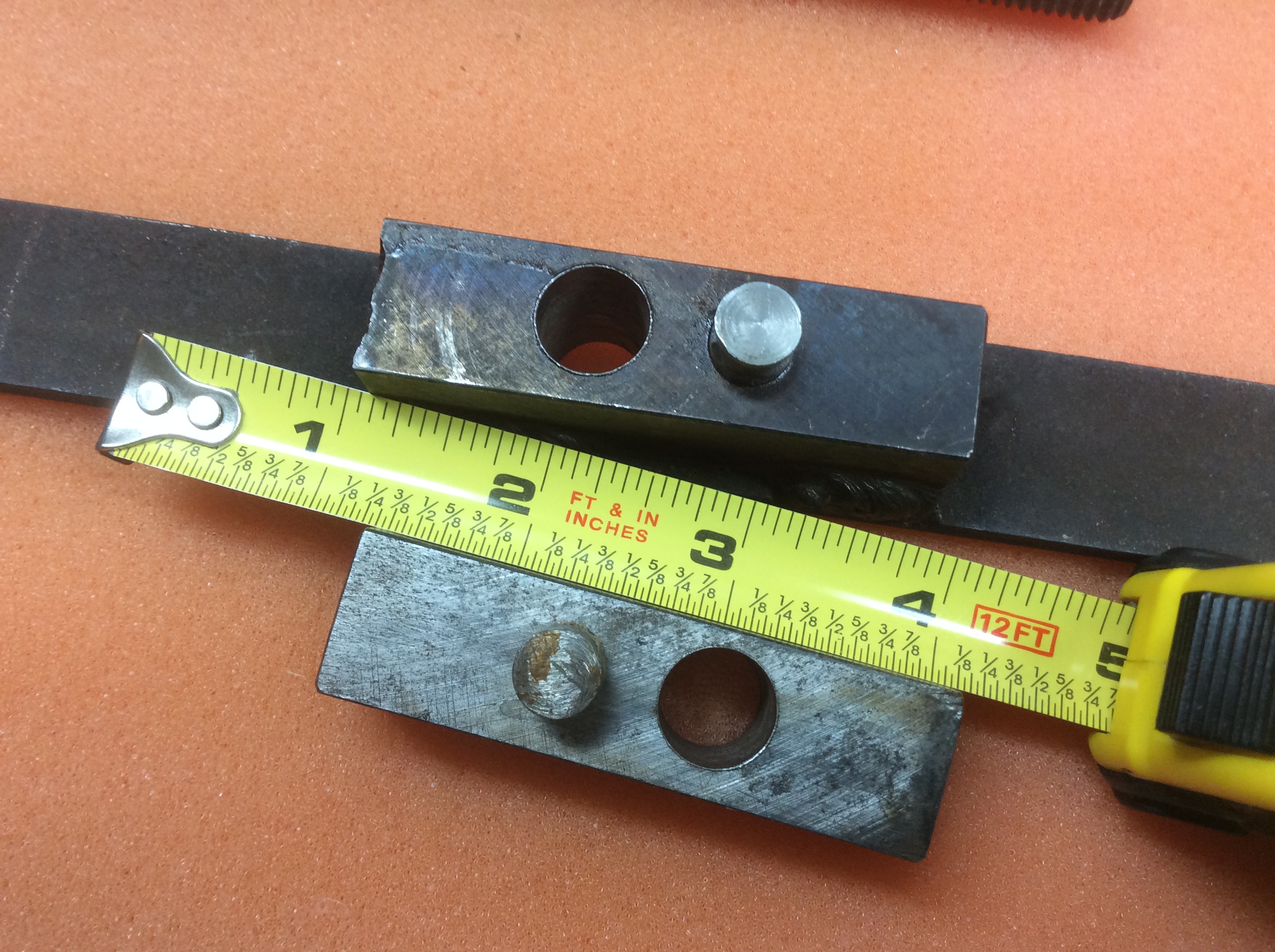

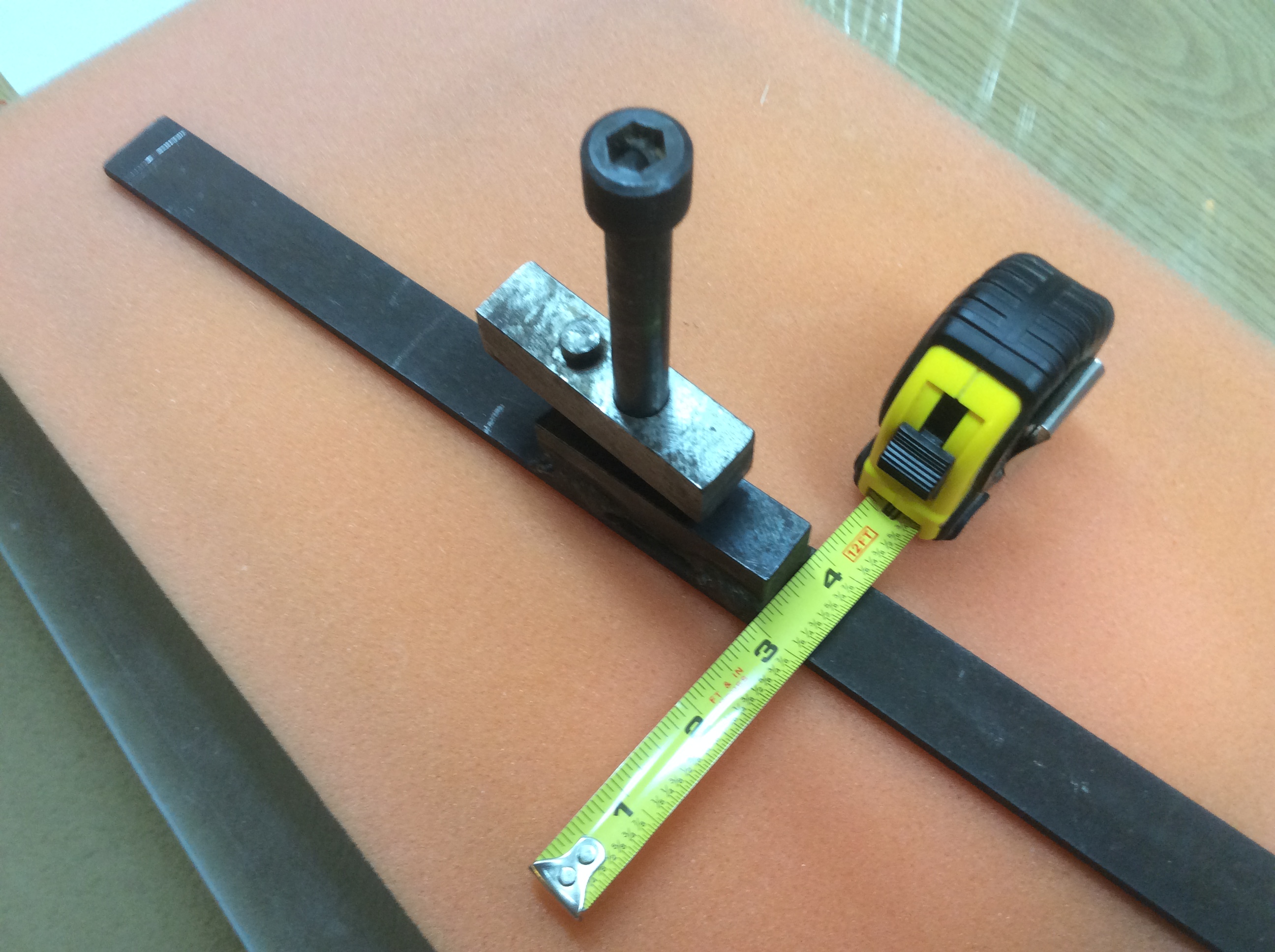

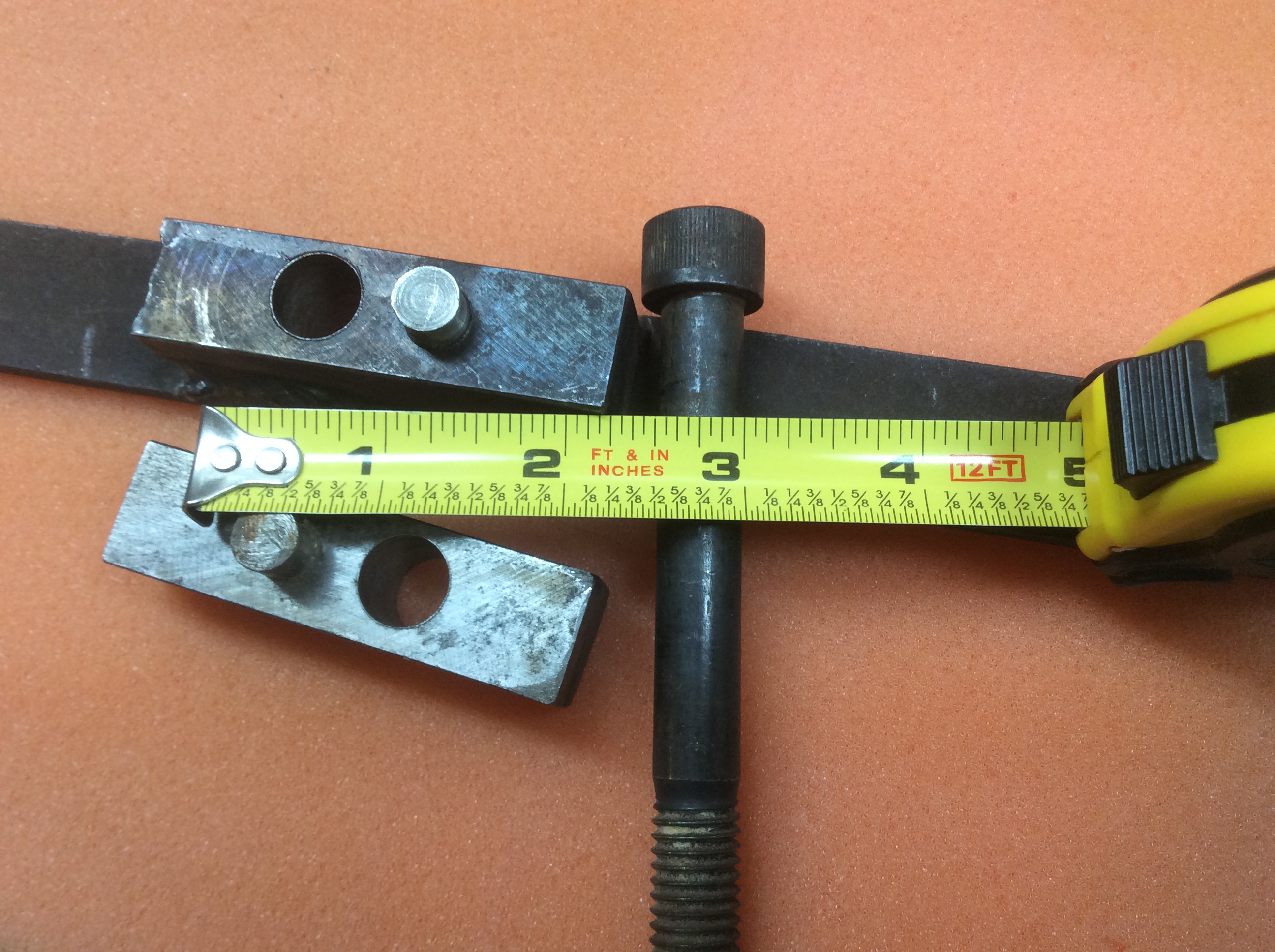

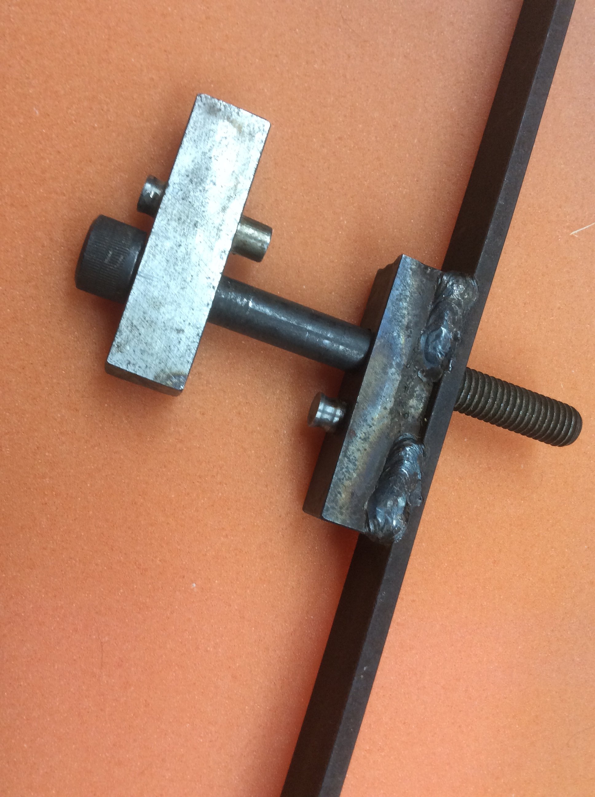

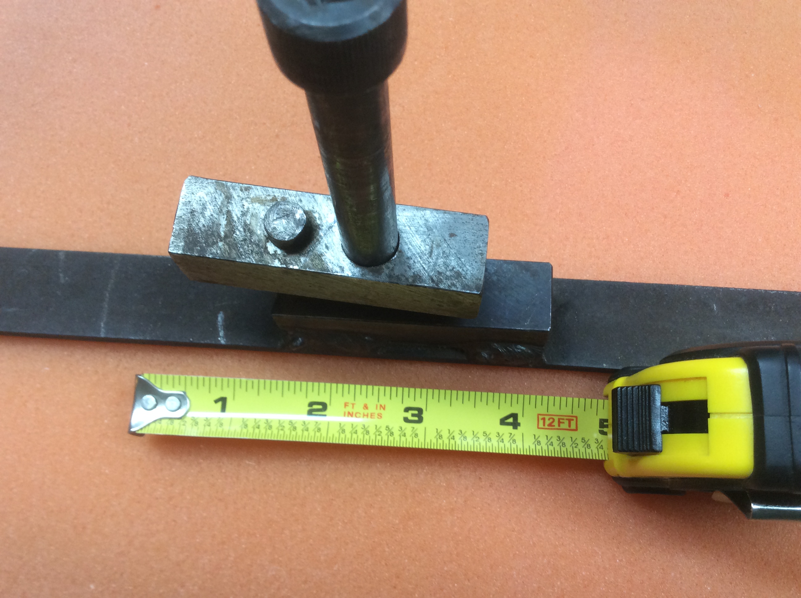

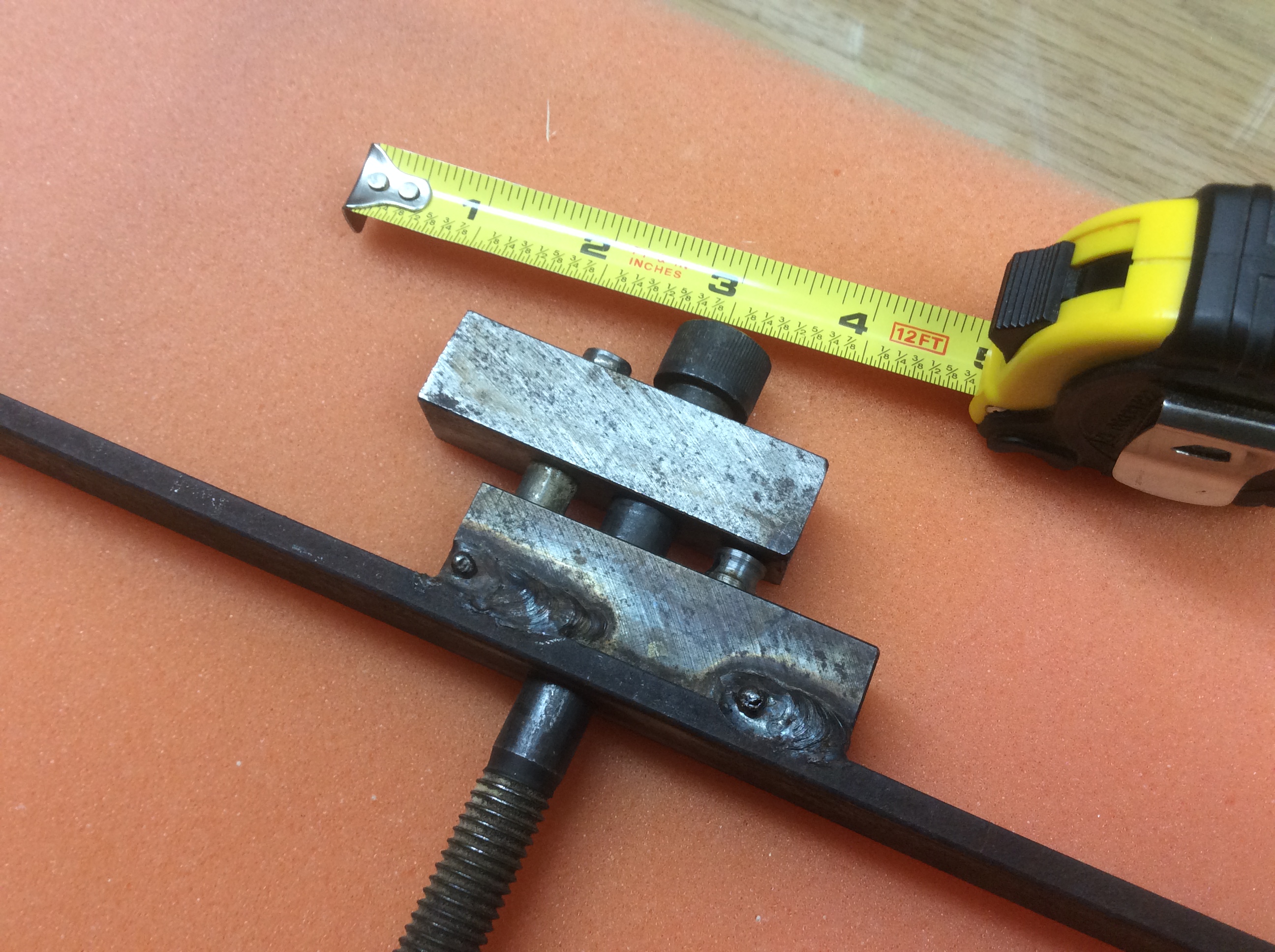

Ok hear goes trying my best to explain this tool and how it works. Bolt is 1/2 socket head screw and the pins are 5/16 drill rod. ( you can use a drill bit or any steel). The bolt is the item that the wire is bent around that is why I used a 1/2 inch bolt because that is the correct radios up to 5/16. Bent 5/16 but never anything heavier. Top plate is just leverage to bend the wire make it as long as you which, it is made from 1 inch wide by 1/4 by the length you need. The smaller block of steel is the block that is held by the vice. When it is in the vice the pin in that block is what stops the P.W from rotating. So you put the wire between the pin and the bolt. The pin in handle is what is used to wrap the wire around bolt. So with bottom part held in the vice with the bolt through both blocks of steel when you rotate the it pivots around the bolt wrapping wire around bolt.
