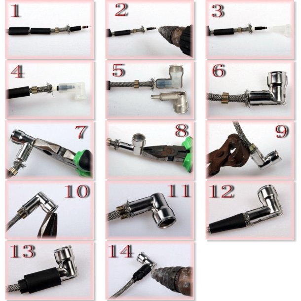

Installing CM6 Plug caps
Here are some instructions for installing CM6 plug caps on your ignition.
Our RCXP ignition have a smaller plug wire and the wire shielding goes to the inside of the plug cap.
