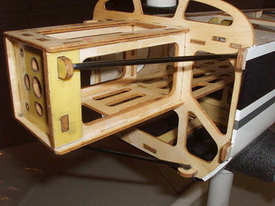

As you can see, the front of the motor box is reinforced with strong lightweight G10 composite material. This is the area where a a lot of motor box failures occur..... right behind the firewall. The face of the firewall itself is also covered in G10. This keeps the X mount from denting in the firewall if you over tighten it, like happens with bare wood, and avoids unwanted thrust angle changes
Extreme Flight solved a few big problems with it's carbon rod reinforcement of their motor box. As you can seem it is braced top and bottom. This makes the whole unit extremely rigid, which is what you need to get the maximum energy going from the motor.
Notice the carbon rods are mounted to thick plates that are extensions of the firewall and landing gear plate. The top rods anchor at the rear right into the first former. These are the most solid and rigid attachment points on the plane. They are also backed by strong G10 composite material. This is one stout assembly!
To achieve rigidity, most motor boxes extend way back into the battery compartment, and this can interfere with changing out the battery. On EXPs the motor box sides stop right at about the rear of the front former. This allows a very generous space for the battery, and there are no motor box sides to interfere with strapping the pack in. You don't have to struggle to change out the pack....just drop it in where you want it! Notice how the battery, strap, and deans plug are all right out in the open where you can easily get to them.

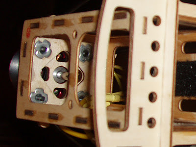

Notice the holes in the firewall. The one in the middle is for the collar on the motor shaft to stick through, but the other four line up perfectly with the exit holes on the back of the Torque 2814 motor. The baffles channel the air into the motor, it flows unrestricted out the back and through the holes in the firewall. My Torque motors have consistently run 10-15 degrees cooler in the EXP series planes than any other plane I have flown them in.
The next photo is a rear view of the firewall. Here you can plainly see through the firewall and into the back of the motor and it's windings. This is where the air exits the motor completely unrestricted, and this is why Torque motors run so cool in these planes.

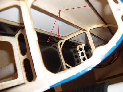

When you look a little deeper, you will see that even with extensive use of G10 composite, there is still a lot of carbon fiber in these planes. Carbon rods run from the first former all the way back to just ahead of the stabilizer. The next photo is the Extra, and you can see the turtle deck also has a rod running along each side. This is presumably because Daniel Holman uses this location to catch and release his planes!
There are also carbon rods running the length of the fuse along the bottom corner, and another just above that. since they are so hard to see against the black covering, I have drawn in some red arrows to highlight their location.

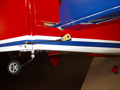

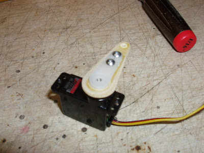

With the kind of throw we demand from our 3D planes, the standard servo arms are generally not long enough. Extreme flight again turns to G10 composite for the answer. The solution is a simple extension that slides over the back of the standard servo arm, and secures with a single screw and a little cyanoacrylate glue. Being a bit obsessive, I used two screws, but you can certainly see what a neat and tidy looking item it is. It is simple, and elegant, like the rest of the airplane.

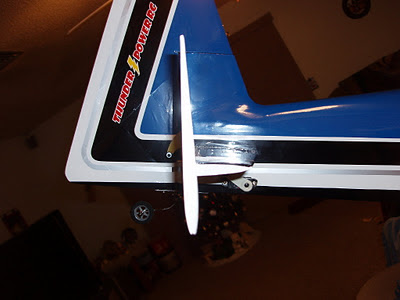

With the EXP's beveled surfaces, I can get nearly a full 90 degrees of throw out of the elevator. The Extra EXP below measured out at 88 degrees, but only because that is all the servo had. There was still enough movement left in the surface to get the full 90 if I wanted to use a longer arm. Still, I think 88 degrees is probably enough.
