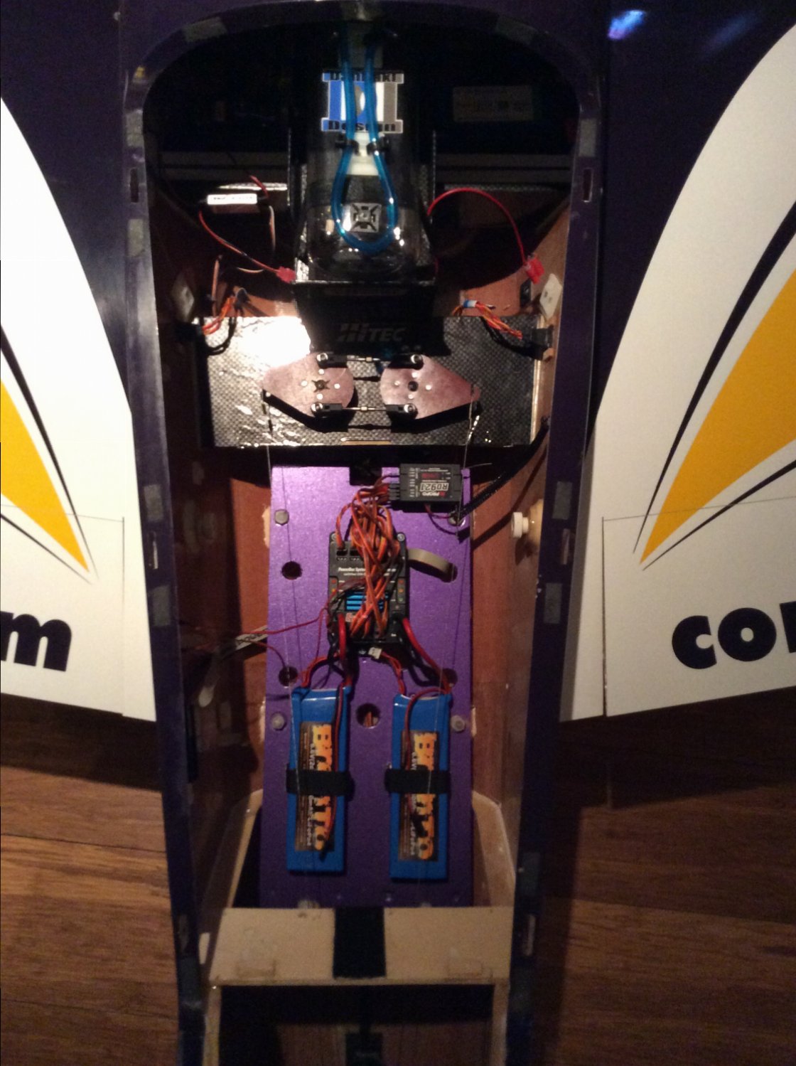

    So, I am refurbishing my CARF Extra 330L 100cc - old plane, new setup. My plan is to have 2 x LIFE 3000 mah into a Powebox Evolution. I am planning to power the ignition straight from the Powerbox. Is this OK, or a no-go??
  2. Probably a no go without a IBEC of some sort. The Tech Aero IBEC seems to be one of the better regarded brands, there are others out there also.

    Never fly without. Have a few, bot smart-fly and RCXL. Main concern was if the ignition could cause damage to the powerbox, but after reading this and the other site I'll give it a go

    how old is the ignition? if it's very old and therefore probably more likely to emit rf noise it still might not be such a great idea. newer ignitions with newer receivers don't seem to have the same problems anymore.
  5. I've run the Tech Aero IBEC into both the Powerbox Cockpit, and Smart fly EQ6 without issues. Also ran the smartfly opti kills, but changed to the IBEC when I converted my planes to HV, and wanted to get rid of my NiCad battery packs.

    3 year old DA-100. Should be good?

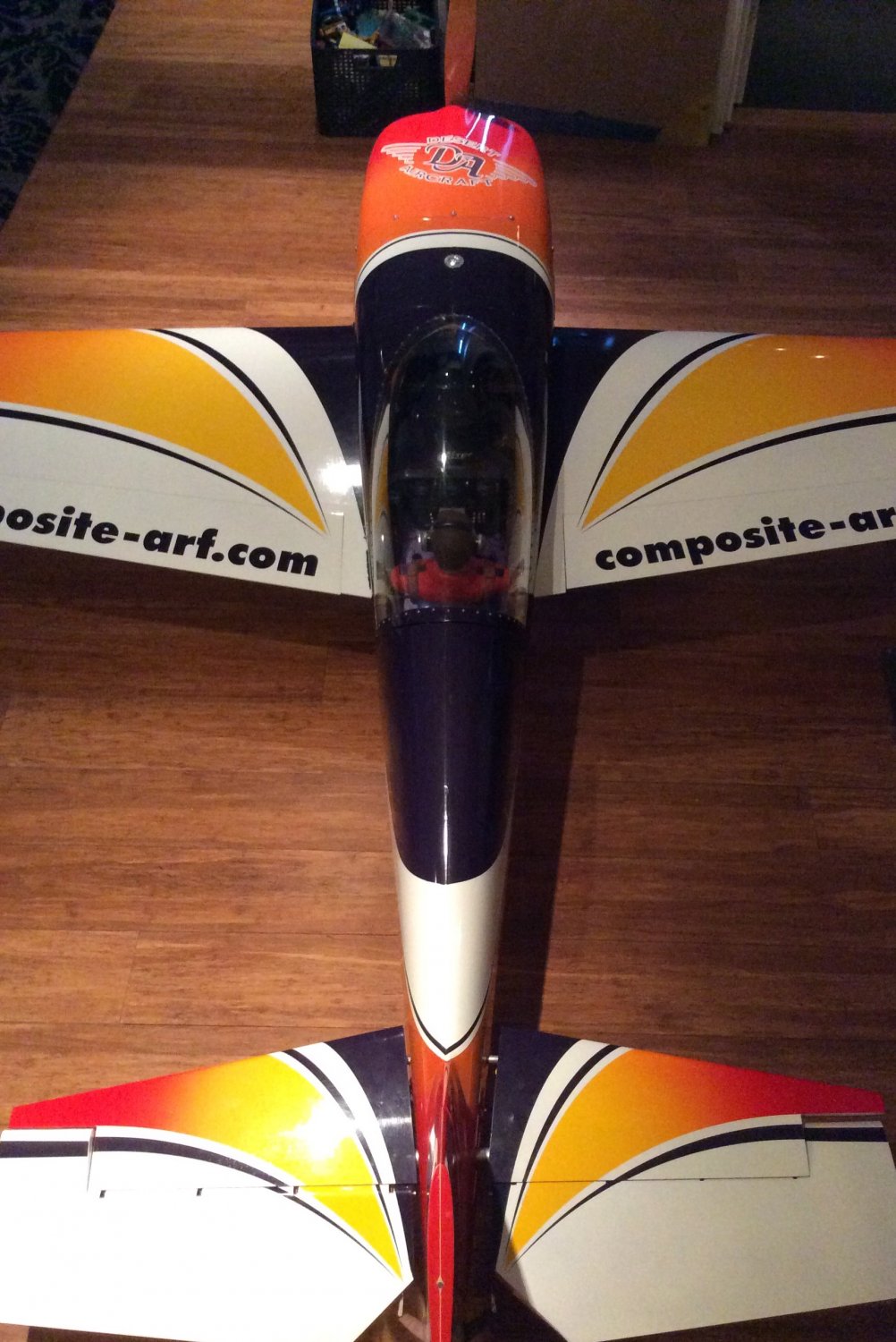

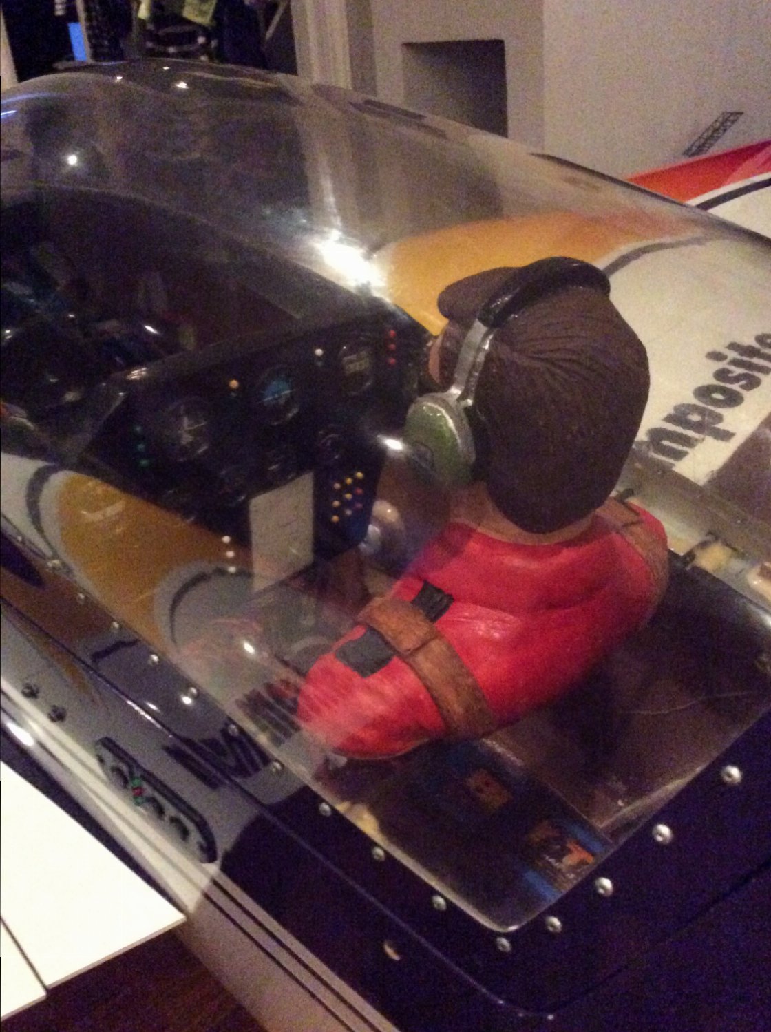

    image.jpeg image.jpeg image.jpeg Late reply. Studies, work... A college asked if I could fly first Saturday on an outdoor day for kids with cancer. I could not say no to that, so I finished the plane tonight. Pictures aren't any good, but it is what it is. Going to get 4-5 flights on it before Saturday, to check that all is good. (And after Saturday I'm starting the build of an EMHW 50 % Challenger).
