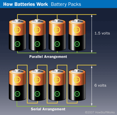

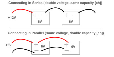

Keep in mind that max input voltage should not exceed 12 vdc. Also keep in mind batteries need to be wired parallel to keep the voltage the same. It could also be wired in series, providing the total amount of input voltage does not exceed the recommended 12 vdc. at full charge. Adjustable output useable voltage range is from 5.0 to 8.5 volts. You might want to give Kurt at Fromeco a call and ask him about current draw through the reg. In a simple setup solution, @thurmma is correct, they will feed both kill switch and rx.
