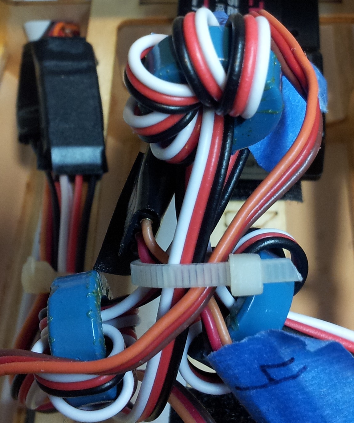

Here is a picture showing several of the 12†extensions with the ferrite rings installed.
