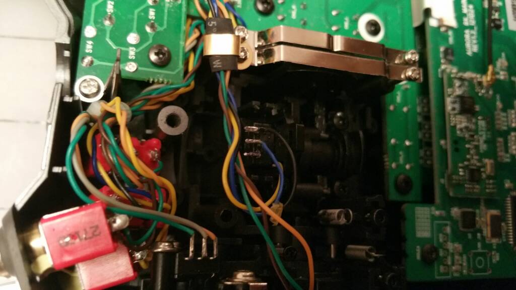

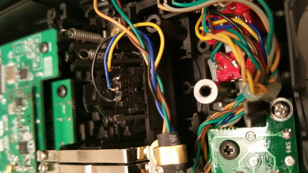

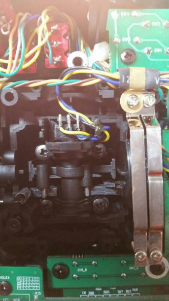

I was hoping hitec would step up but they are not going to. I want tolet you guys know about a safety concern. I had a pot replaced by hitec and they failed to secure the wires to the pot. I put about 12 flights on the radio since the repair and the ailerons locked full to the left. It cost me a 40 cent plane but luckily it went into the ground instead of a bunch of people. Without the wires being secured in the holder they will break at the solder joint. When using the gimble it works the wire back and forth till it breaks. I am in no way bashing hitec products. The problem i have is hitec wont step up and warn you guys to check and make sure the wires are secured. Here are pics of the broken wire,incorrect wire routing and correct wire routing.thanks
