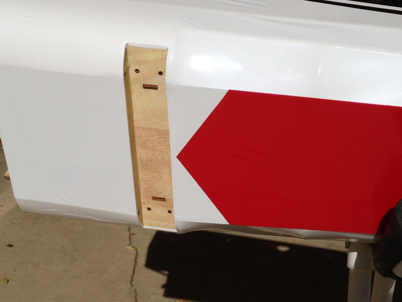

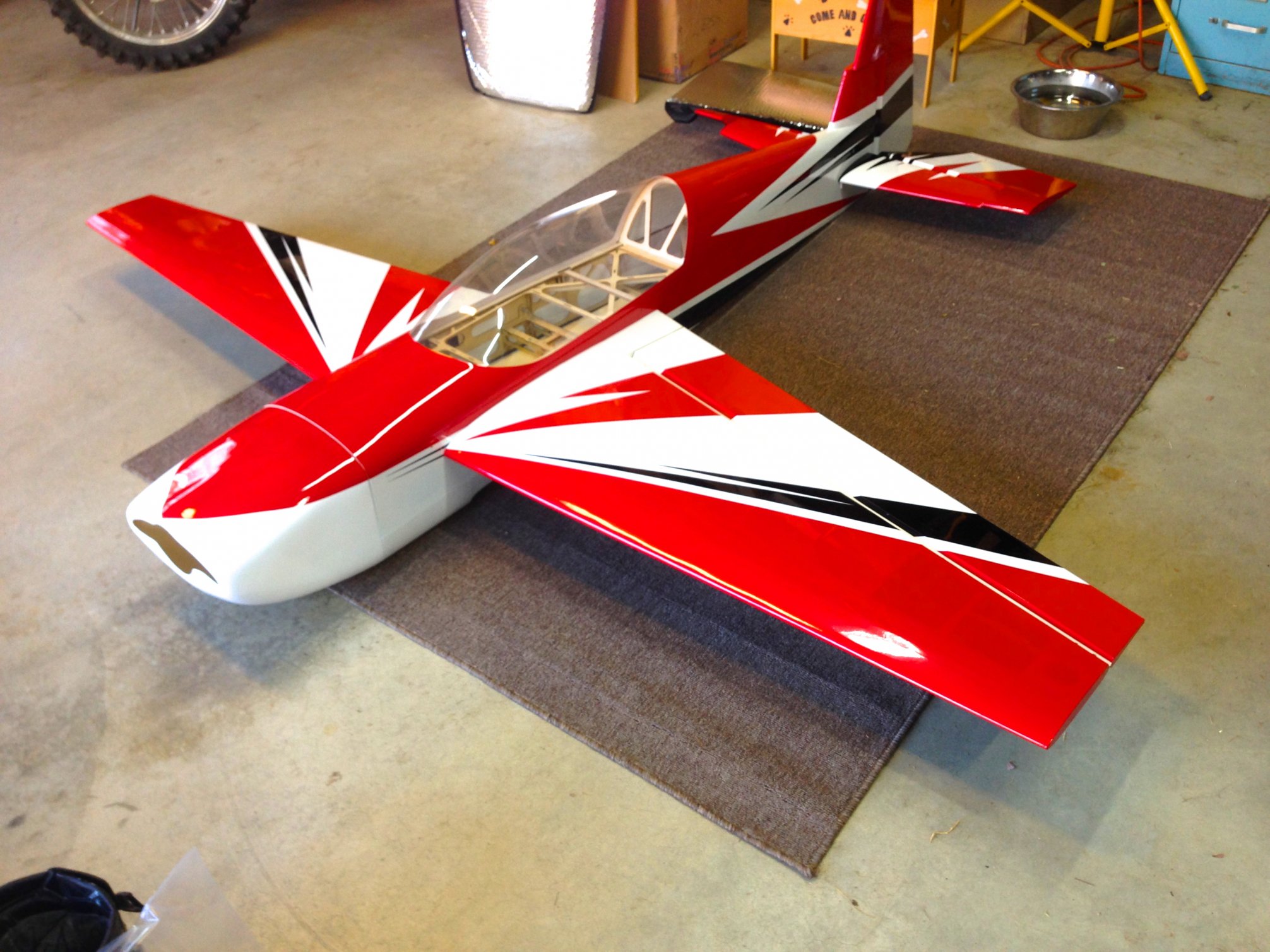

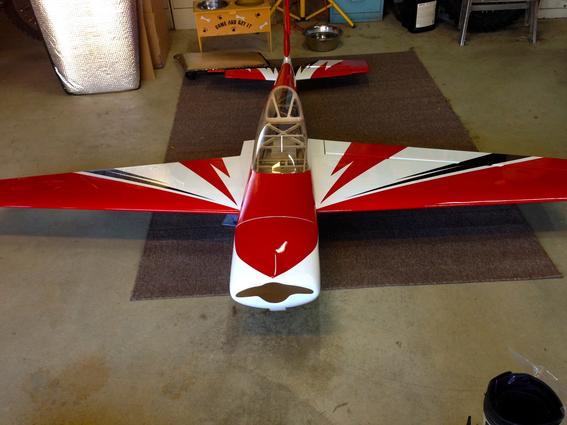

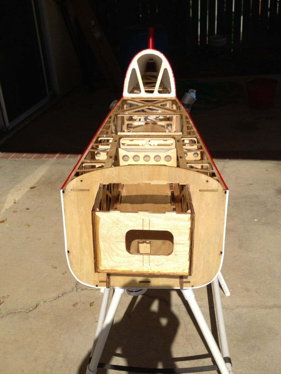

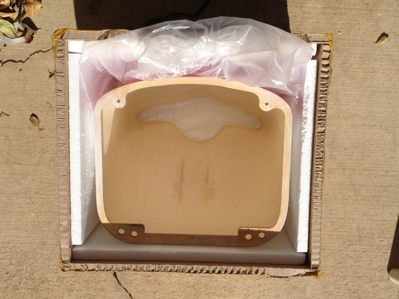

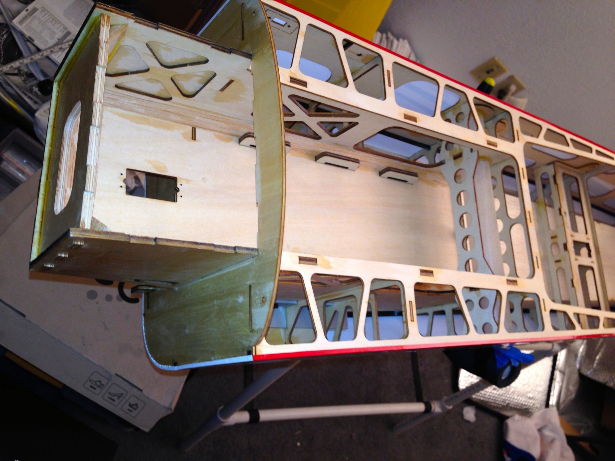

I was amazed at how quickly the 300 got to my house. From Ga. to Ca in four days. Double boxed and the inner boxes are very, very roubust. No damage at all. Did a quick fit check and everything looks good.

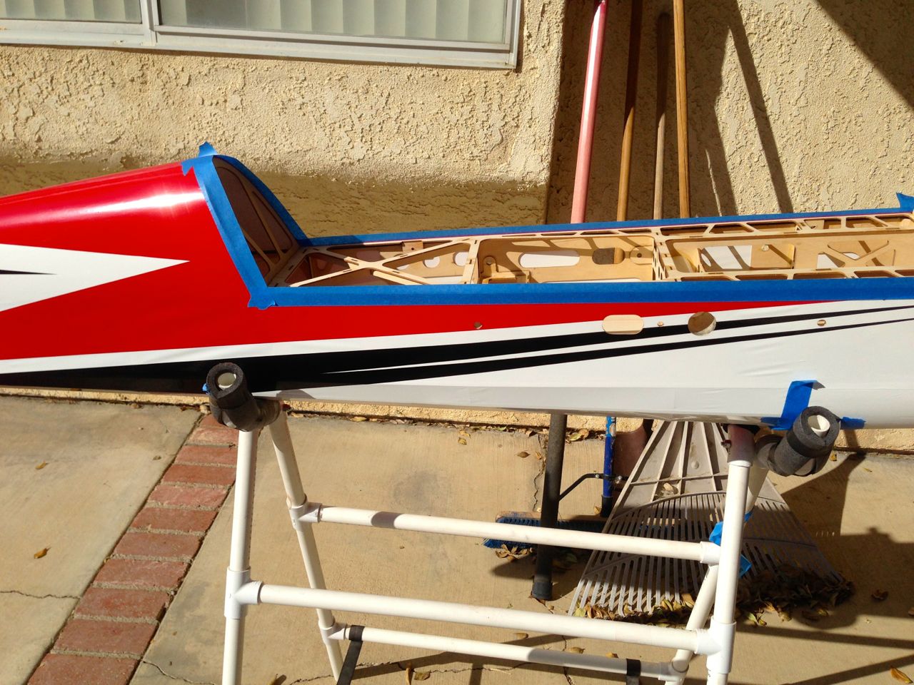

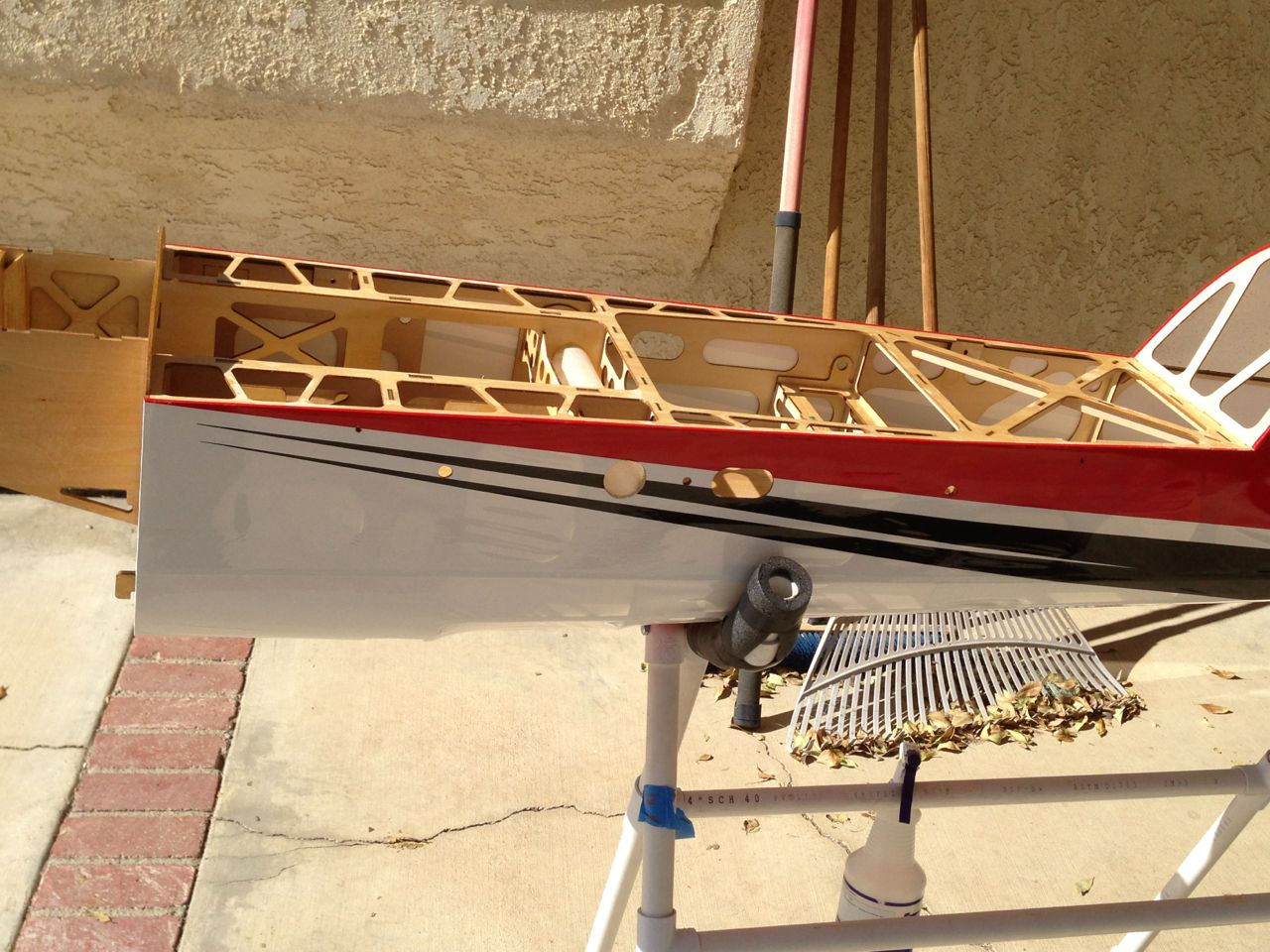

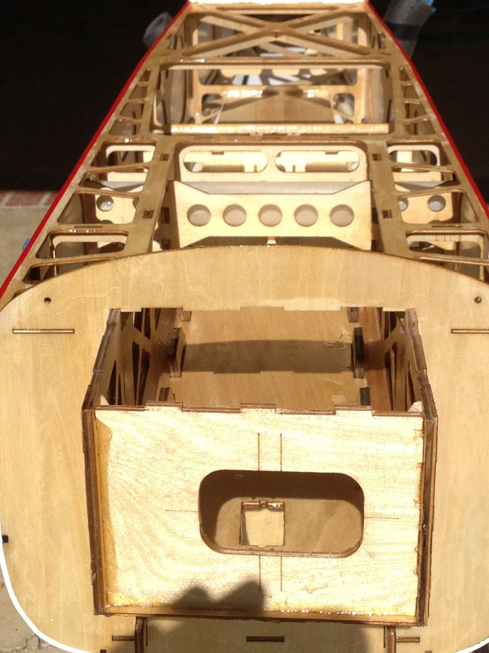

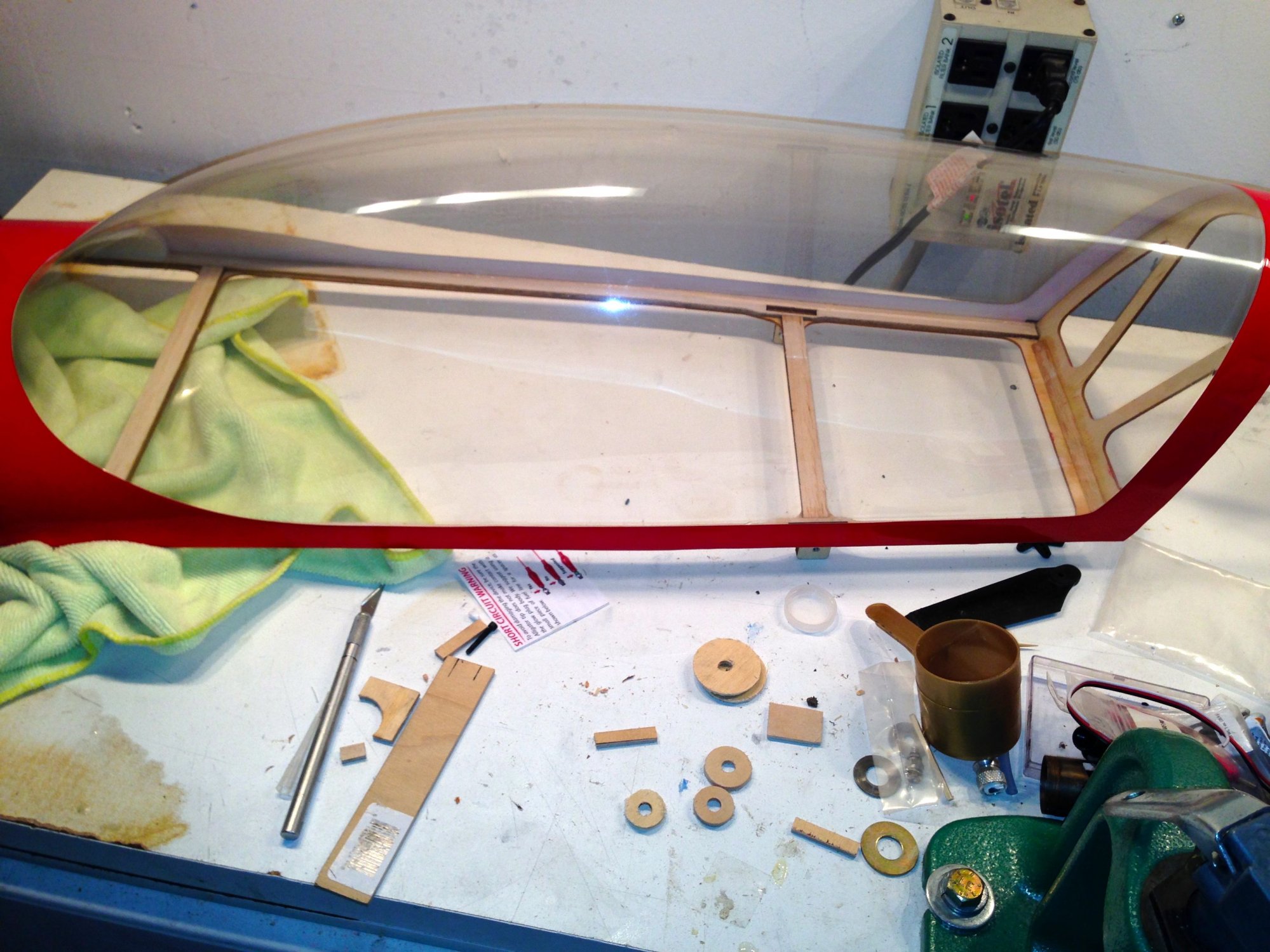

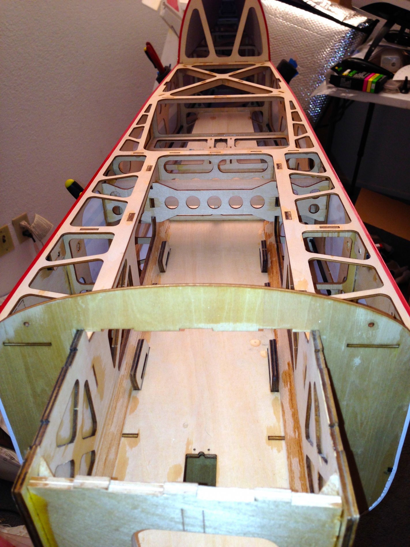

New EF EXTRA 300 91" .....Tonight I used canopy glue and went around the inside of the canopy. After that I pulled out the wings and and the elevators, bought a fresh bottle of thin CA and went around the anti-rotation pins and any other joints I could apply the CA too. I put those back in the there bags and went to work on the fuselage from the engine box back to the turttle deck. I applied CA to every piece of wood from the bottom of the fuse for the landing gear throughout the entire fuse. After finishing the fuse I went back to the canopy and applied CA to every glue joint I could see. Overall it took well over an hour. Tomorrow I'm going to fuel proof the fuse .

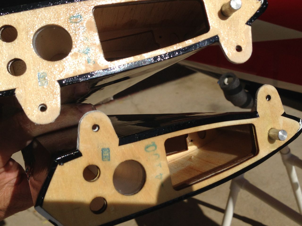

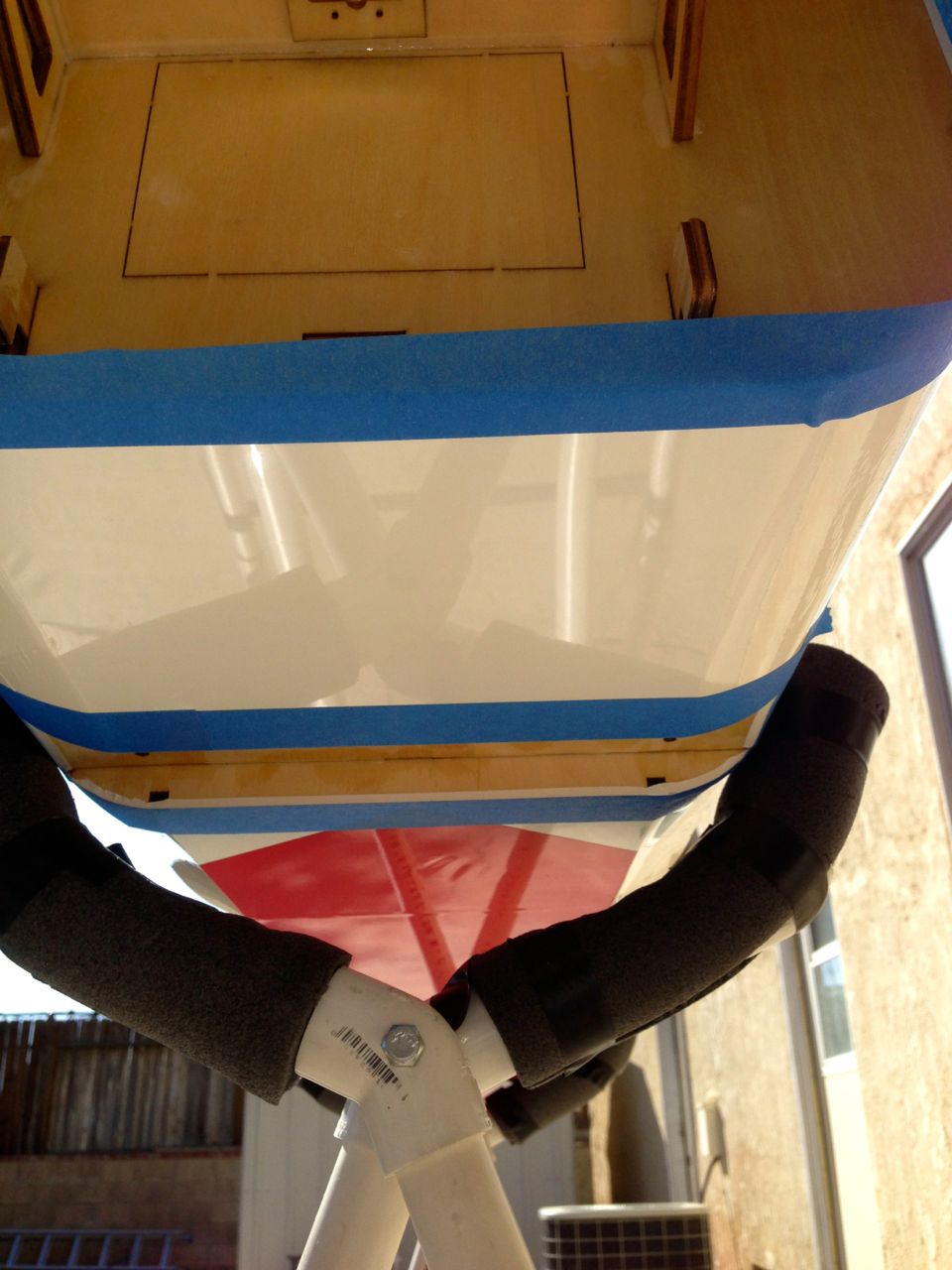

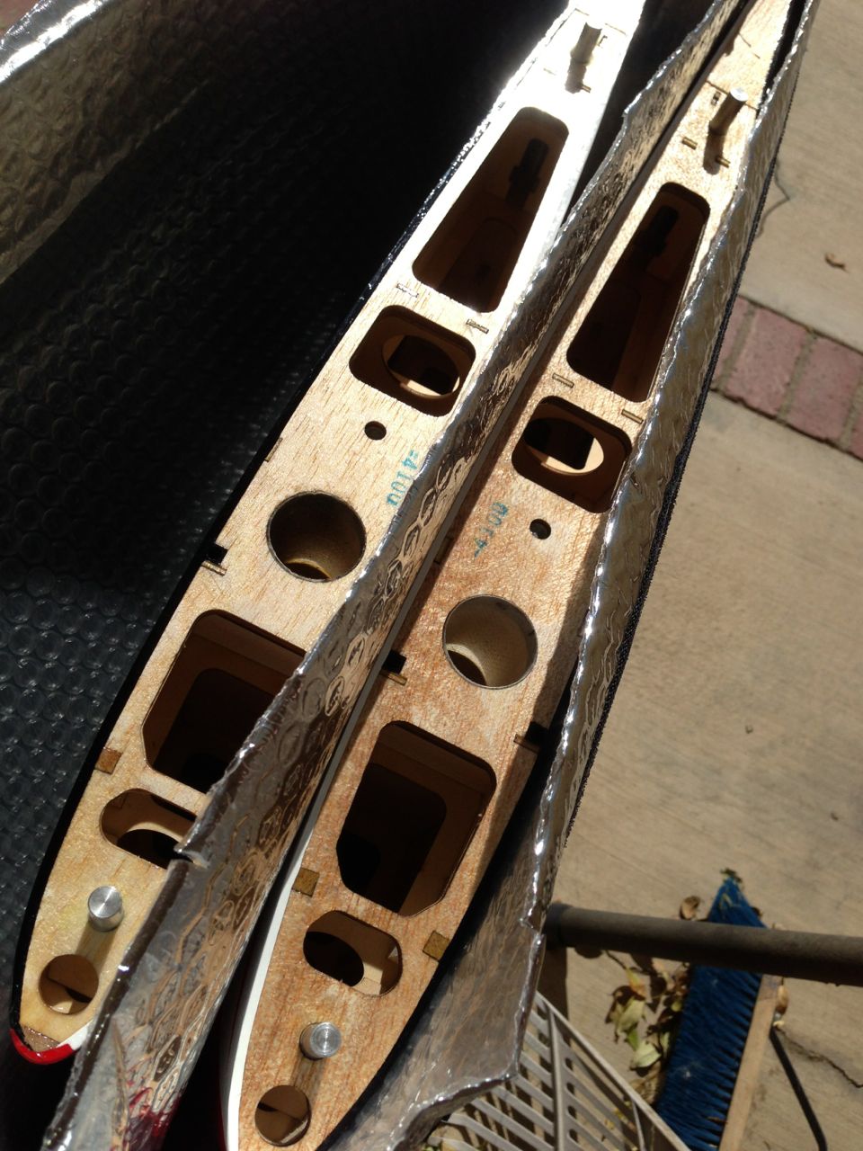

Well tomorrow came and went but today I did fuel seal the inside of the fuse, the motor box, the landing gear wood, cowl ring, wings and stabs. First I ironed all the Ultra coat where it is tacked down againt the wood on the fuse, wings and stabs; then, I used masking tape and masked off the fuse, wings, stabs and cowl. Before I fuel sealed he cowl I placed a bead of epoxy all the way around the inside of the cowl ring.
Immediatley after sealing the landing gear area I removed the masking tape and wiped it clean with denatured alcohol. I did have some of the fuel seal run onto the Ultra Coat but if you clean it immedatly after applying a fuel sealer you can't tell you ever had sealer on the Ultra Coat.

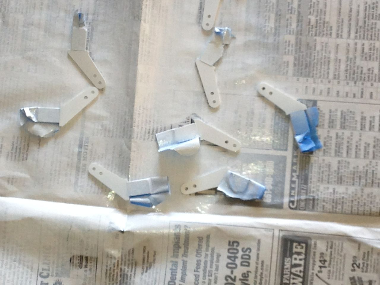

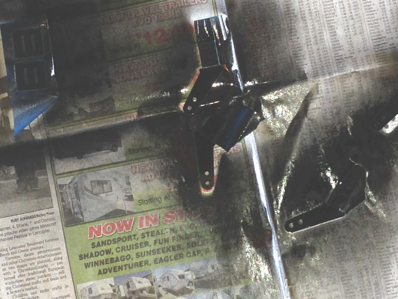

I painted all the control horns to match the Ultra Coat.
