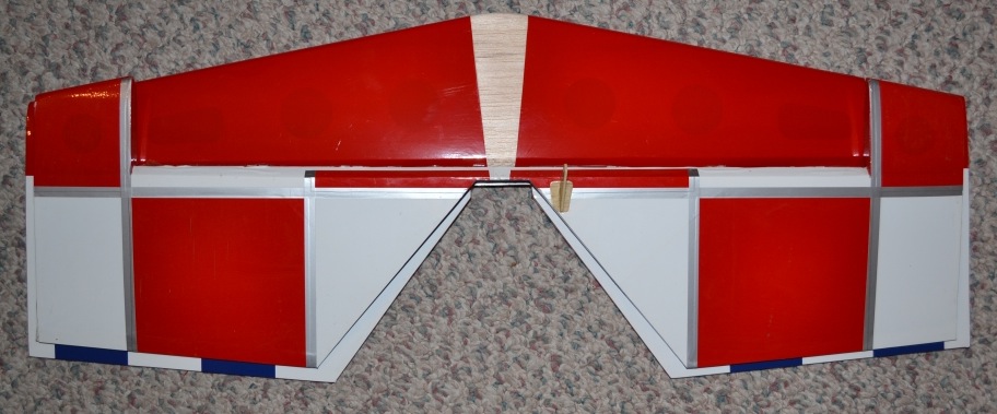

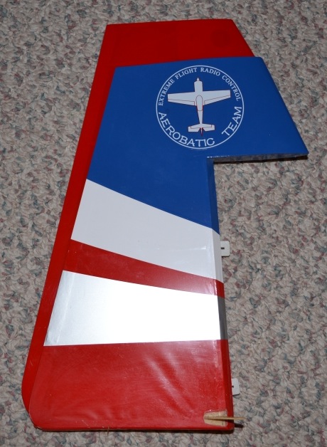

For those interested in the size, yes this "is" an EXP and below I have shown some comparison to the size of my 60" Edge 540.
The rudder is taller and slightly wider.

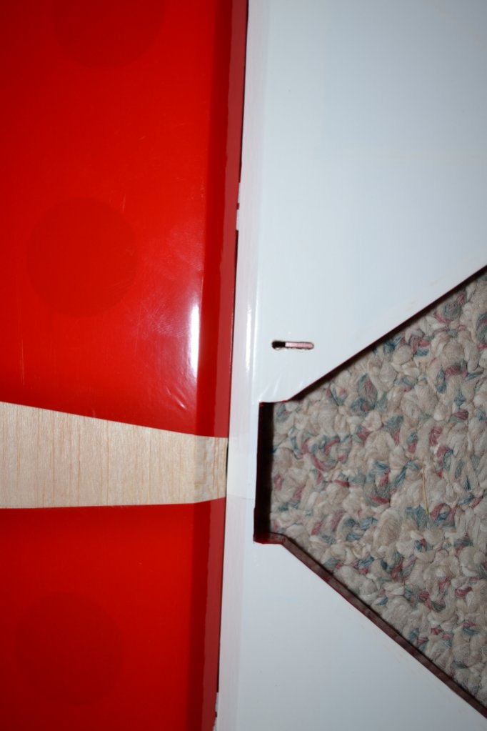

The elevator and stab is slightly bigger all around - the Laser is on the bottom with the Edge elevator on top. It is about 3/8" wider on the control surface and also about 3/8" longer on the sides. I can't wait to glue the elevator to the stab to show you but the gap bevel is done fantastic. Looks like no problem to get 90º

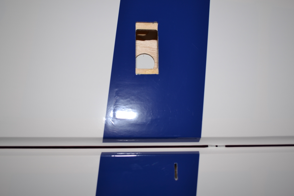

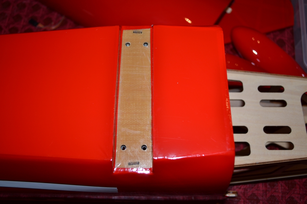

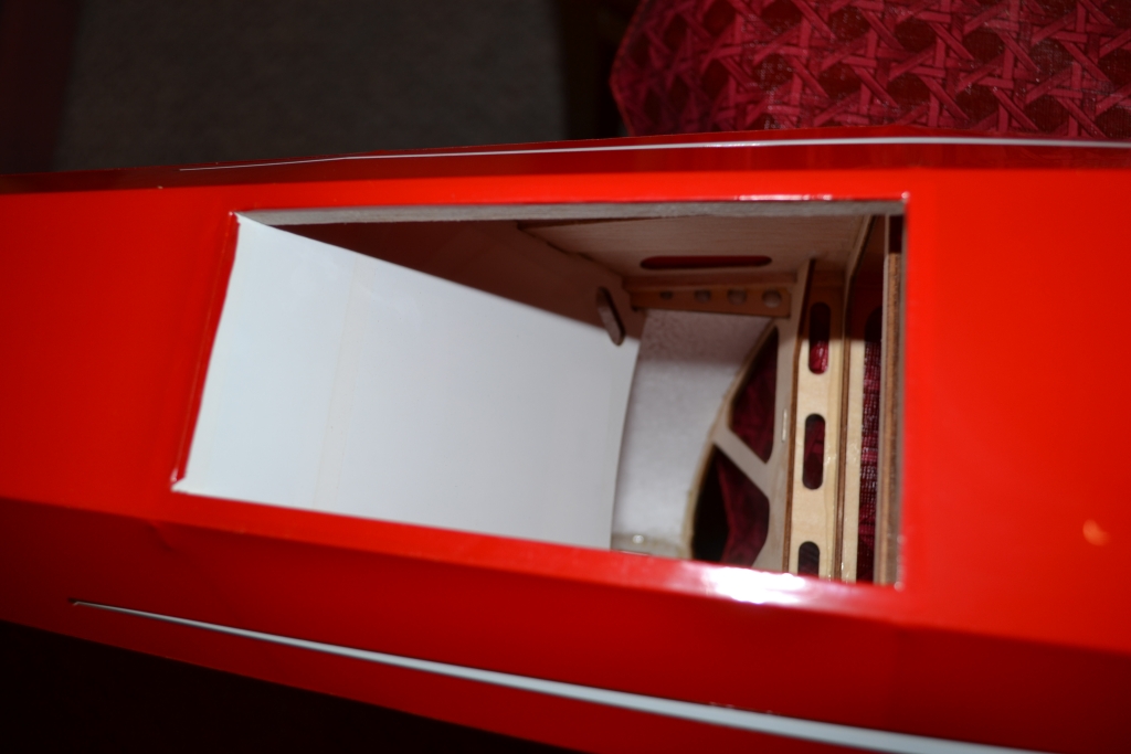

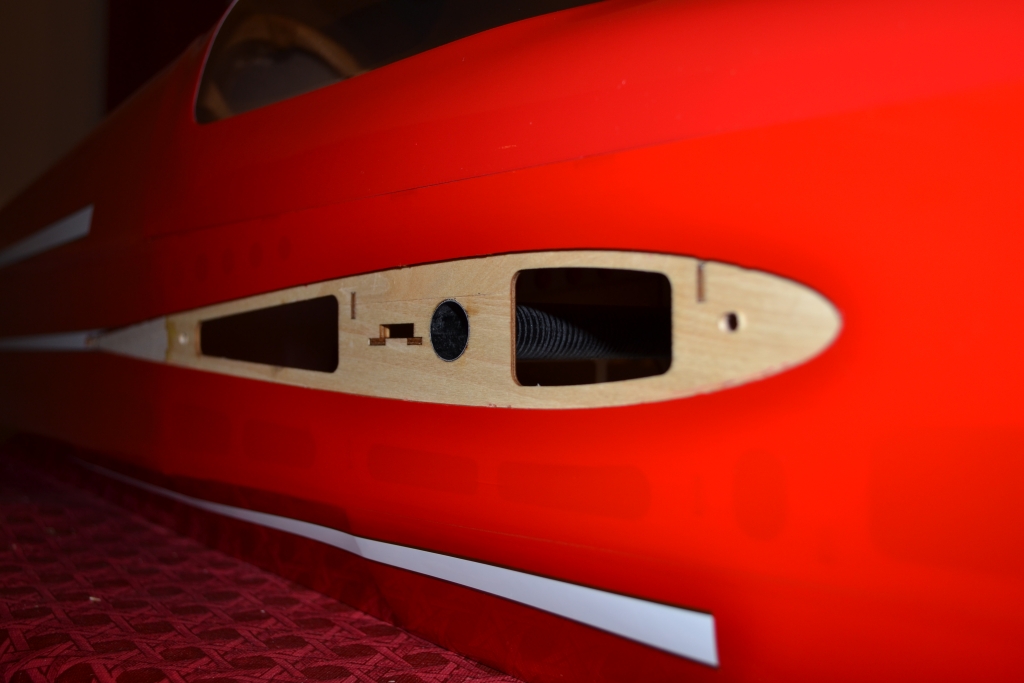

A lot of the work is done for you and done very well regarding the pre-trimming of control horns, servo openings, the fuselage bottom cooling exit and the wing recess. I had a problem with the exit cooling cut out on my Edge because a wood cross member was not low enough. This is absolutely perfect and the cool part is that the back slanted wall deflecting the air is also covered in white for that extra clean look. A nice touch indeed.

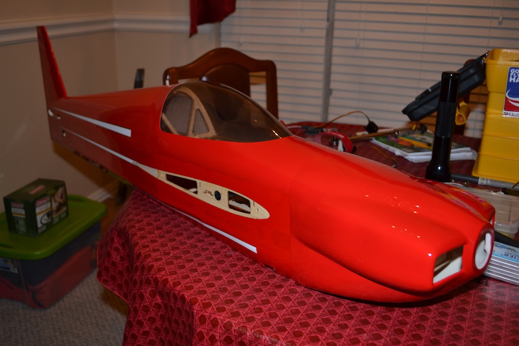

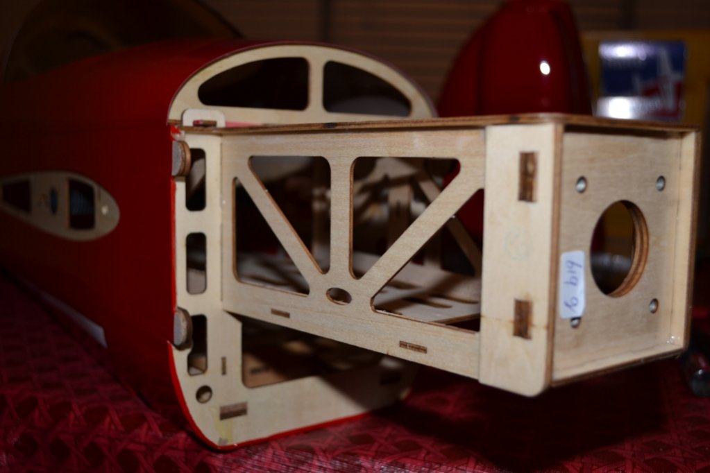

The fuselage is slightly taller and wider than my Edge, it should be easy to work inside for sure. The motor box is real long and at the moment has me concerned for the short wires that came on my ZTW ESC. The cowl has huge air inlets which should be wonderful for those that have hot running motors and ESC's. Should not be a problem cooling things down with this one.

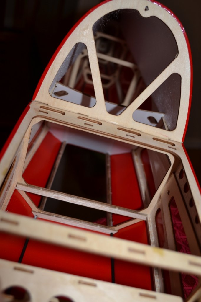

The turtle deck has the typical foam lamination on the inside giving it a lot of strength. You can see in the picture that tapered wall for the cooling exit finished in white. Canopy latch has very smooth operation. Don't forget that is a location to wick in some CA to be sure that latch is really secure and be careful to not go overboard that some gets in the mechanism.
