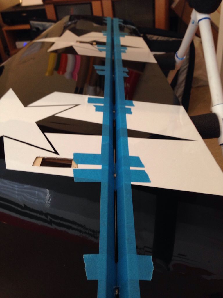

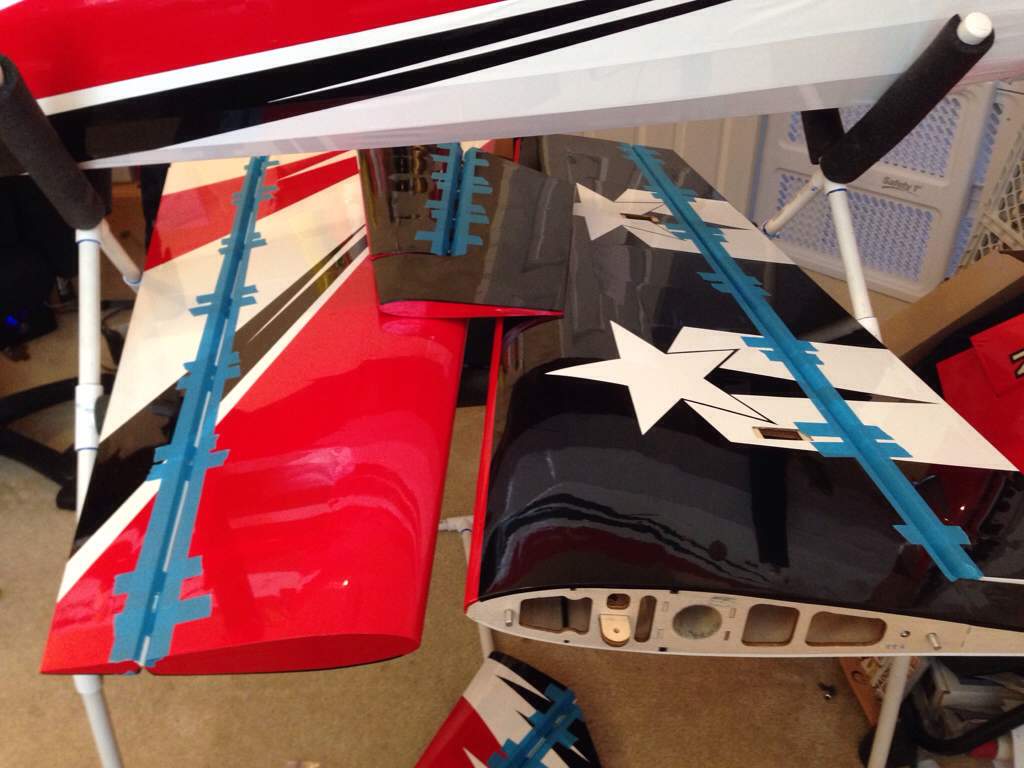

Got some build progress done today.
Many thanks to [MENTION=413]Brian Yak Dude[/MENTION] for coming by and helping out with the cool tape idea and getting some work down on the 104!
All hinges except removable rudder are now done!

Well, one wings hinges got messed up. Some how, (I suspect I didn't do good enough Vaseline application) about 4 hinges got epoxy in them and wouldn't bend... Luckily the other wing and both elevators came out fine.
So I spent a fair amount of time last night with the soldering iron and drill, and removed what I could of the old hinges, and drilled out the holes.
I got the aileron rehinged last night, and I'll attach it to the wing this morning.
Big bummer overall, but I think I'll be able to hide the damage with some ultracote hinge sealing.
