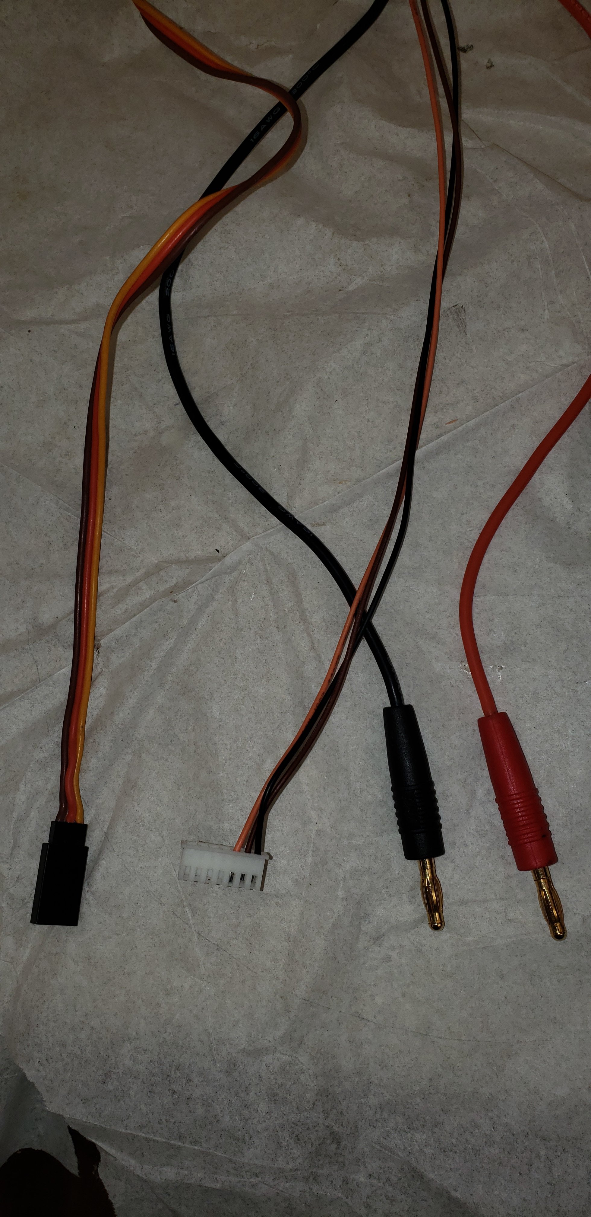

My Areoworks 540 came with Ed Nano batteries and a balance charge cord that connected to a hitec charger. The cord does not match my Cellpro connectors. Any ideas?
I think I got it. Here's the connector.
MarkF
New to GSN!
That's a 6s balance connector with only 2s of battery connected. What size is the battery? Show pic of battery.
Mark

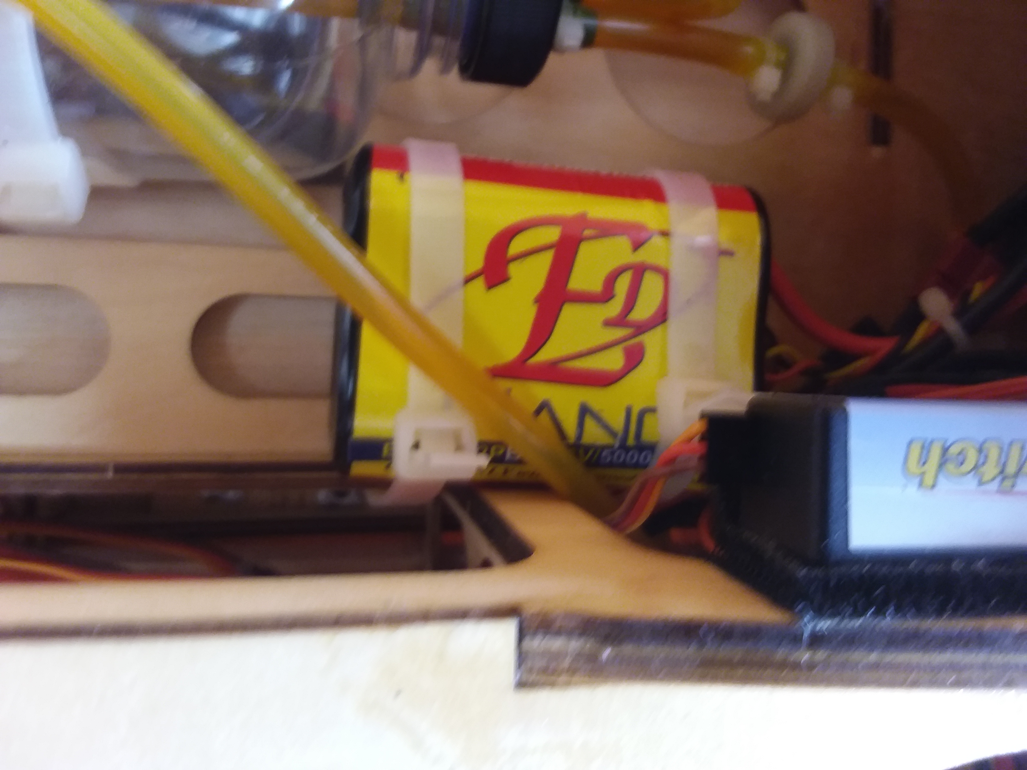

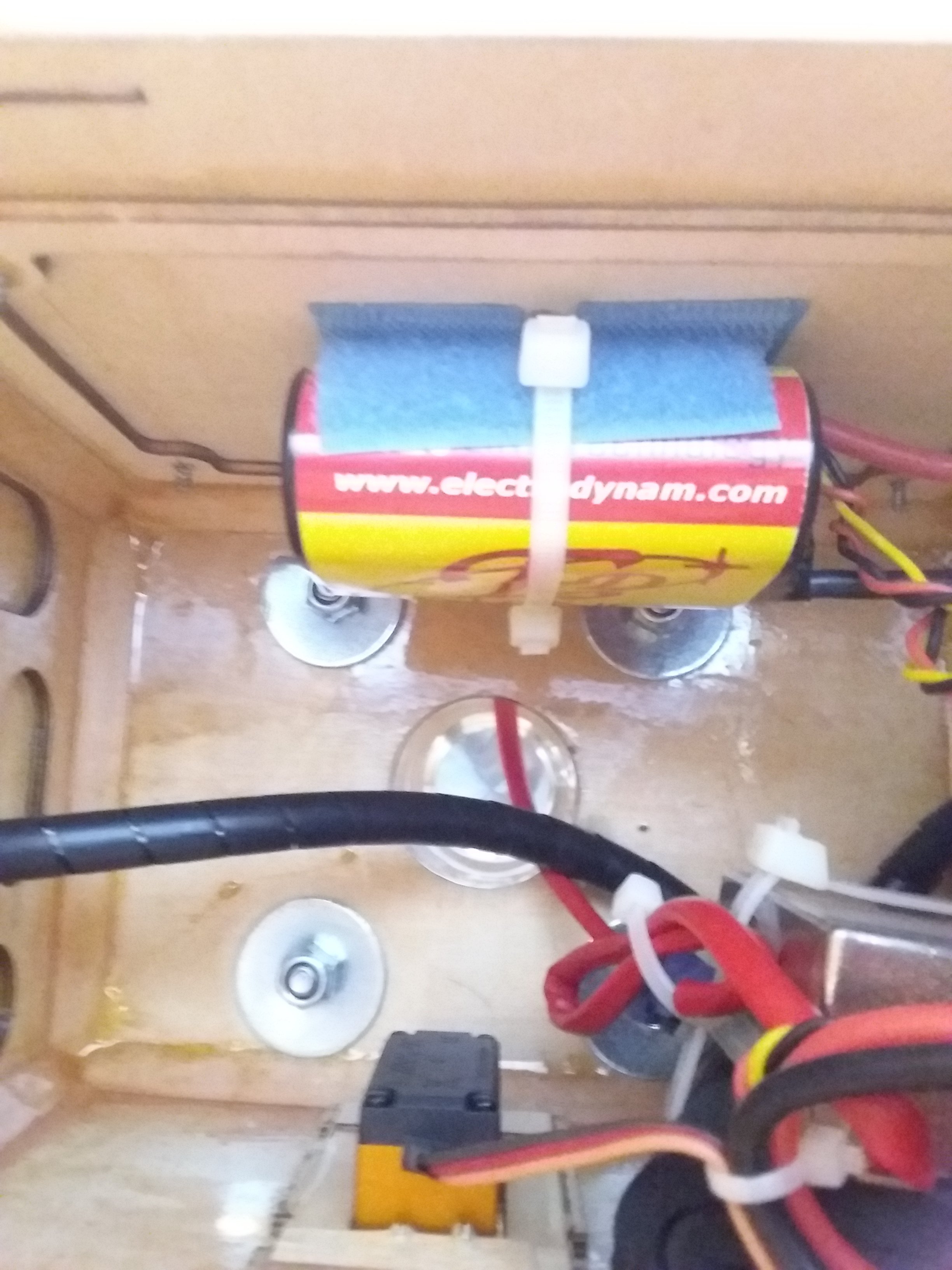

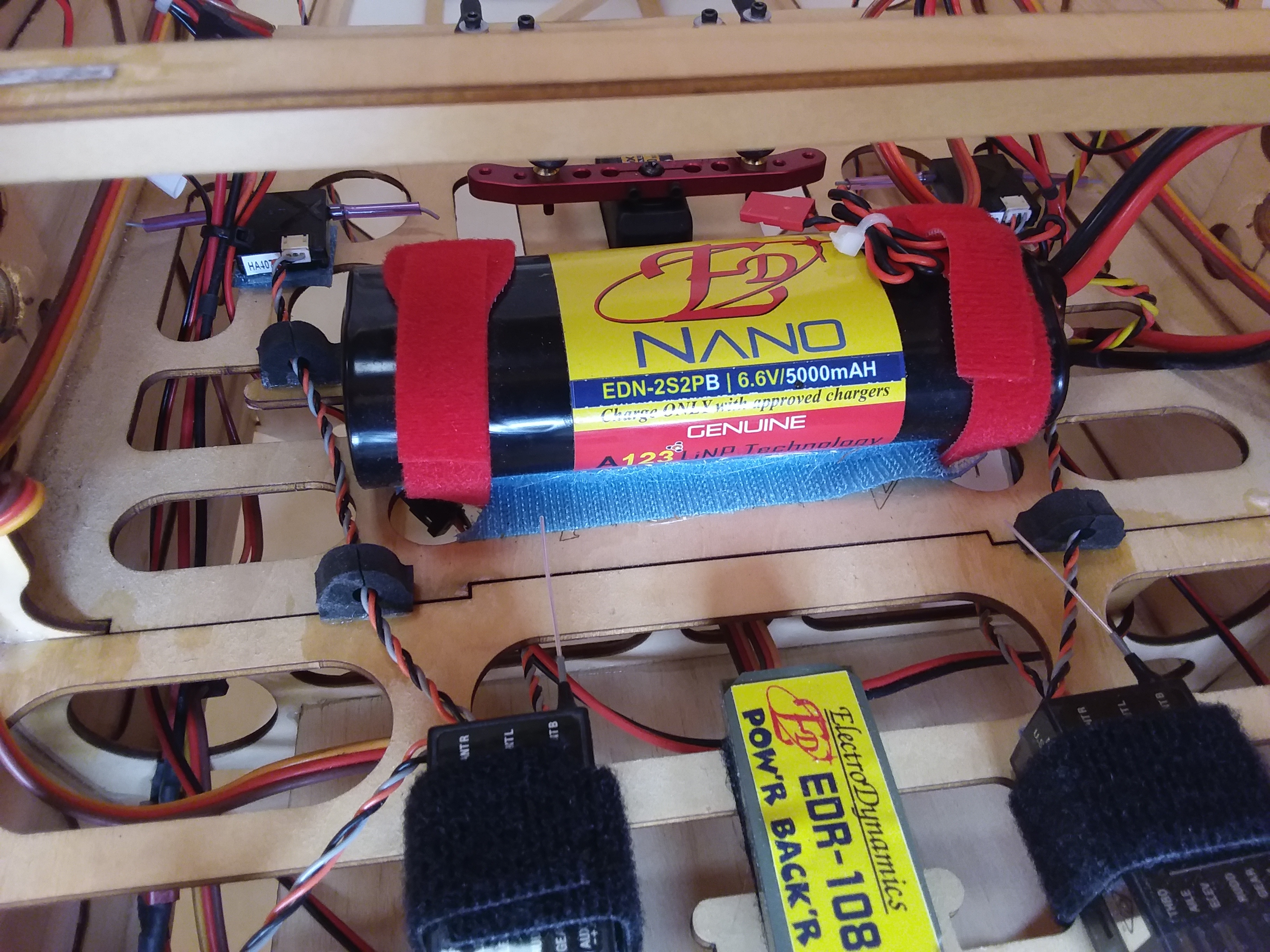

I don't know anything about batteries so appreciate the help. Here's the 3 batteries that came in the plane.
