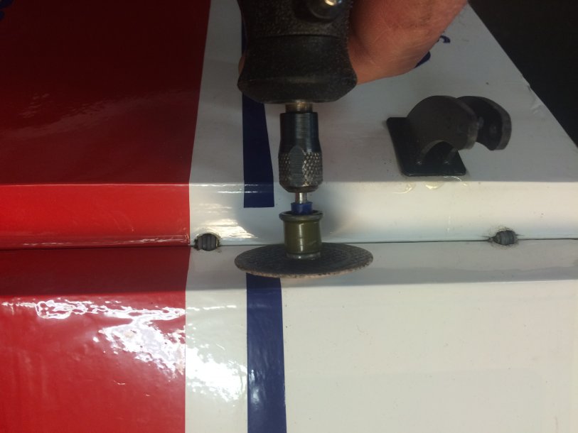

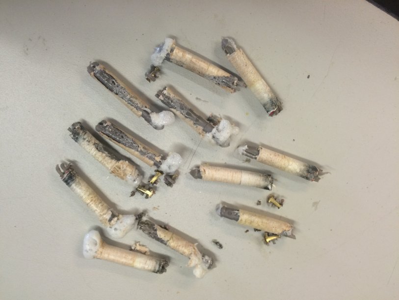

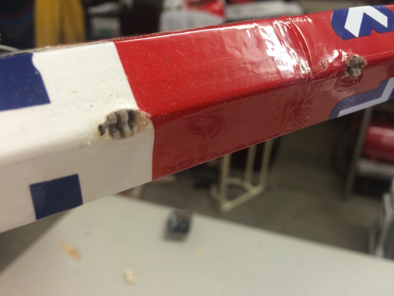

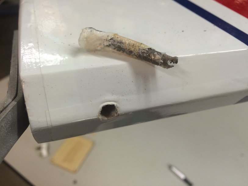

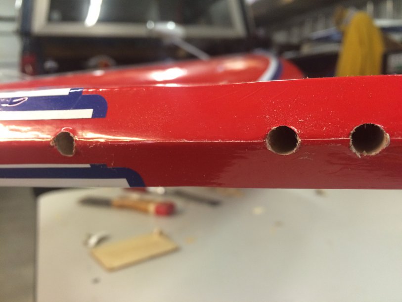

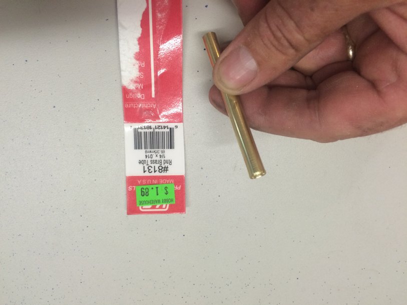

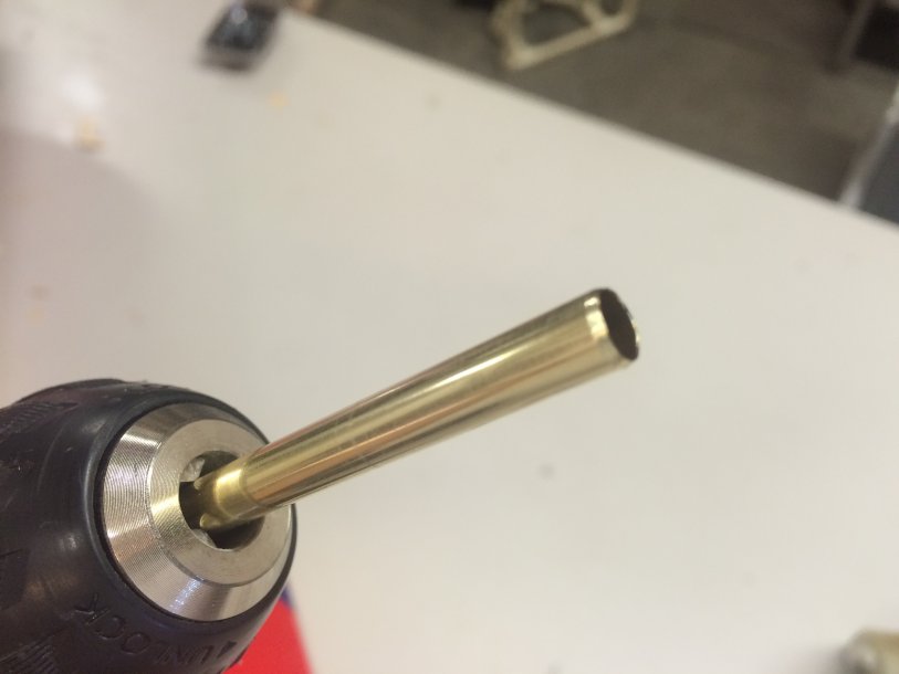

I was looking for another way to remove hinge points and ran across an idea from a thread I was reading.

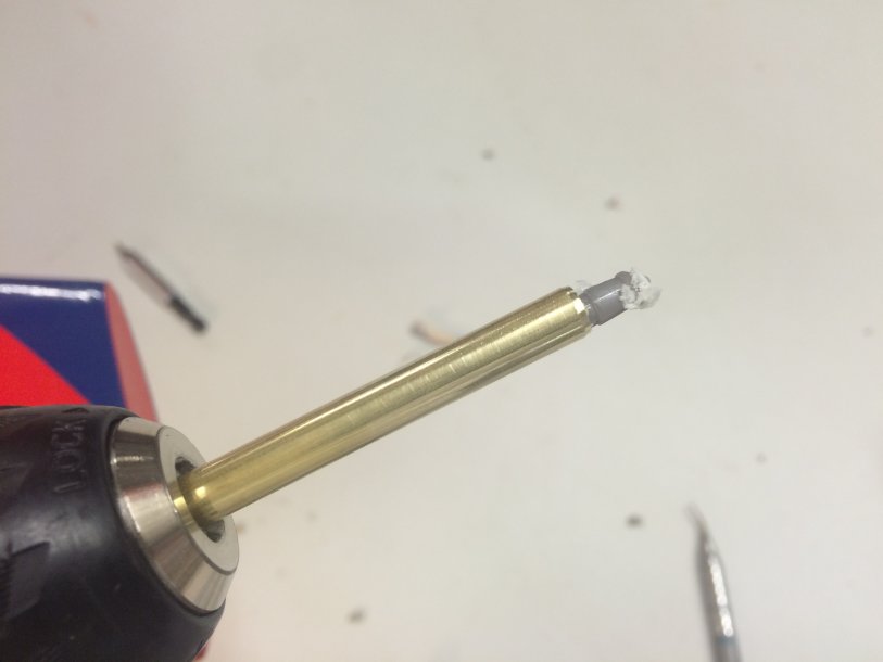

It works rather well. I stopped by my local hobby shop and picked up a piece of brass tubing and
after a couple runs on the belt sander and a Xacto knife for the inside radius edge.
We had ourselves a awesome cutting device.
Super smooth in and out and it removed all points without any problems.
Try it...
