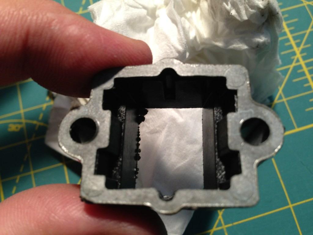

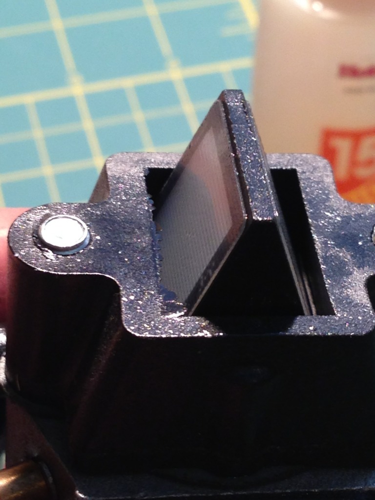

It had a little carbon goo caked on the top of the piston, so I cleaned that off, but otherwise the combustion chamber looked awesome. I pulled the carb, and took a peak at the reed block. I had previously only sanded the spots where the reeds lay, so this time I inspected the rest:
ImageUploadedByTapatalk1371403626.236305.jpgImageUploadedByTapatalk1371403642.835671.jpg
It needed a little work, so I cut the burrs off with an exacto, and then sanded the rest of the block.

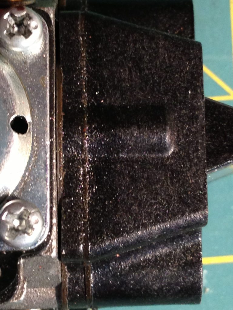

I also noticed a tiny bit of seepage around the gasket:
So I made sure those areas are flat now. I tightened everything down real well... Maybe too tight? Now my choke is really hard to move... I'm going to try and add a pinch of oil there, and see if I can work it in so that it moves freely again. I'll report back.

I think I remember reading something to the effect that you can "warp" the reed block if you tighten the carb down too tight. Even though the reed block is molded from a hard thermo-plastic it can compress/bend. Use some blue thread lock and just hand tighten the carb bolts.
Thanks Rex. I loosened the bolts attaching the carb to the motor, and the choke moves easier now. Thanks for the pointer.
