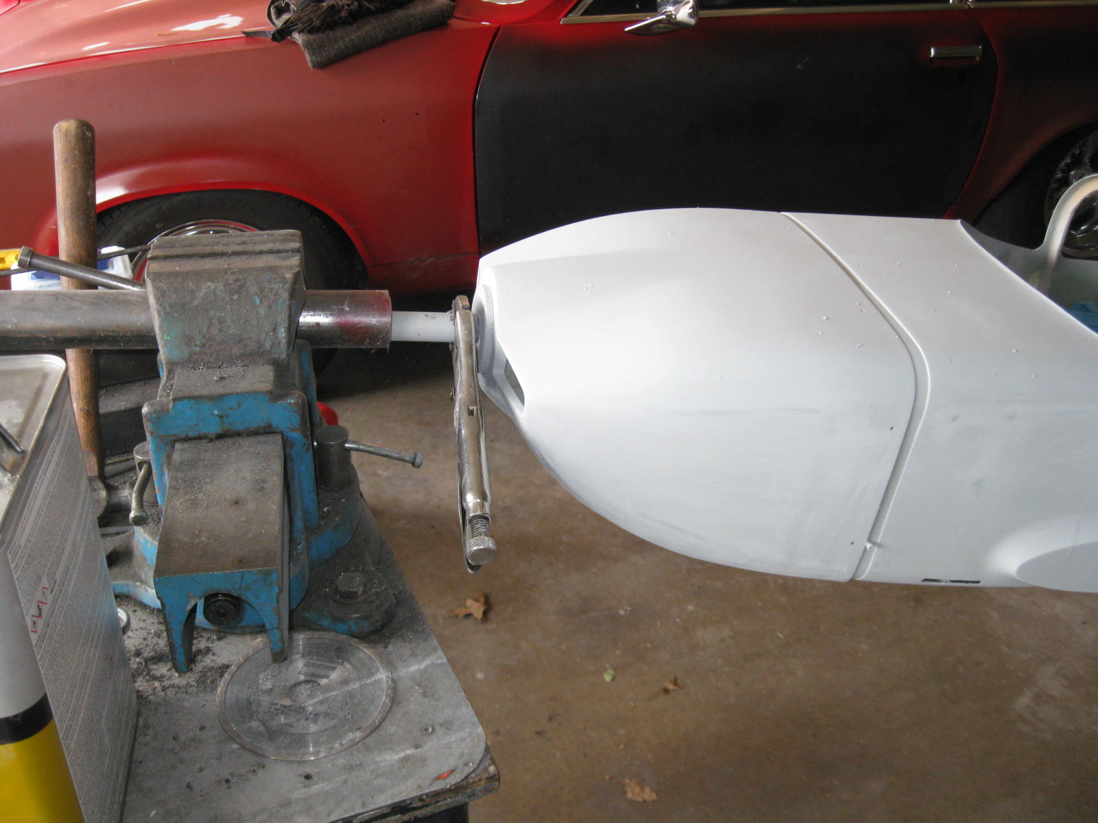

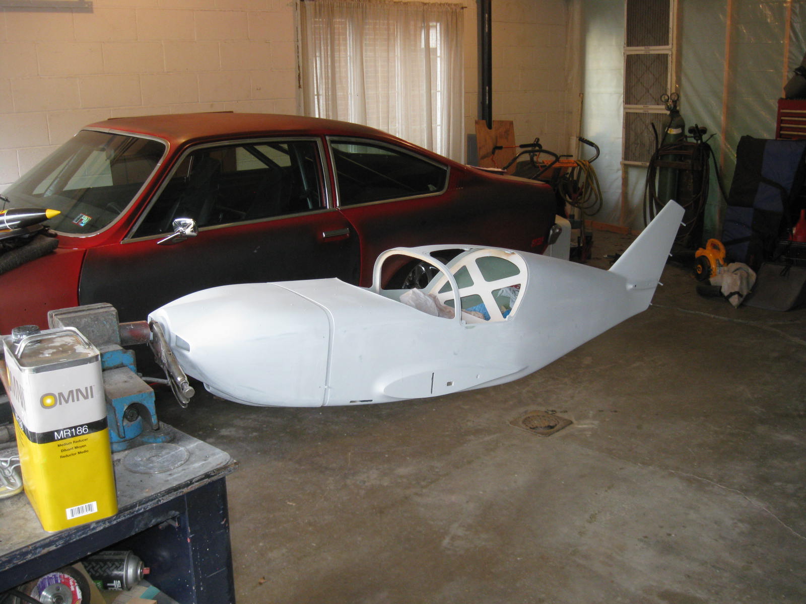

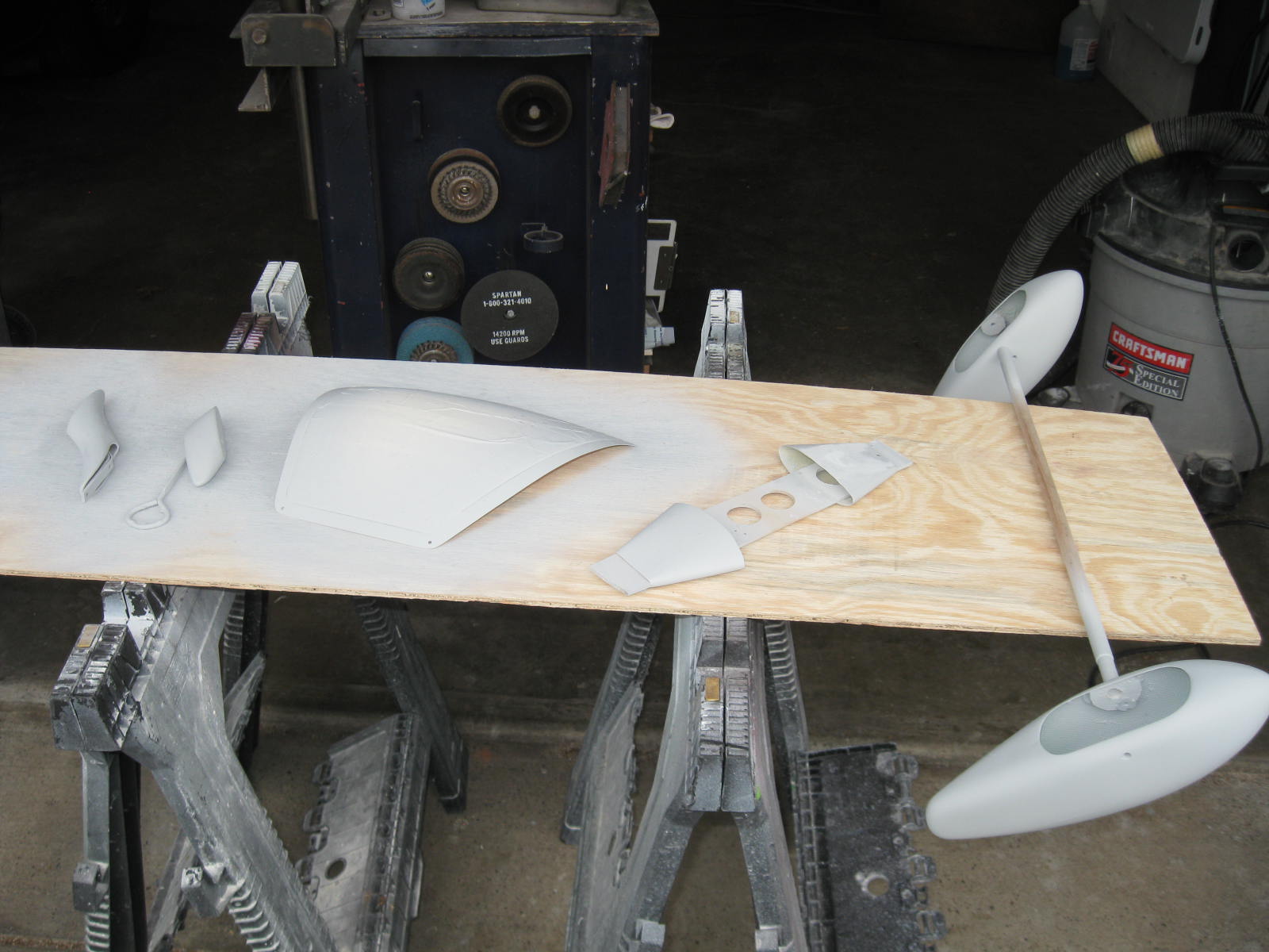

    Well I set the Champ aside for the time being and got the first coat of primer on the Glasair. I use a 1/2" pipe with the flange on one end to hold and rotate the fuslage and cowl. The flange is bolted to the engine mount, there is a wood donut supporting the cowl at the spinner opening. The glass work is very good and there are few pin holes, of course the parting line needs a little work. After two coats of primer, the parting line was block sanded and re-coated, this took care of 90% of the problem areas, need to fill the rest. I'm using U-pol Dolphin for these areas, never used it before, we shall see.

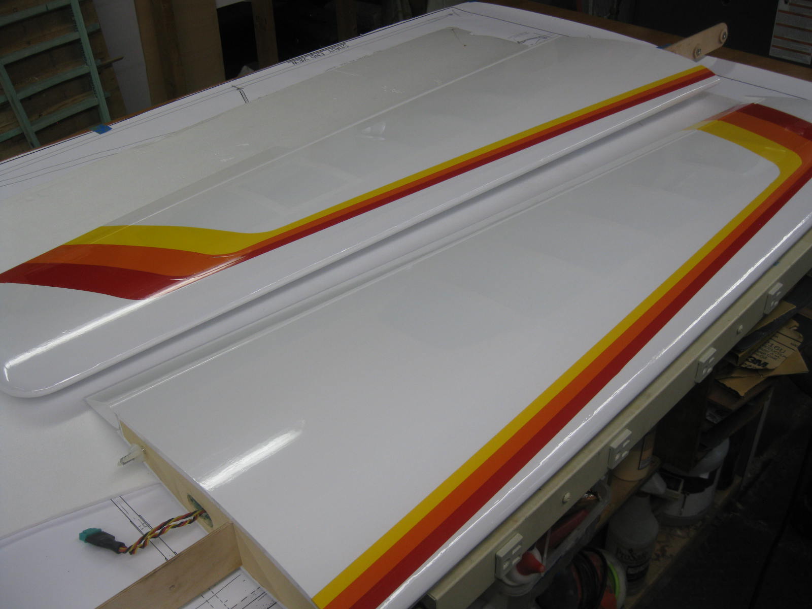

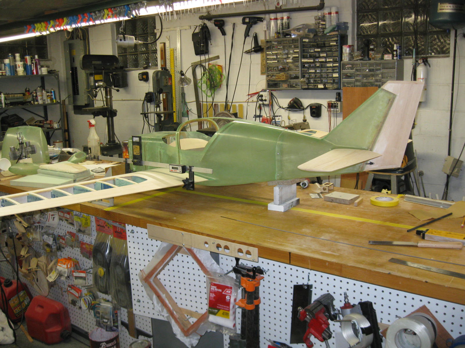

    Didn't use the Byronfoam wings or tail parts, the wings are foam rib design with plywood joiners that lap a former in the fuselage. The tail parts are balsa sheeted foam cores. Using a Valley View 40 twin for power, Hitec servos, and Frsky radio.

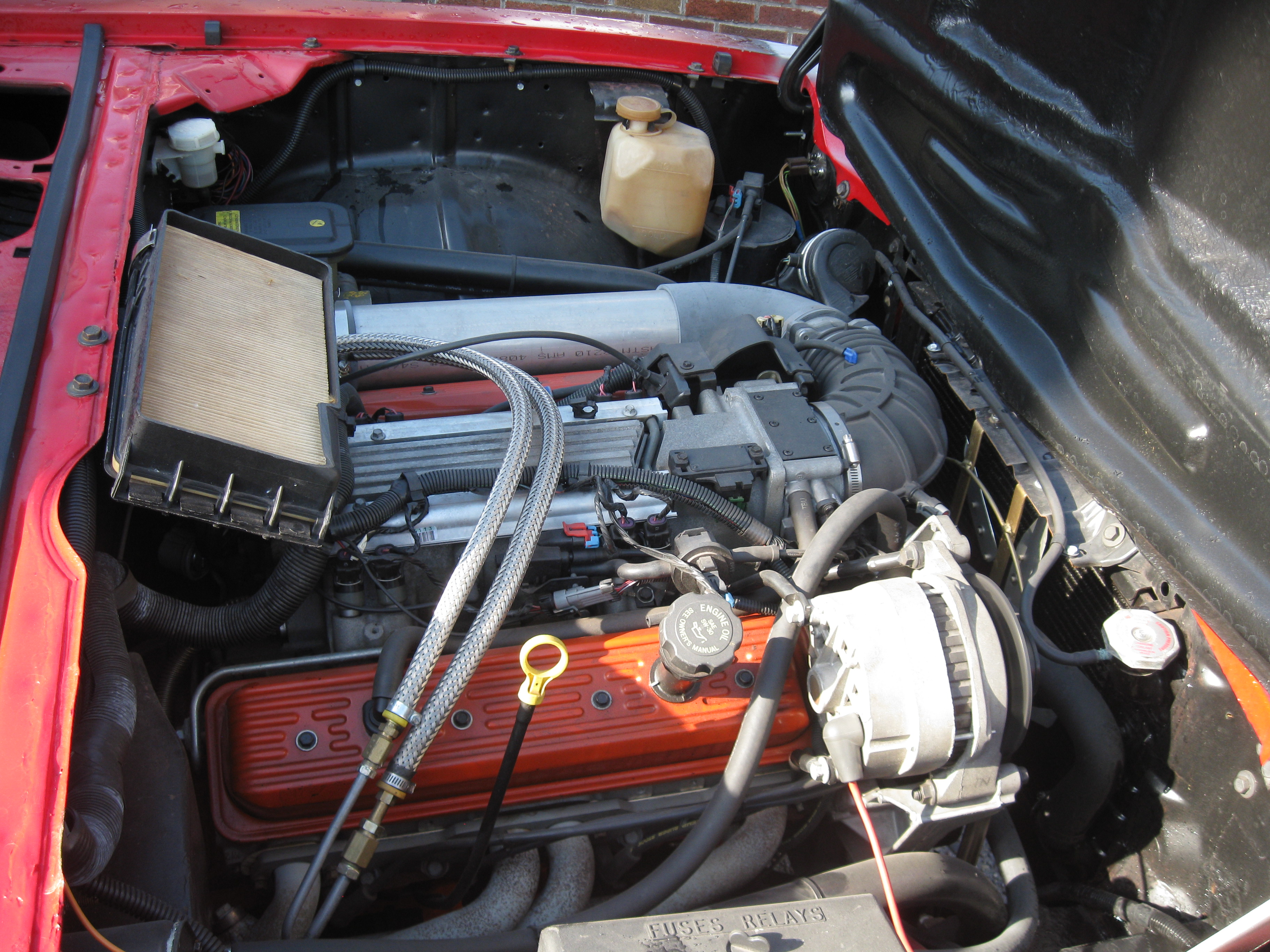

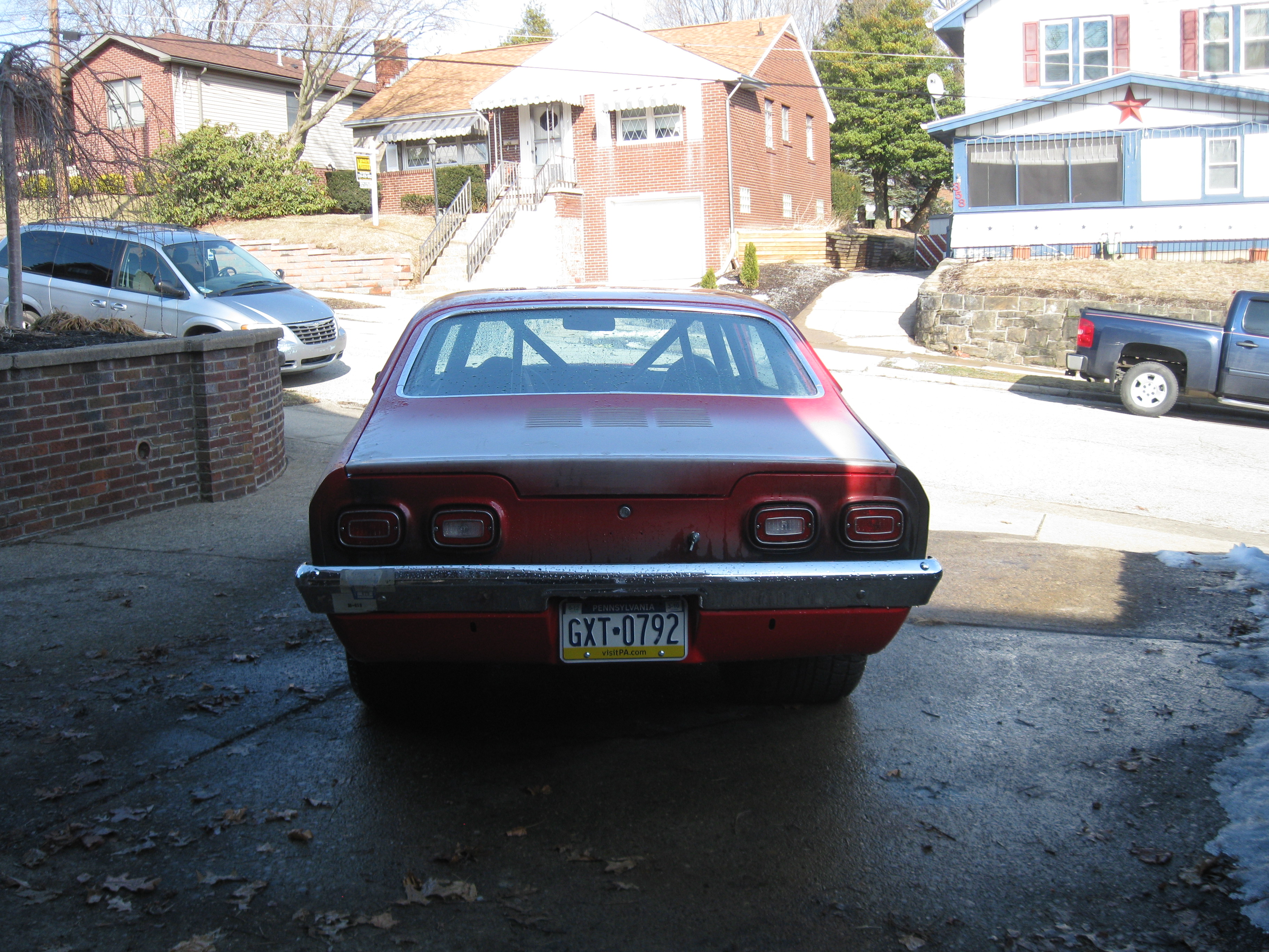

    It is a 1971 Vega with a 1996 LT1, T56, Ford 9" rear. I quit flying RC some 21 years ago to build it. I was going real well until I could not find a windshied then lost interest in getting it painted. Found a glass about 9 years ago, logged 2300 street miles since then. It's not a race car. IMG_1567.JPG IMG_1568.JPG IMG_1566.JPG
