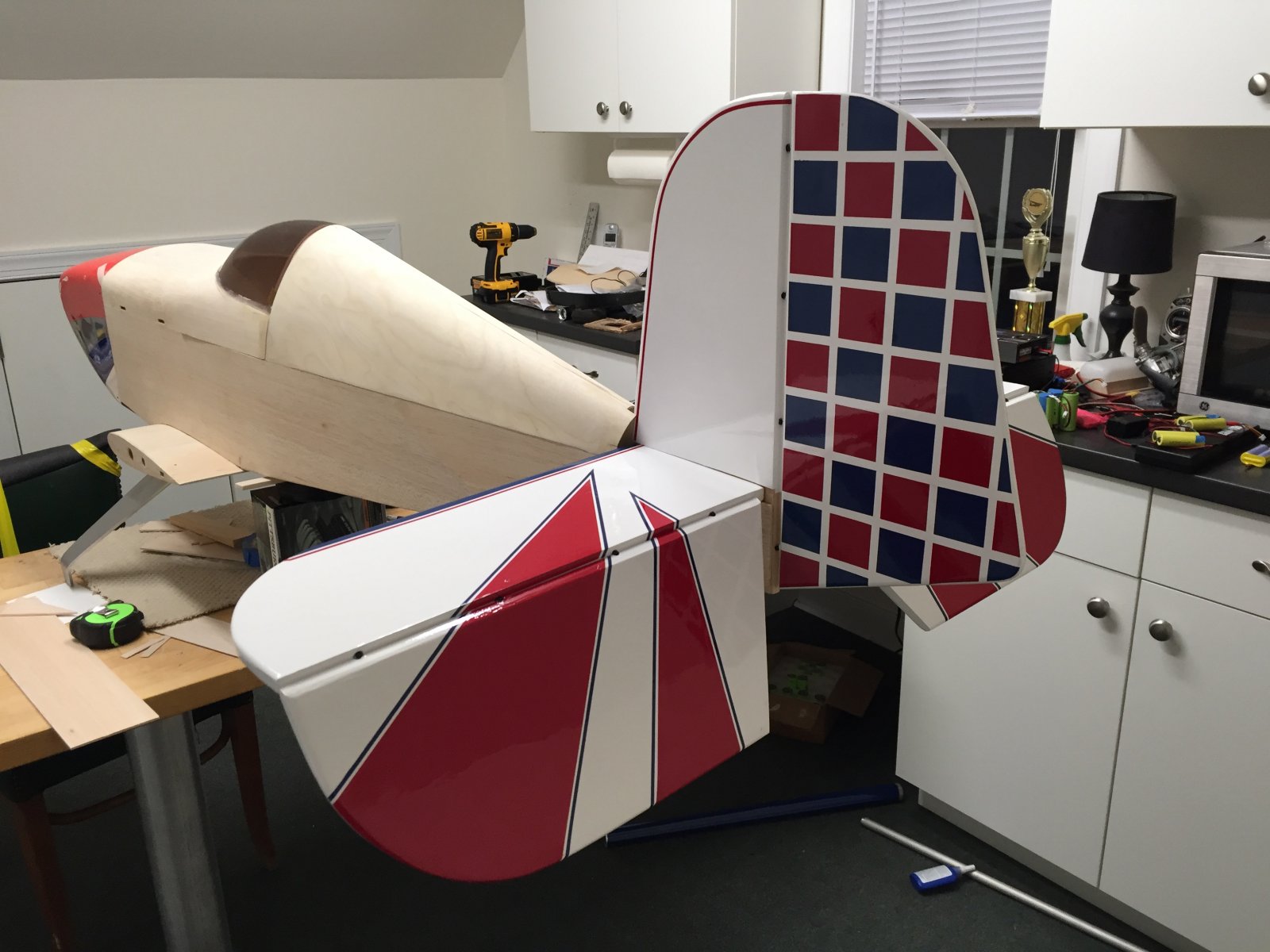

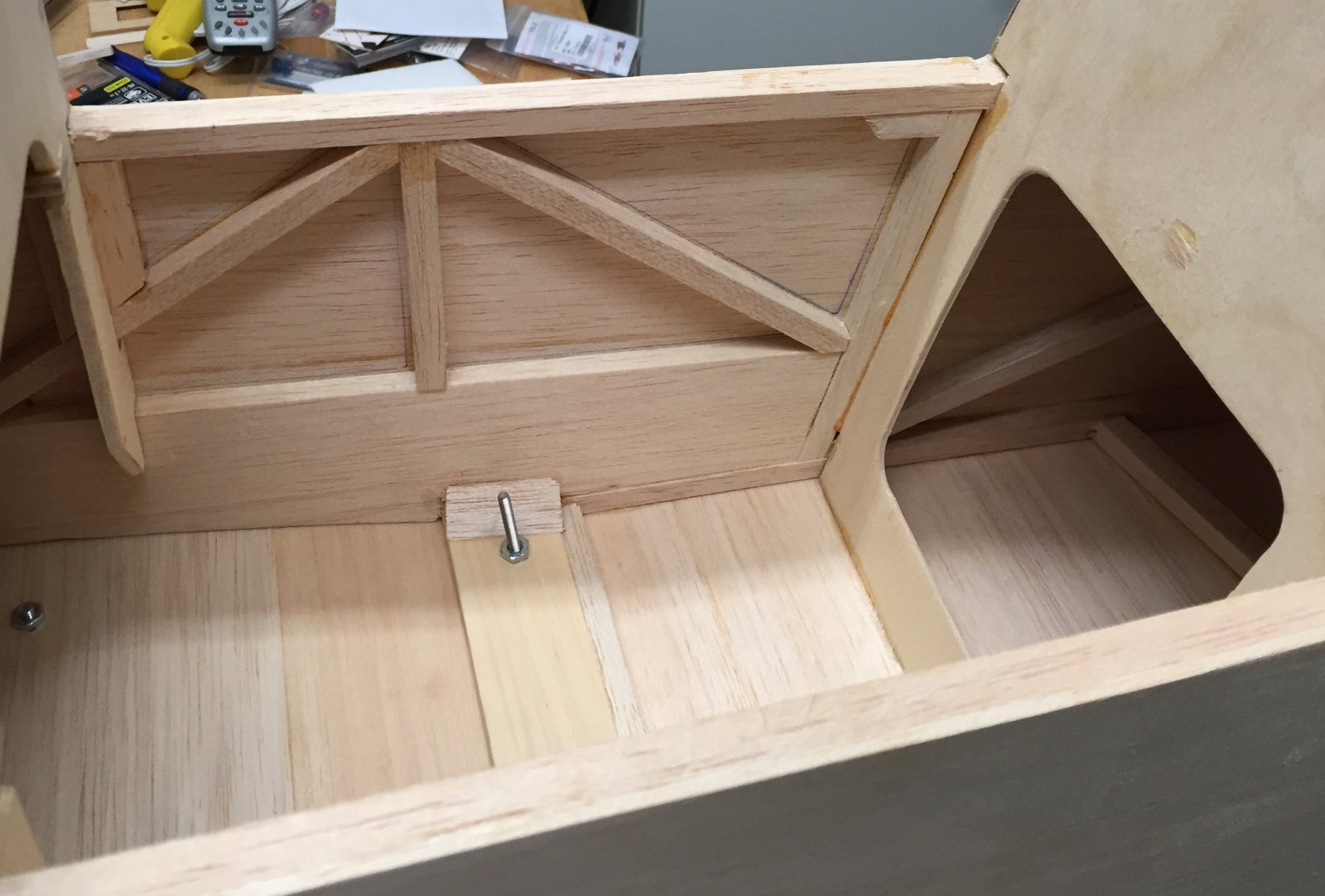

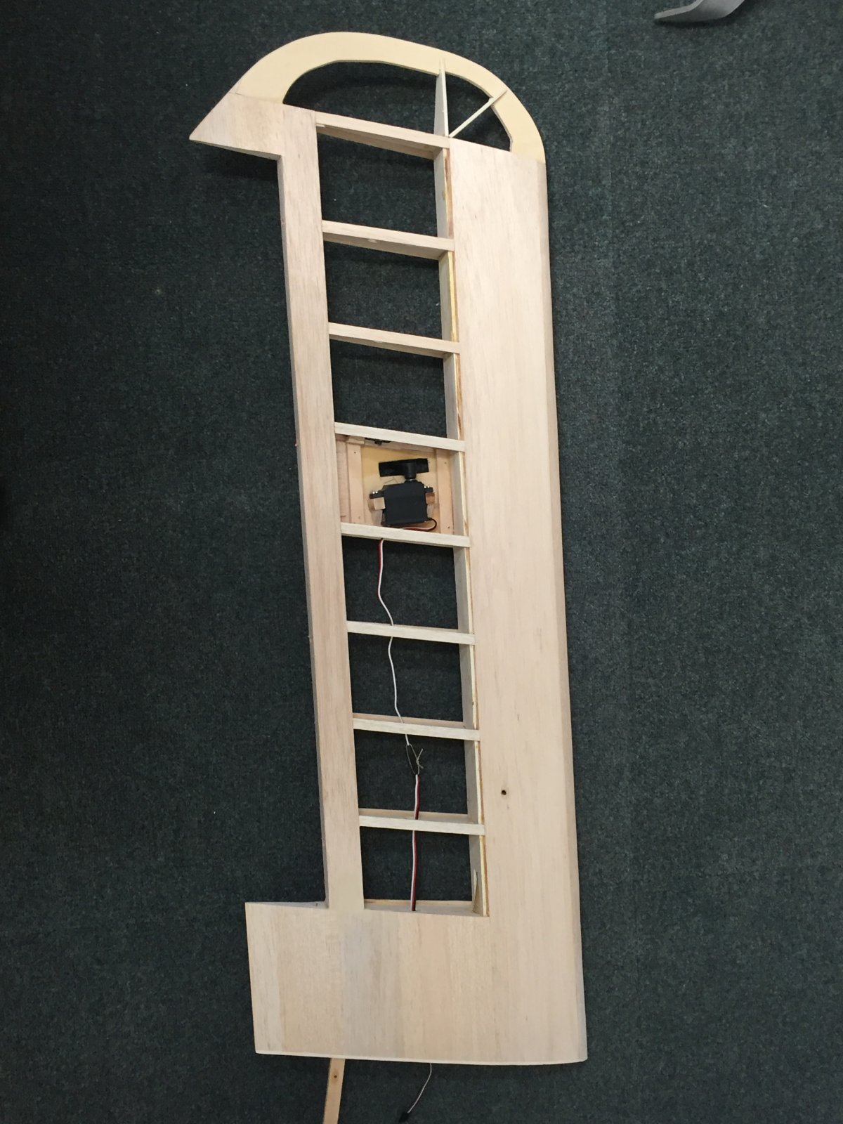

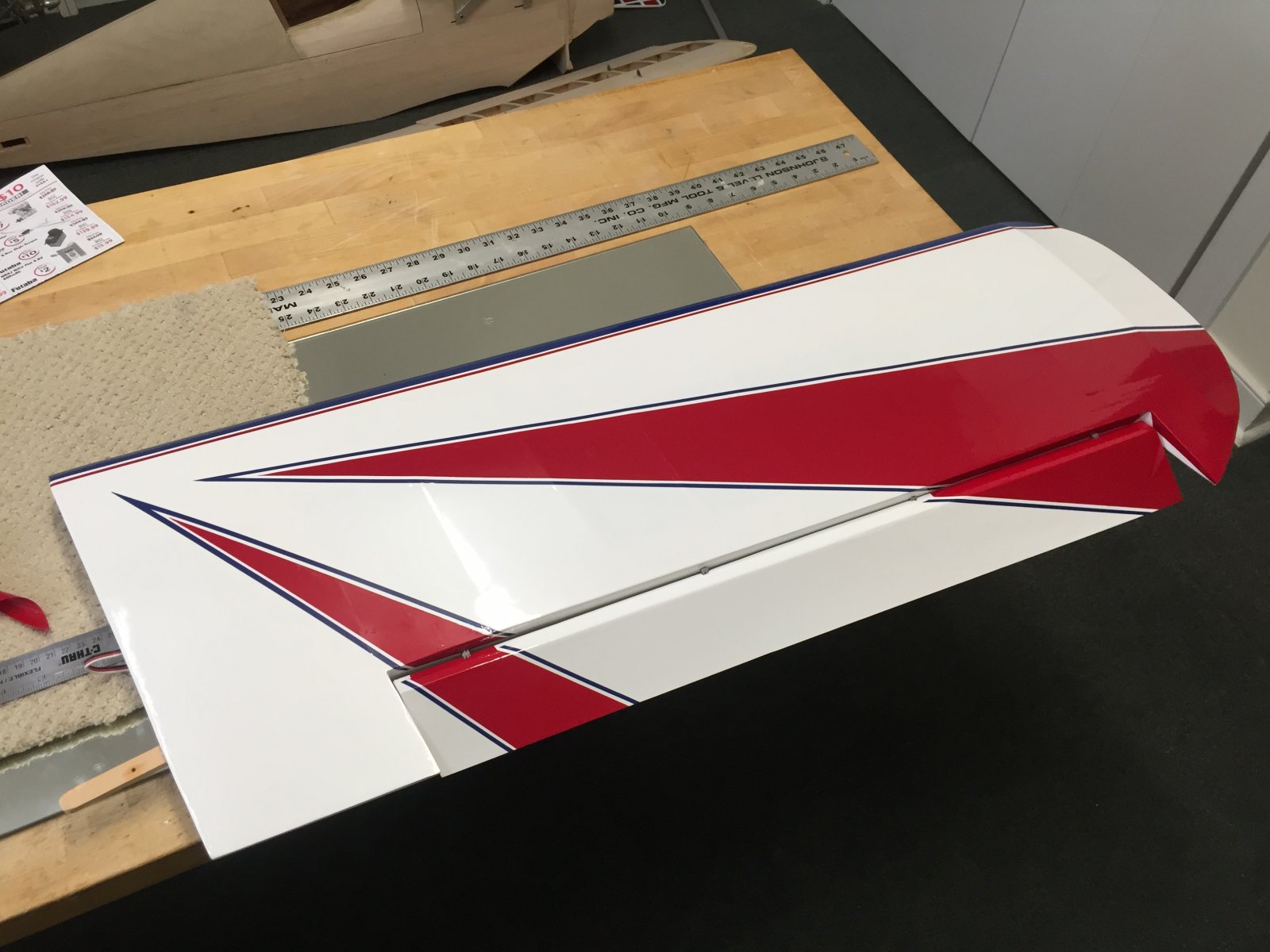

  1. I've started this project a few years ago, but since I'm now retired I finally have some time to get serious about completing the build. Years ago I had a Goldberg Bucker Jungmann with a YS 120 that I really enjoyed flying. I lost it when the elevator servo failed in the full up position. I decided to enlarge the plans about 33% to get the fuselage sized up to fit a cowl I was given from a crashed Dave Patrick Extra 330L. I later changed to a Hanger 9 Edge 540 cowl as it was a better fit. The canopy is from a 30% Pilot Extra.
    I built the fuselage in the style of Carden airframes with 3/8' sqaure stock truss sides sheeted with 3/32" balsa. The tailfeathers are stick built and sheeted with 1/16" balsa. I designed the top an bottom wings to be 3-piece so the cabanes, landing gear and center wing sections stay attached to the fuselage. A removeable canopy will enable access to the receiver and other electronics.
    Everything is framed up and I've finally started covering. I'm doing it in the classic Dave Patrick/Goldberg scheme using red. white and blue Monokote. I've had great success with the Windex method for Monokote over Monokote on this covering job. I did spike my Windex with extra ammonia and it really seemed to help.
    I have a DA 60 to power this plane. It looks like it should come in at around 22-23 lbs. rerady to fly.
    Here are a few photos I took along the way:

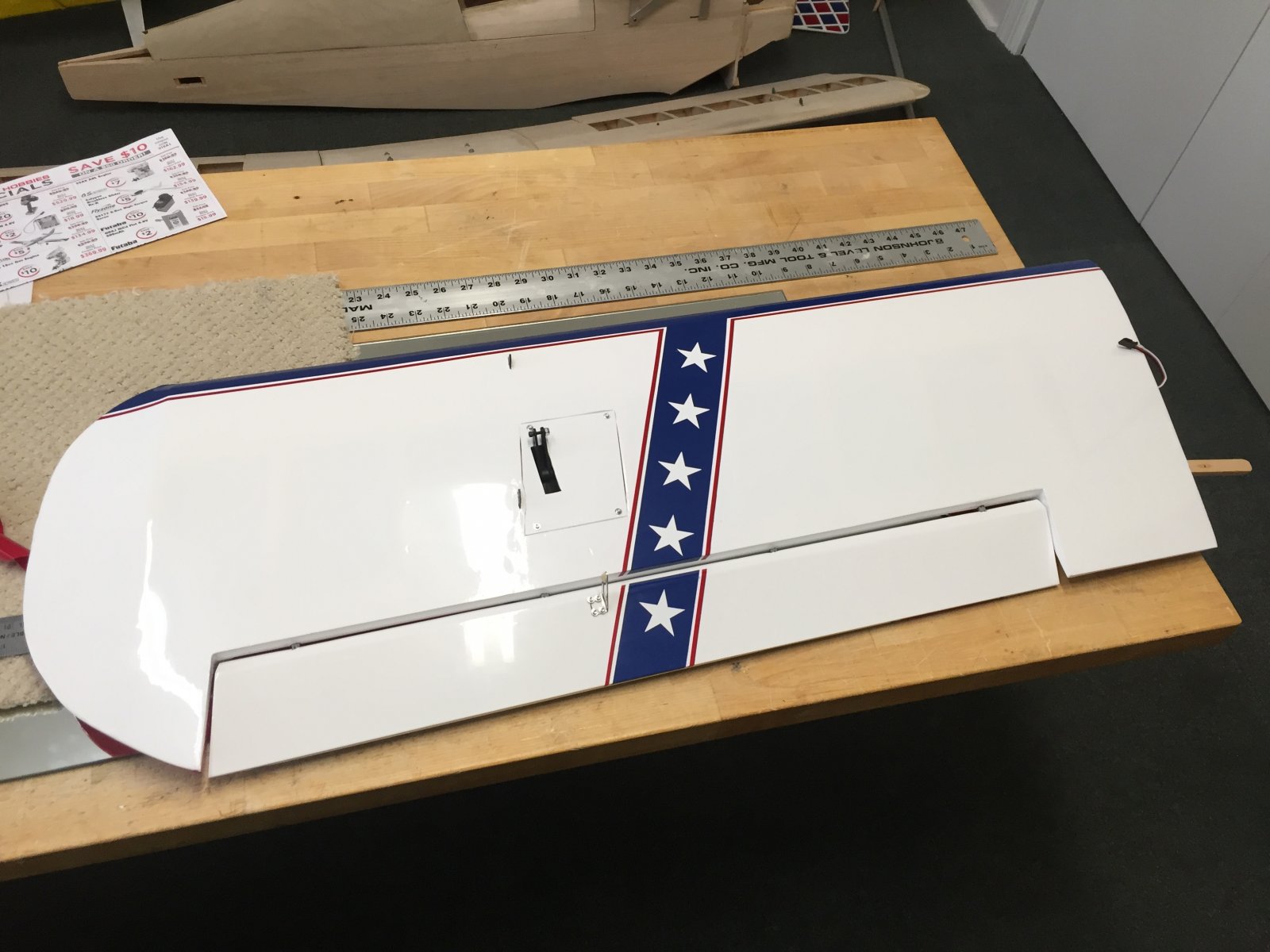

  2. Here is one of the covered wing panels.
