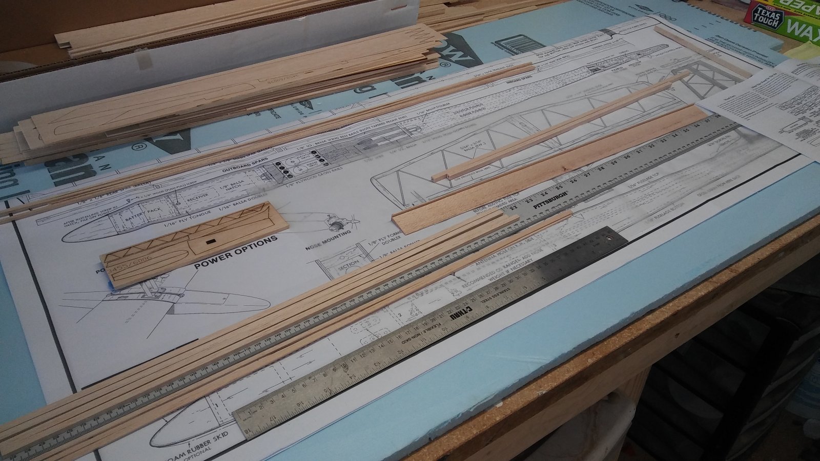

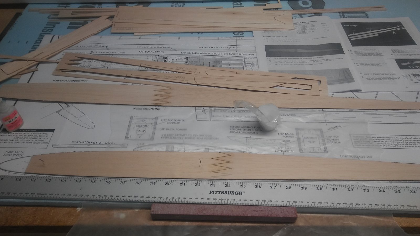

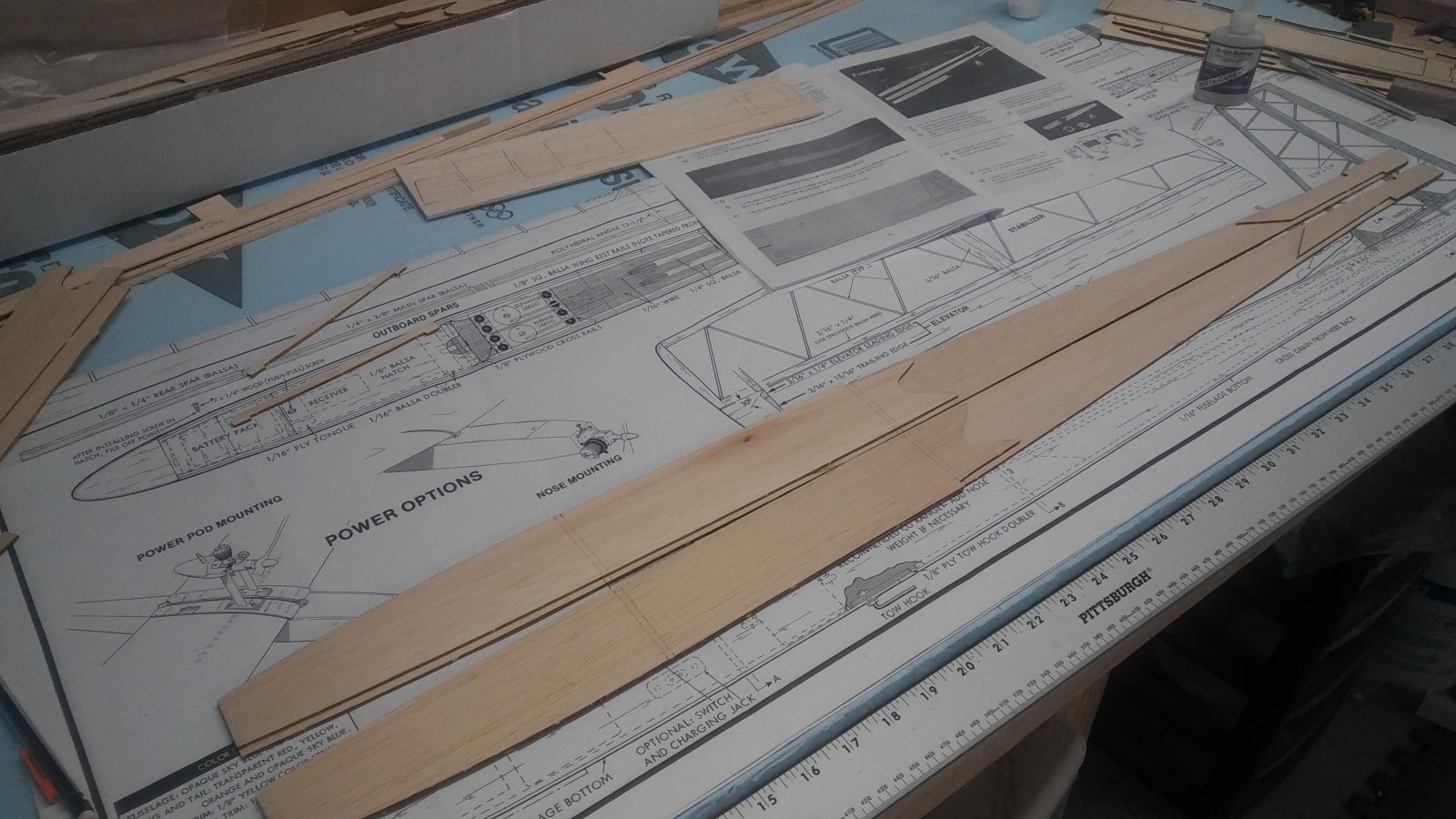

I've been wanting to build something easy, and give myself something fun to float around with, so I searched around and bought this beauty for $61 shipped from Advantage Hobby.
Went together just like I remember, except the kit is not as nice as the old die cut one. Parts don't fit as well, but it could be much worse!

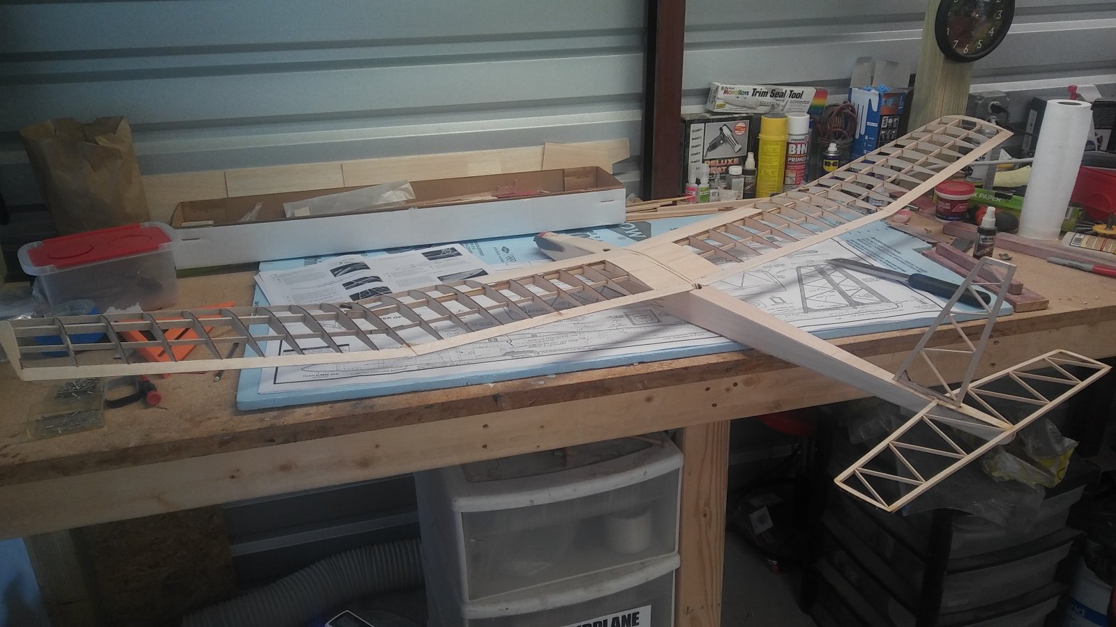

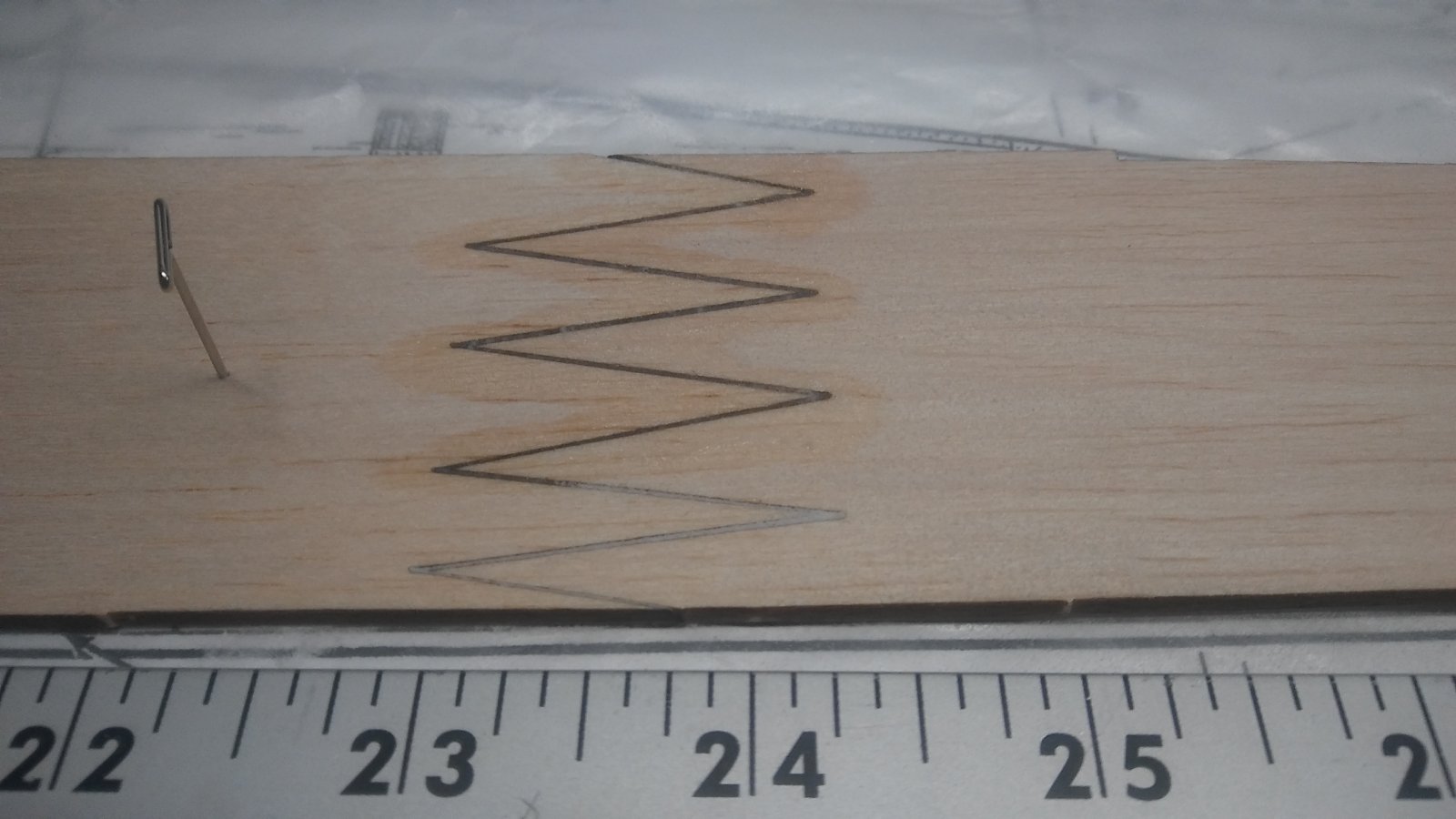

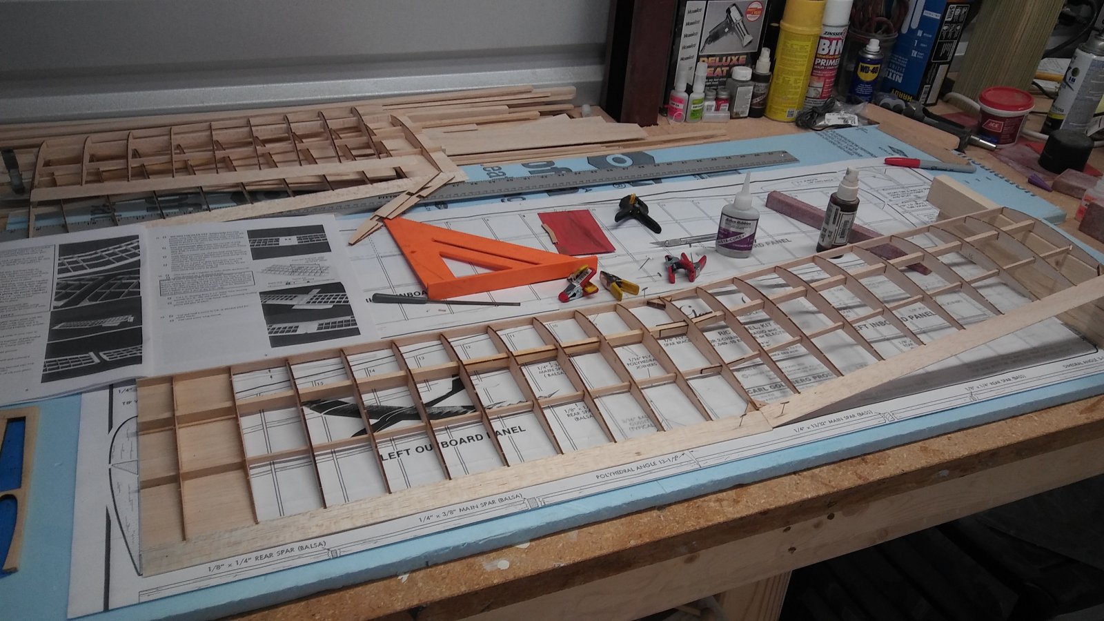

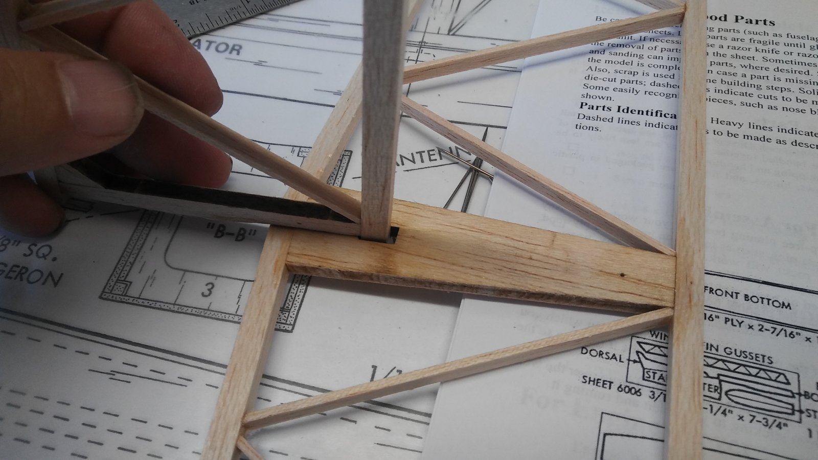

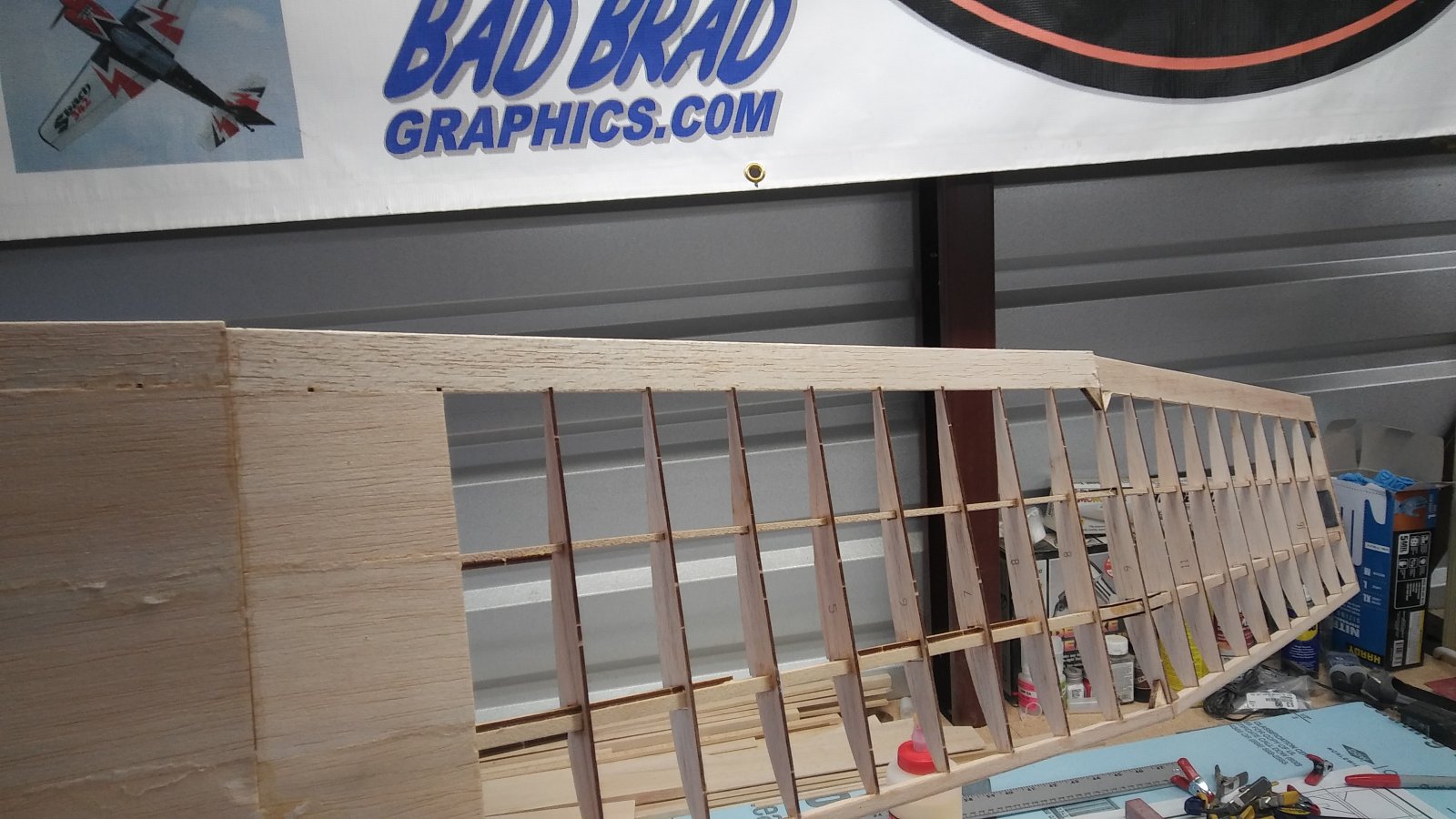

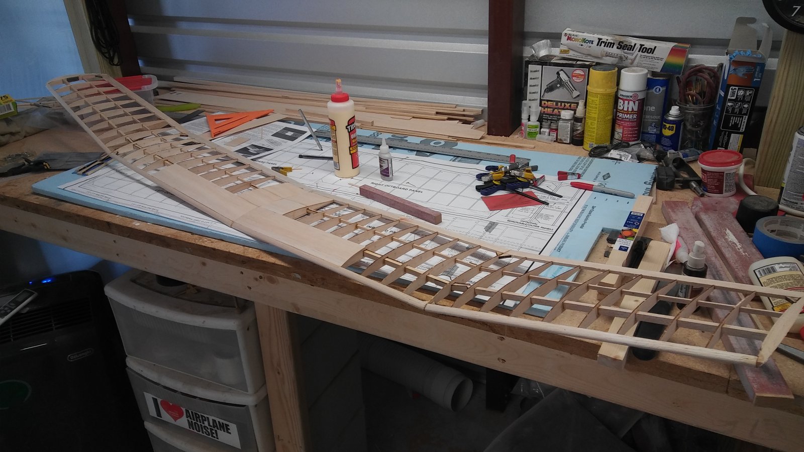

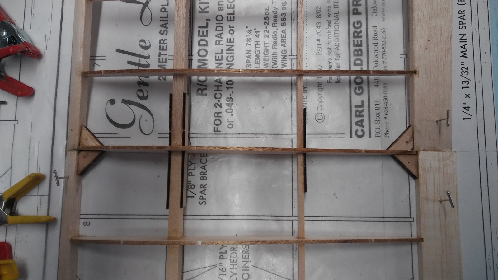

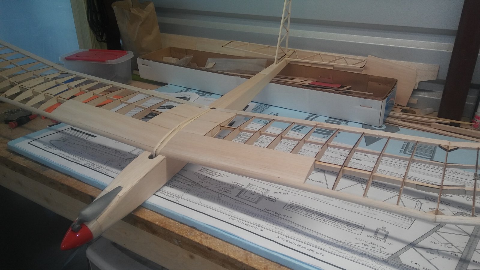

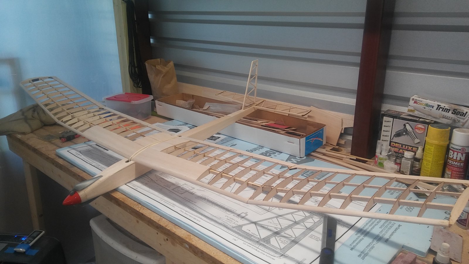

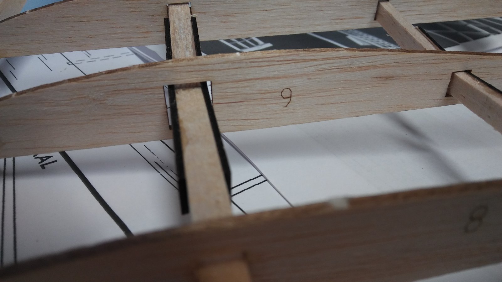

The wing came together in about 6 hours. Lots of irregular ribs, different weight balsa, loose tolerances, and the plans were about 1/4" off from the root to tip of 1 panel. Every panel ended up a little different, but some sanding should make everything alright. Had to add 1/4oz of lead to the starboard wingtip to balance the wing. I did take about 1-1/2" of polyhedral from the tips. Even with rudder only this thing should turn fine!

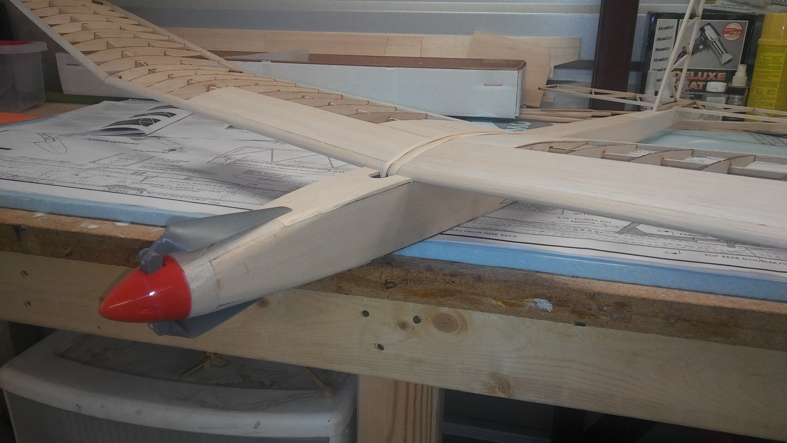

With modern technology winches and hi-starts seem like too much work! Plus, I've ballasted one of these gliders before and with a little weight they get on step and range like much higher performance sailplanes.

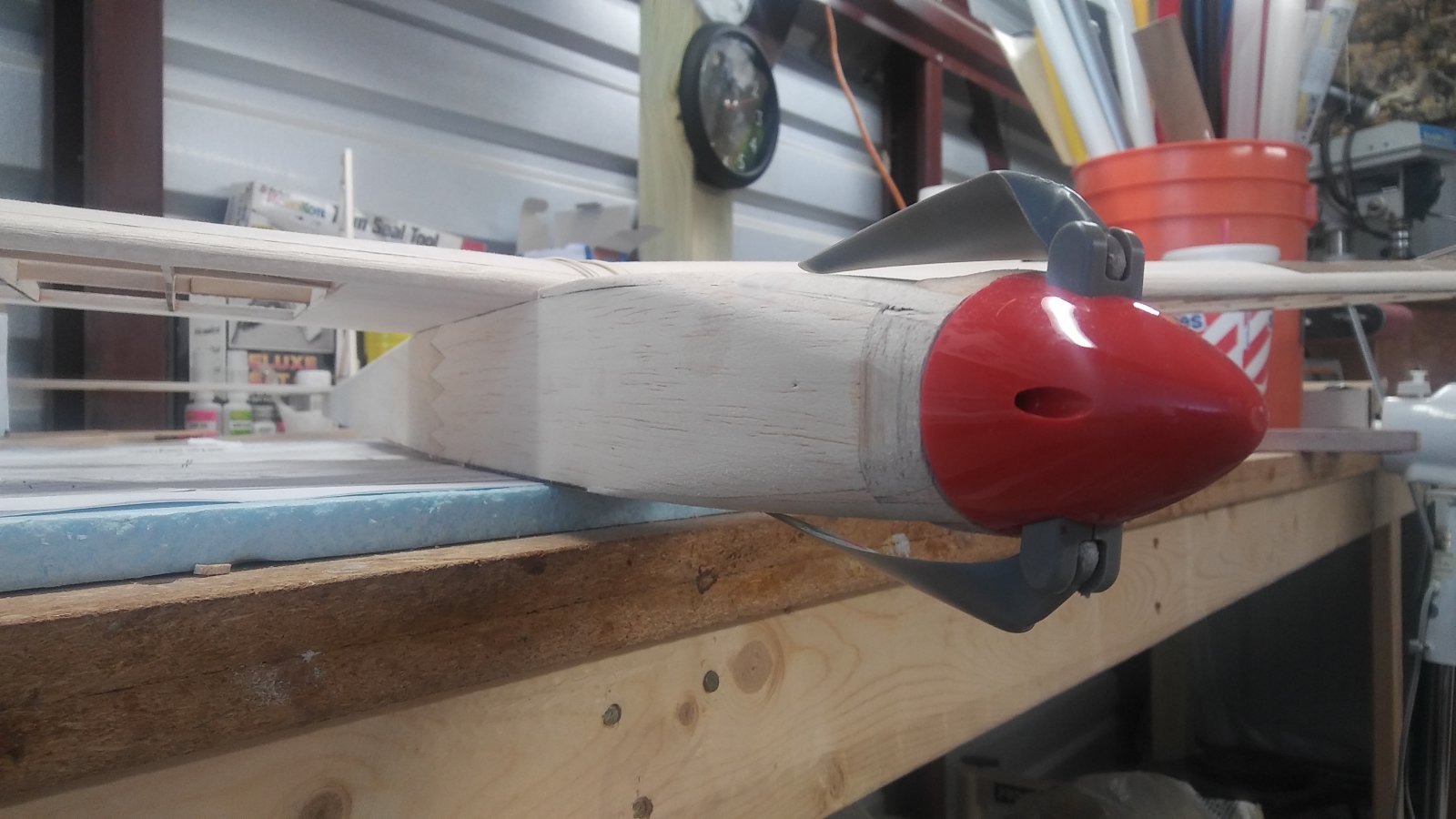

I decided to throw in a turnigy brushless motor I had laying around and bought an APC folding prop for it. I had to widen the fuse a bit and add some extra balsa on the nose to fair the spinner into the square fuse. Made the plane about an inch longer than stock. Depending in CG I might throw a couple mini servos in the tail, or an F-86 style air brake.

It's nice seeing it come together- building from the instructions and misaligned plans is more stressful than I remember! Don't want to make any mistakes! Modifying the nose for the motor and spinner was much easier for me. I knew exactly what I wanted to do lol! If I had to do it again, I would have started with 1/4" thick balsa top and bottom in the nose area instead of building up 1/8" layers.
I don't know if this is really a Gentle-Lady anymore. Might have to give her a sassier name.
