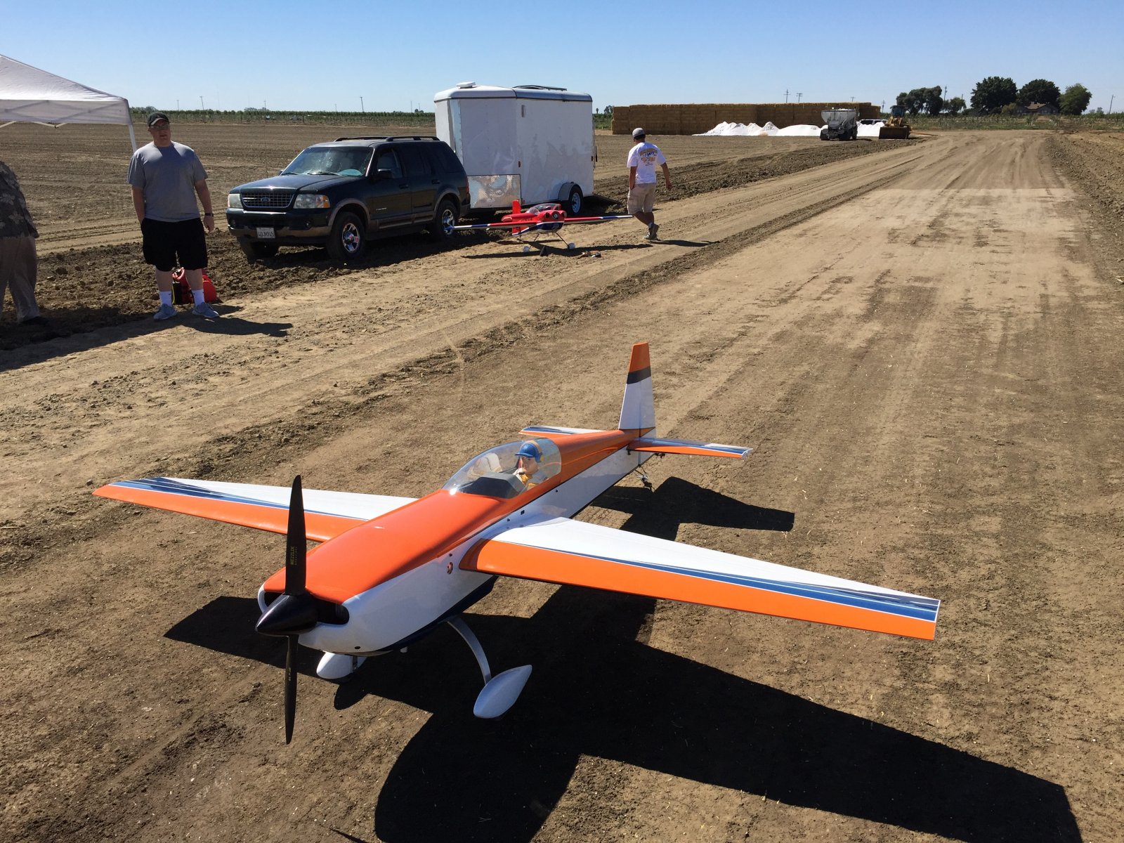

I built the 2.7m extra CS version. Has the old DA 100 on it with a Mej 27-10. Extremely happy with it. Fly IMAC with it. Will go up as long as you want it to. A little short for really power hungry moves, but more than enough for what I need. Was my first "real" build. Built a .4o size pattern plane and some scratch foam planes prior to doing it. Goes together really easy. I was a bit nervous about the foam core wings, but, now I wouldn't hesitate. Super simple and realatively quick. Mine took quite a while to finish - but I have two boys (10 and 11) - so that is where most of my time went. Here is the link to the build thread:
