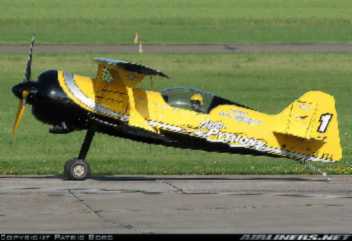

But after watching the plane fly in the air and listening to others complain, I realized the colour scheme was not for me. It's just too difficult to distinguish the top from the bottom when its flying. On the ground it looks fantastic! So I am going with a high contrast yellow black (or maybe dark green) look. I also want to improve upon the difficult assembly of the lower wing at the field.

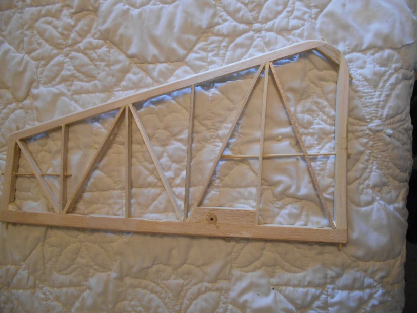

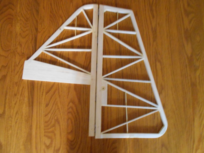

On this part of the plane Hanger 9 used flat hinges with a wire that goes thru all of the hinges. This makes it easy to do any repairs in the future, as it is easy to take off the rudder now that it can be separated from the fin. I plan to do the same for all of the other flying surfaces.

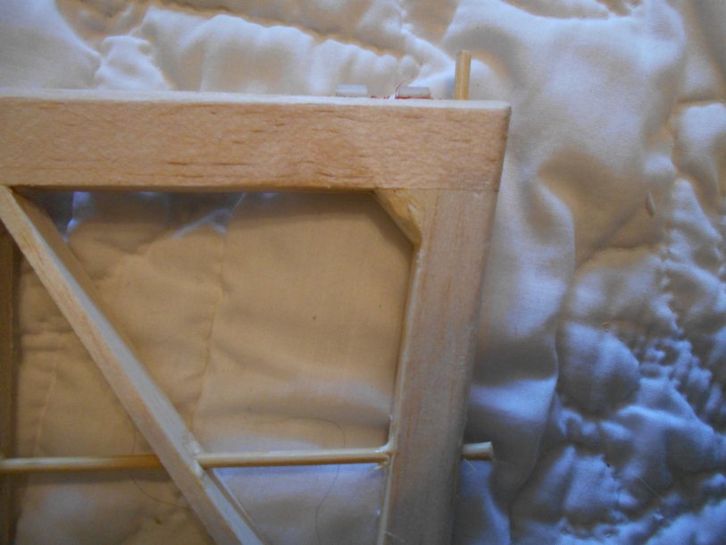

Once the covering was off, I noticed that some of the glue joints were weak, so I used some bamboo skewers and pinned the critical areas. I also used a couple to increase the lateral stiffness of the fin. The very small weight gain was easily offset in the increased stiffness that I gained.FIN and RUDDER.JPG Rudder with Pins.JPG FRONT PINS.JPG

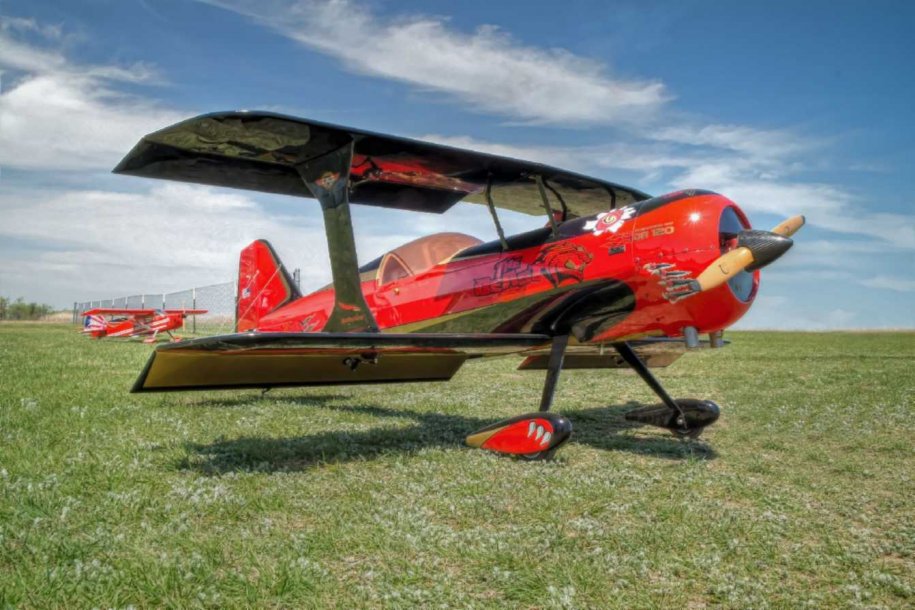

I know what you mean about the original Beast colors. Beautiful on the ground but hard to see orientation in the air, which was one of the reasons I sold mine. Fun plane to fly though!
