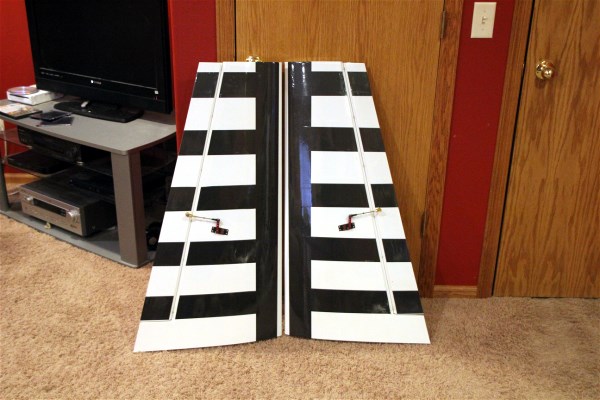

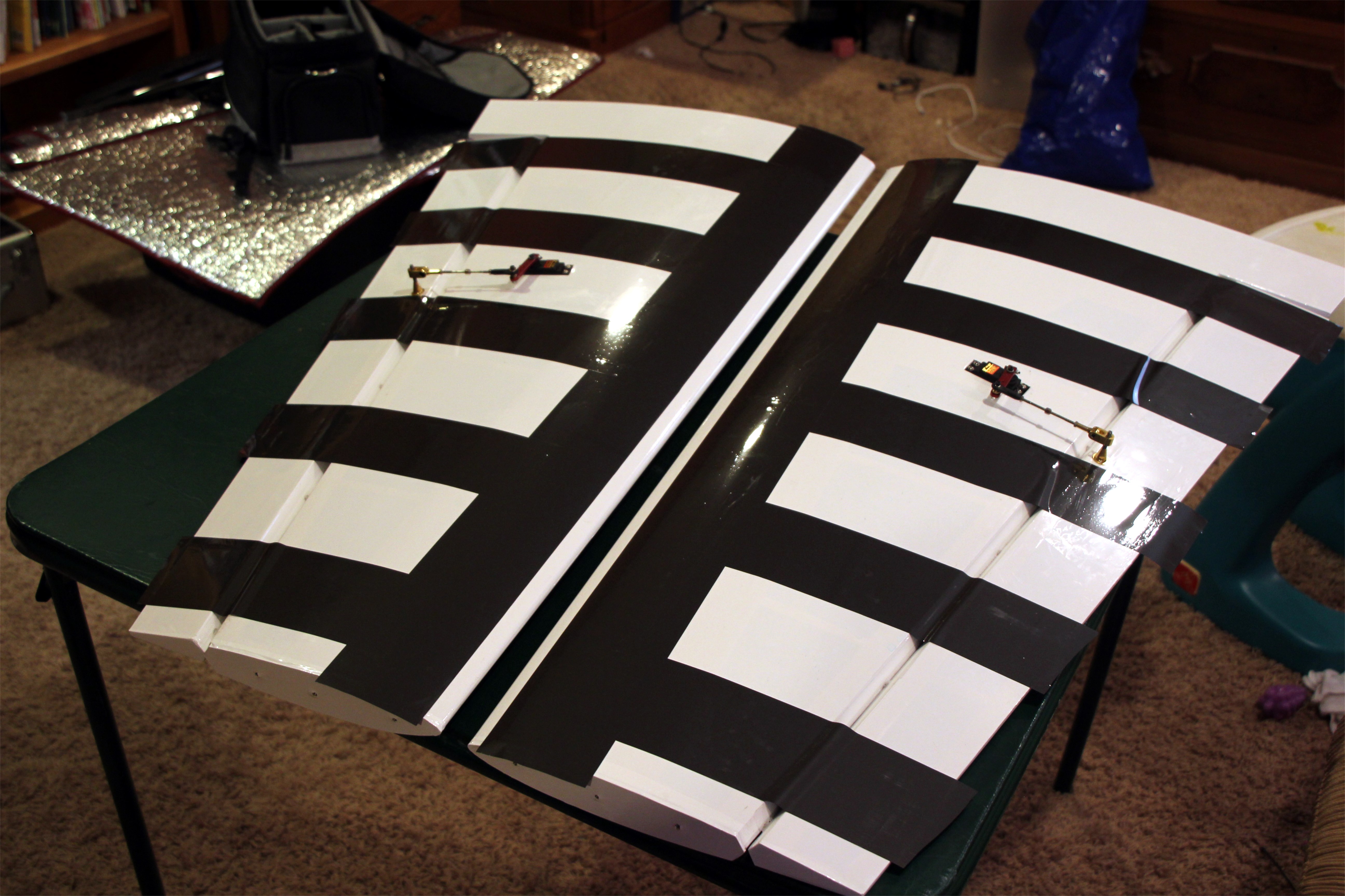

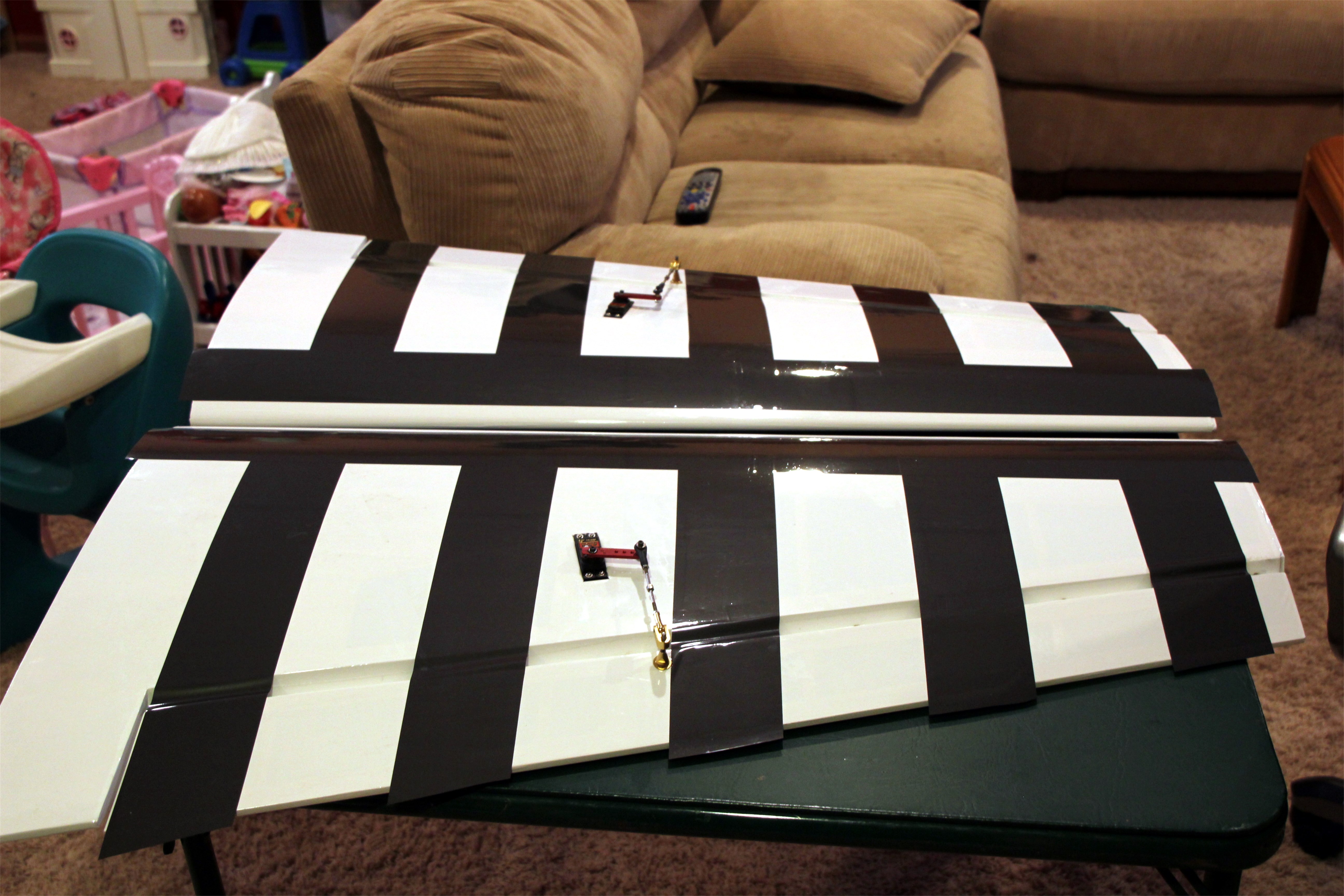

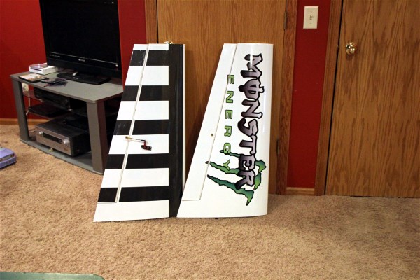

I finished up my PAU ARC late this last summer and got her in the air. I used some old black covering I had lying around for the bottom of the wings. Well, apparently it was really old as it started to peel off. While deciding what design to use when recovering, a friend said I should try the windex trick because I was using Monokote. I thought what the heck and tried it. After cleaning the wings I decided to do thick stripes with a solid leading edge stripe. I cut all the stripes and got out the windex. I spritzed the area where I was going to put a stripe and applied the monokote. I trimmed the ends about 1" past the edge of the wing so the extra would not pull it out of place. Next was to let it dry overnight.
ericb
Team WTFO
Today after about 20 hours, I tested the adhesion. It was not the best so I got the sealing iron out and went to work. I sealed all of the edges and trimmed everything. I am happy with the final results. The windex alone would not have worked for me. I did like the fact that with the windex, I was able to place everything just where I wanted it. Sealing was a breeze also as it all stayed put while I was sealing it.
