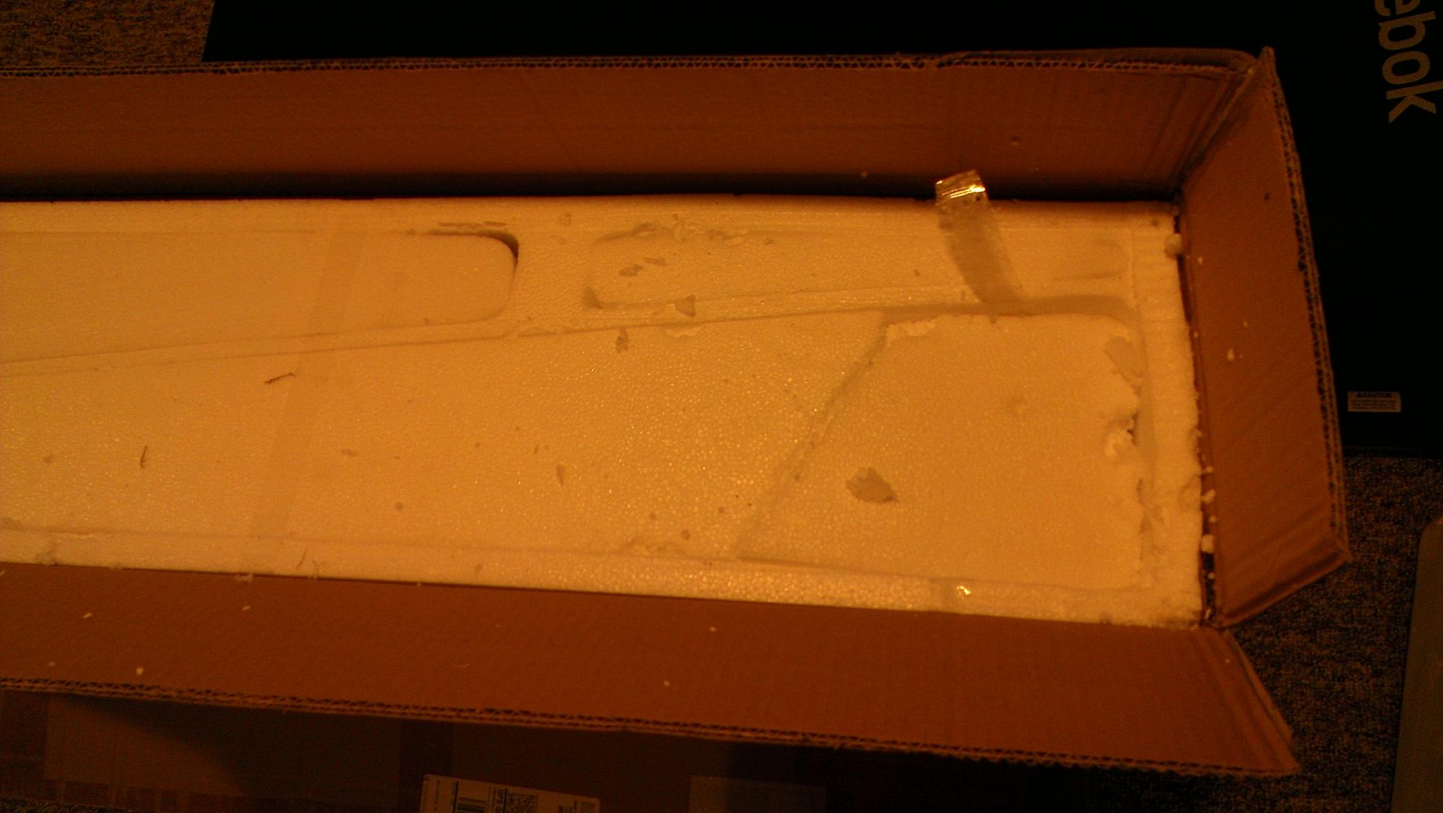

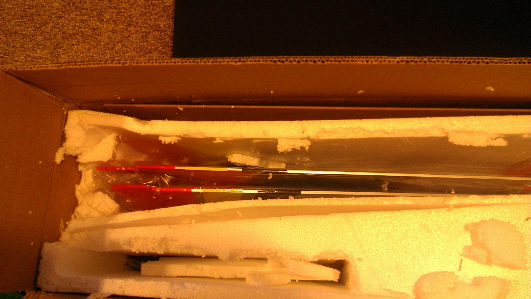

The aircraft comes in a thick cardboard box containing a custom made foam insert with compartments for wings, fuselage and control surfaces. This has to be one of the best packed aircraft we have ever seen and it should withstand even the most destructive and devious postal worker. Upon first inspection, all the parts seemed to be accounted for, with the glaring exception of the manual. It turns out that, like so many other vendors, Pilot has eliminated the paper manual in favor of a downloadable PDF version on its website. The manual is very detailed and richly illustrated. However, instead of supplying a manual for each aircraft type, Pilot RC has a single manual covering all the aircraft in the 50” class. Although the pictures are excellent and very helpful to the build, a bit more detailed description of some of the steps would be useful. Also, we would have preferred a bit more explicit information about what type of glue to use for the various steps.
We also noticed some wrinkles on the covering. This is normal for an ARF and is probably due to the fact that it was manufactured in a hot and damp climate and shipped to cold New Jersey. A quick date with the covering iron took care of it. About 300F with a sock on the iron seems the optimum temperature to work the wrinkles out.

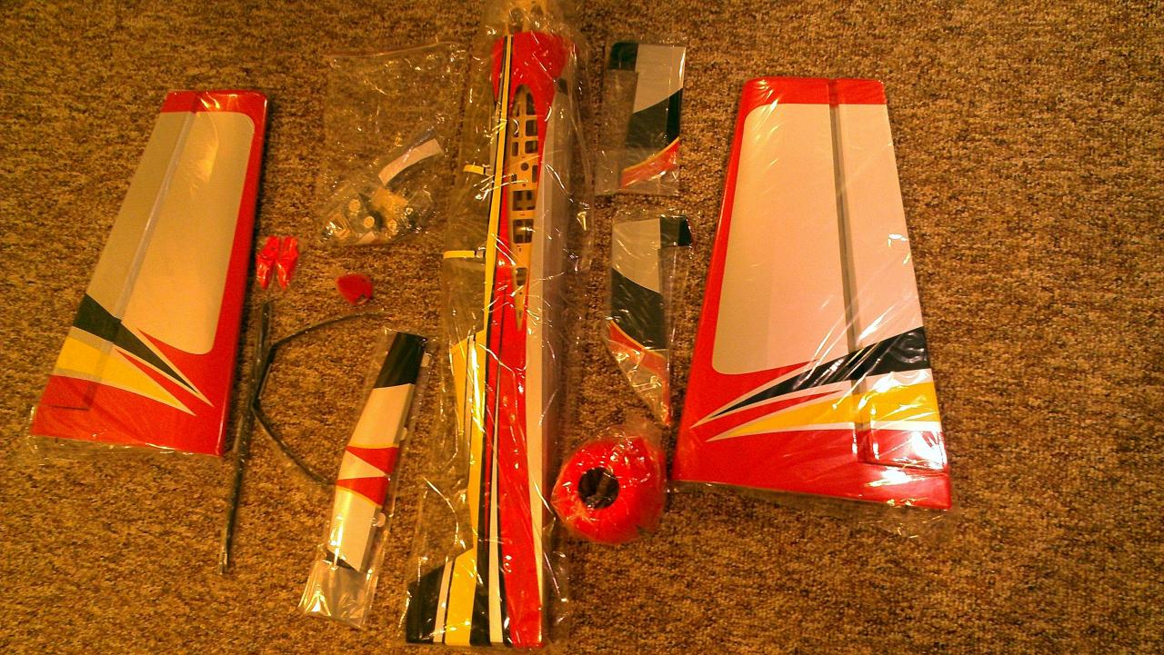

The color scheme we picked seems to have good contrast and a reasonable differentiation between the top and bottom of the wings. There are eight different color schemes available and Pilot also offers custom schemes for a fee, so you are sure to find a scheme that fits you. Unfortunately the classic and awesome Russian Thunder scheme was out of stock when we procured our plane.
In terms of scale appearance, this aircraft is more of “loosely inspired” by the full scale version than it is a true scale model. And there are probably very good reasons for this. The original Yak 54 is short and stubby and an exact scale model would probably have been very twitchy and hard to handle at 3D throws. This rendition of the Yak is considerably thinner, longer and sleeker than its full scale inspiration. Still, this is a very good looking aircraft that will definitely raise some eyebrows at the field.
Another thing that struck us is the unusually small elevator. Compared to other popular 3D models in the same size range, the elevator of the Pilot Yak 54 19% is about half the area. At first we were a bit concerned about the 3D performance of such a small elevator.

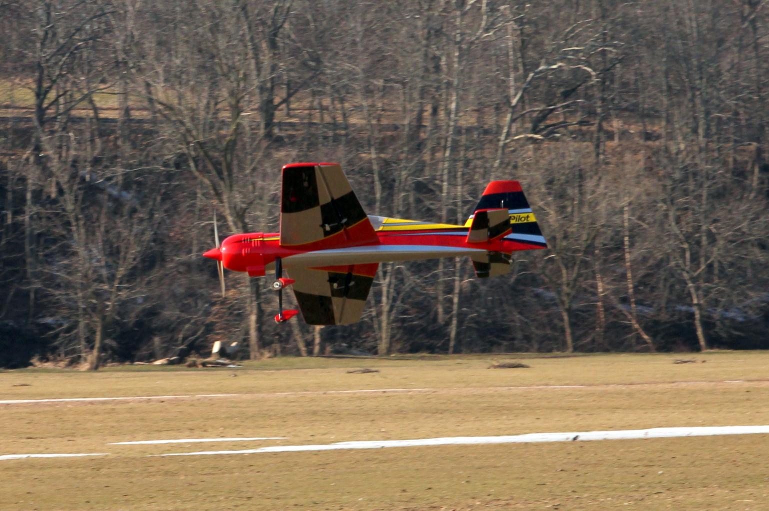

For the maiden, we had installed a 3000mAh 4s battery pack and we quickly realized (after a short but very scary tail heavy flight) that the battery needs to be pushed almost all the way forward to balance with the setup we had chosen. The good news is that this opens up possibilities for those who want to go with an even more powerful and slightly heavier power system.

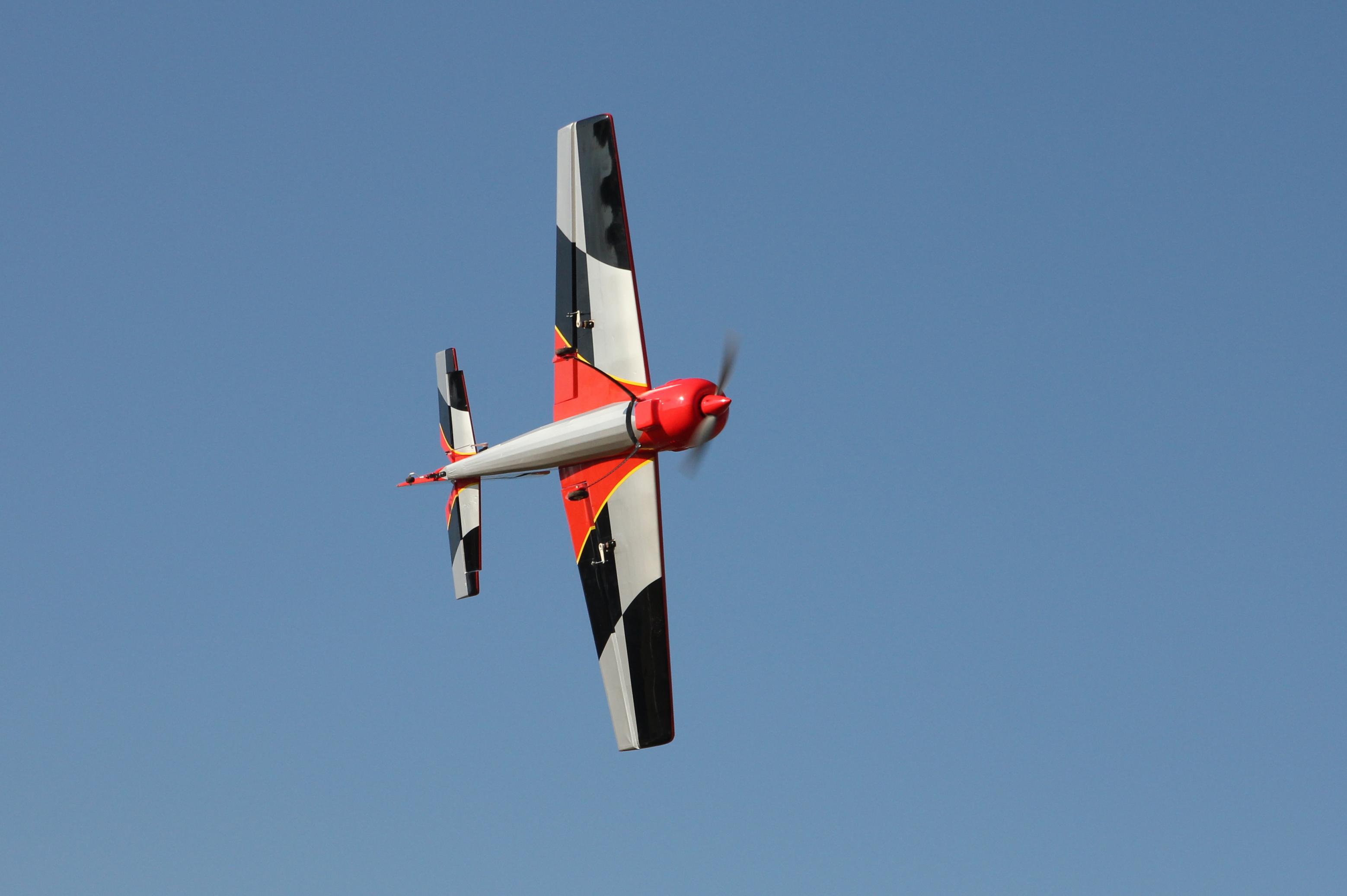

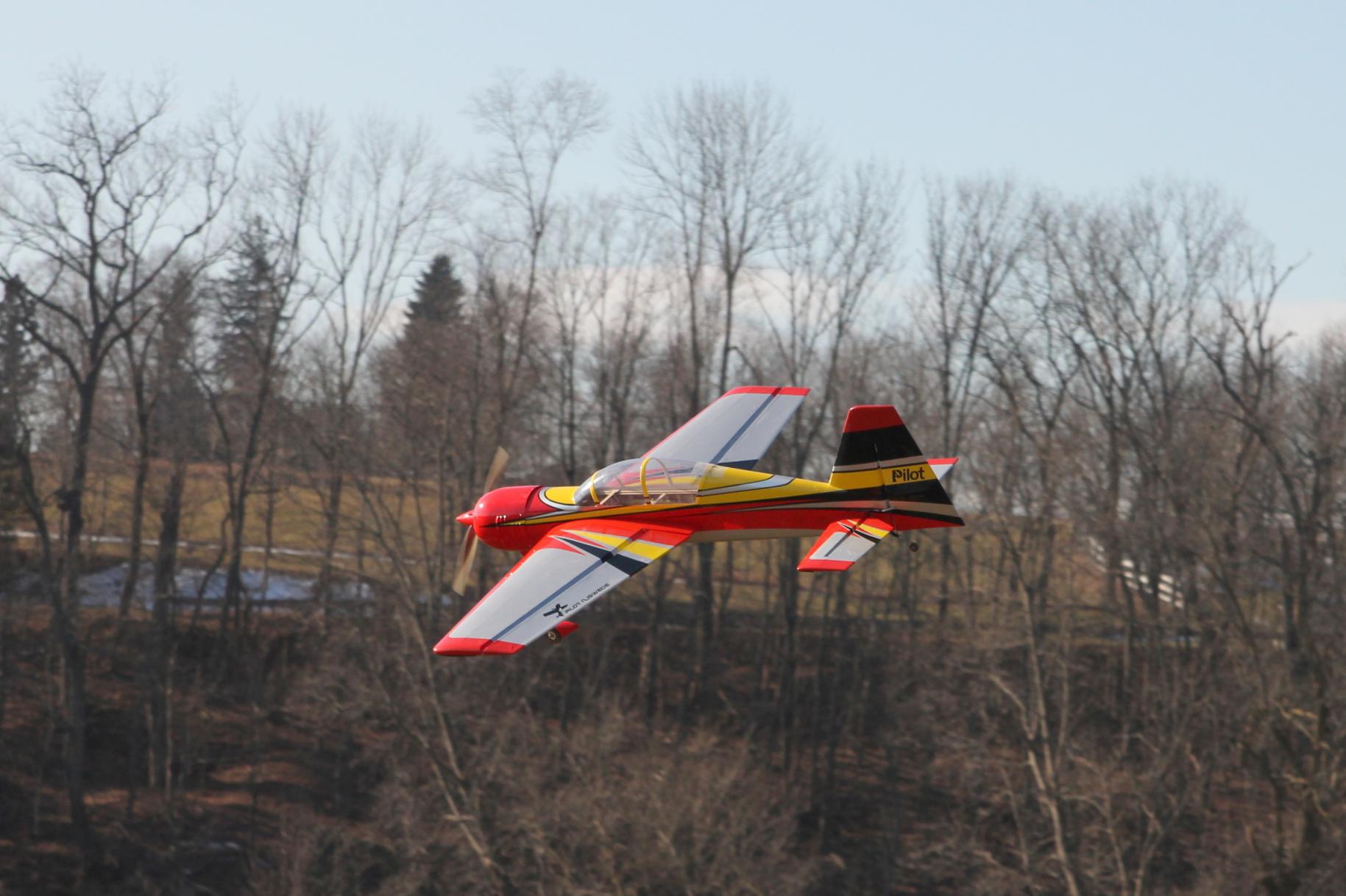

Once we got the plane balanced and applied a couple of clicks of elevator and aileron trim, the plane was tracking very nicely and showed great control authority. In fact, the aileron response is so violent that we may have to turn down the high rates a bit. We ended up flying it at 70% rates and that was about as much deflection we dared to give it. The rolls are just of of control violent!
Spins and blenders are done with ease. In fact, the blender was extremely tight and perfectly axial with the plane spinning around a point right under the canopy.
When we did our flight testing, the wind was gusting up to 15-20mph, which made it challenging to determine stability in harrier and hover flight. However, elevators are very crisp and the harriers we were able to do didn't show any signs of wing rock. But it was fairly hard to tell, as the plane was tossed around in the turbulence quite a bit. Also, as far as we were able to tell, elevator response is very good even in stalled flight. In fact, the plane was able to maintain nose-up attitude in an elevator maneuver with about half elevator and maybe 10-20% throttle.
There was some coupling in KE flights, which is to be expected with a round fuselage. However, due to the gusty winds and turbulence, it was hard to determine what was coupling and what was just the wind pushing the wing area of the plane.
Since the weather conditions were not optimal during our test flight, we plan to do another round of flight reviews. However, what we were able to see so far was very promising!
The stock wheels and pants adds to the characteristic Yak look, but don't work that well unless your runway is paved or smooth as PGA tour golf green. For better performance on grass, you will probably want to modify the landing gear by changing to bigger wheels and getting rid of the wheel pants.
