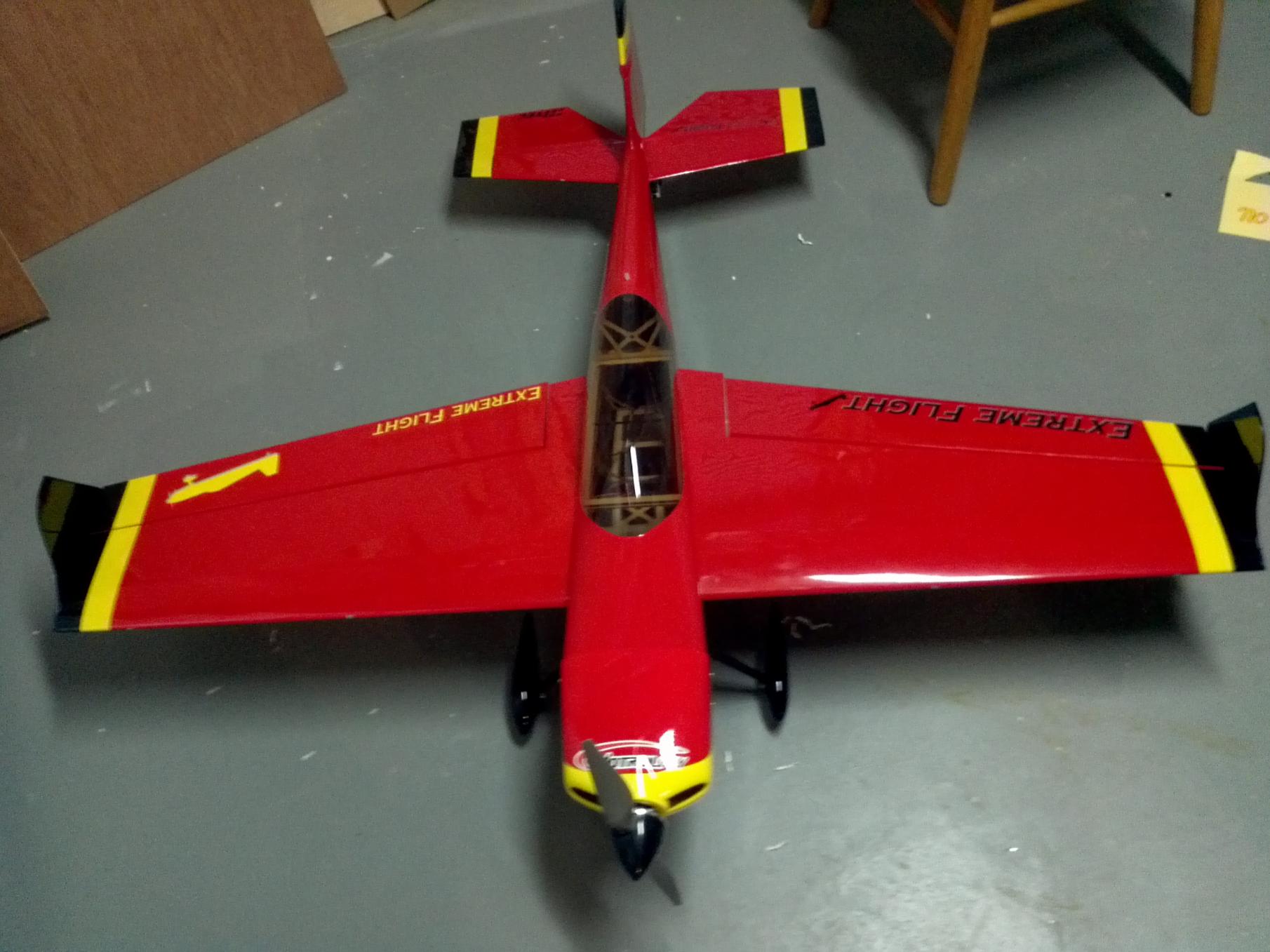

Well, crashed my EF Yak back and SEFF and finally managed to get the replacement assembled and about ready to go. Just need to set the throws and wait for the crappy weather to pass. :)
Did not realize EF had switched to ball links even on their small planes. Very stoked about that. It's got a Motrofly 2820-750 and ZTW 60A esc. The Motrofly appears to be of better quality than the Torque motors I've had so looking forward to flying it.

I flew mine with the same ESC and motor.... what an awesome combination! What servos did you use? I put a hs-85mg on the tail of mine, as the savox SH-0255's keep frying back there... probably too much mechanical force required on such a small gear train.
Not sure if you took pics during the build, but it'd be great if you could write a mini-review!
-G

I've got one of the Edges too.. fantastic! I had the same motor in mine but have recently put the DM2820 in another model and put a DM3615 in the Edge. It goes great with either motor but the 3615 is just eye poppingly powerful:veryshocked:
The Edge must be the easiest plane to fly post stall that there is out there, you will love it. Just to add confusion to the servo choice debate I've been running a Savox SH-0255 on the elevator of my edge since I built it a year ago, it's been my 'go-to' model so gets flown most weekends, the servo hasn't missed a beat.
A couple of things to check before your maiden:
  • Make sure to generously CA around the motor mount plate, especially where the plate fixes to the rear former. This is the only slight weak point in the Edge's design so don't omit this step. If flying from a slightly rough grass strip you might want to put a strip of wood in to gusset the joint or use a strip of glass cloth and resin
  • The CG range in the manual is a bit tail heavy for most people. For the maiden don't put the CG any further back than about 90mm (3.5") from the LE. Your battery might have to slide well forward to achieve that CG, but so be it.

No pics on the build. Only eventfull thing that happened was the one blind nut on the wing for the wing bolt kept stripping the nylon thread of the wing bolt. I had no thread taps but luckily still had the metal wing bolts from the crashed Yak. Used one of them to clear the threads and then the nylon wing bolt threaded in ok.
I just recycled my servos from the Yak. Pretty sure they are HS-65HBs all around. We'll see if they have any strength issues show up. Doubting it since I usually fly more aerobatic precision than anything 3d. The HS-65HB's have the same torque specs as the recommened HS-65mg but just not metal gears. Should be fine.

Beware of non metal gear servos in the EXP series aircraft!!!!! Not listening to this advice has caused the loss of several of these models. The Karbonite gear sets simply won't hold up to the forces placed upon them by the huge control surfaces. Trust me on this one and save your new Edge, PLEASE!!!
