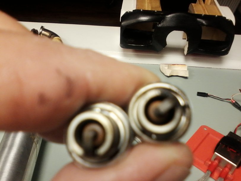

Been running Redline 32:1 in my DA120 and it does fine. 22 gallons so far. Running same in my new 70 and it's doing fine.
After about 7 gallons the 120 broke in and the plugs looked like a light gray color from the aluminum deposited on them from break in. Here are the plugs that replaced them. About 15 gallons on them. I also run standard 87 octane pump gas.
