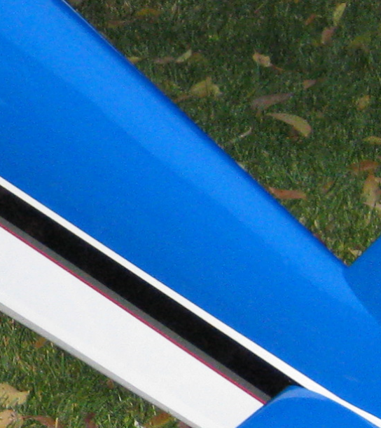

View attachment 4105  Sheeted surfaces however can present a numerous amount of factors to be considered. A stripe or a different color upon first layer, seams, or just simple single layer such as sheeted wings or stabs, fin...etc, are really a little different story. I use my iron with the sock on it. So as to protect from dulling or scratches and what not. Typically warmer than just warm to the touch. Almost, but not quite hot. Kelly suggests 350 degrees. That is a good number but remember Ultracote will usually stretch or shrink at a much lower heat setting than Monokote. I use a "COOL" damp soft cloth. I will address the wrinkle, bubble or sun blister which ever it may be by applying the heat gently... smoothing from side to side to allow the covering to absorb the heat evenly. Moving my iron off the covering then gently "swiping" the damp cloth across the heated area will cause it to "SUCK" right back to the surface. The adhesive on the back side grabs ahold of the wooden structure and the dampened cloth cools the covering without allowing a new wrinkle or bubble. After the first season of hot summer sun and 50 flights, my 260 had developed some fairly sever "sun" wrinkles on both sides of the turtle deck and sheeted portions of the wings. Remembering this procedure from previous models that exhibited the same issues, I preformed the same procedure on the 260 with perfect results.
