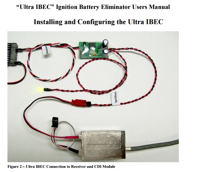

Here is a picture from the manual that will help with your question. Looks to me (I haven't setup an IBEC before but looks simple enough) that you need the battery to the switch then the switch lead to the battery input on the rx. The IBEC is plugged into the RX. Here is some info from the manual.
The Ultra IBEC plugs into a spare receiver auxiliary channel and provides power to the CDI ignitionmodule, while safely isolating the receiver and servos from high frequency ignition noise that may bepresent on the wiring path between it and the CDI module. It can also be connected to power busexpander products, provided that an auxiliary channel capability is available at that connection point.
Link to Manual: http://www.tech-aero.net/ultra-ibec/UltraIBECUsersManualr2.2.pdf?attredirects=0

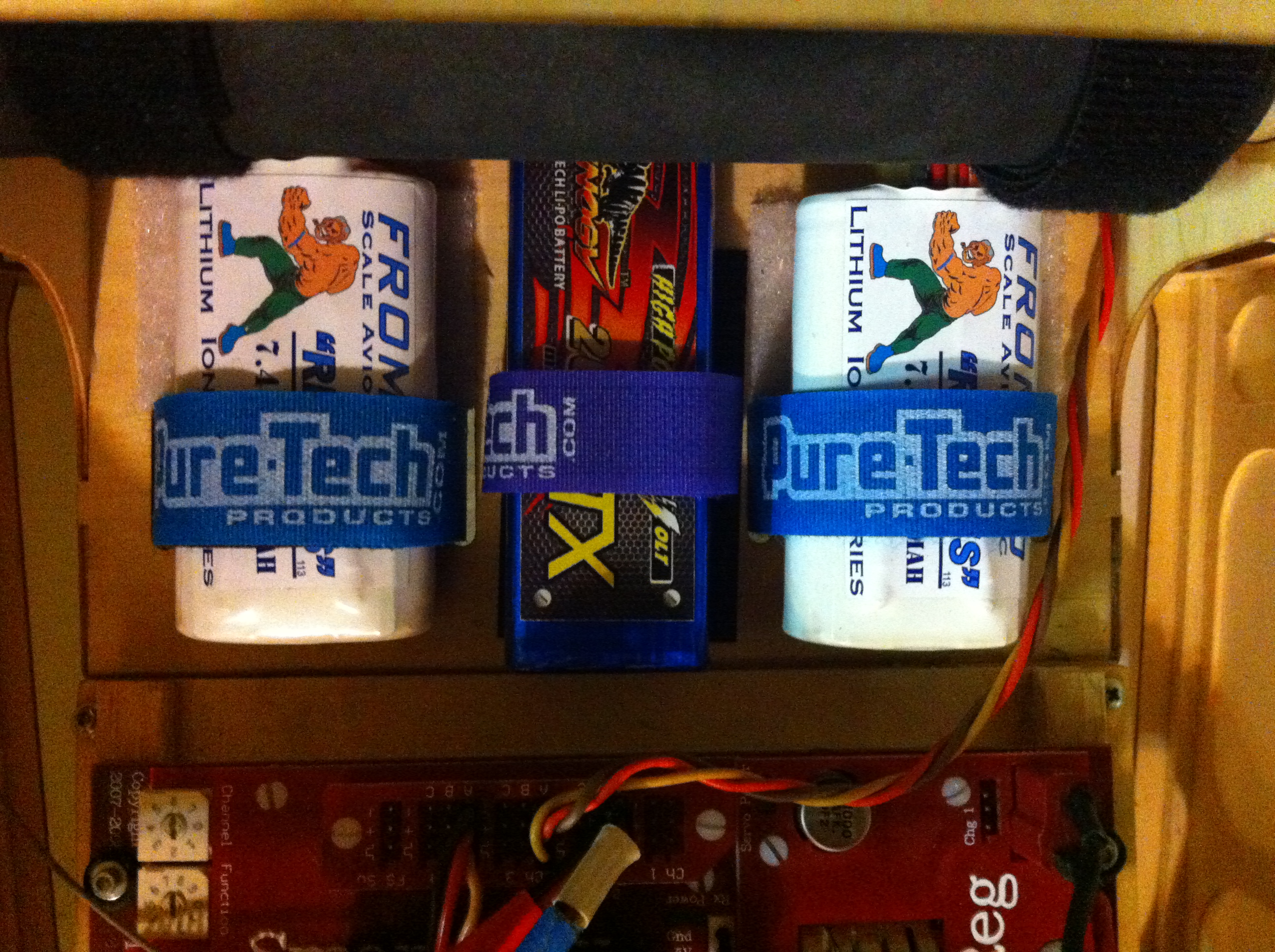

I guess for me it's a security blanket knowing I have two batteries for my rx and servos and one dedicated lipo to my ignition. I also think it's a bit of a safety issue as well. Something that big on one battery.... could be scary, lol. Again, only my opinion and nothing more and note.... I am a bit of a worry wort so there you go. :)
