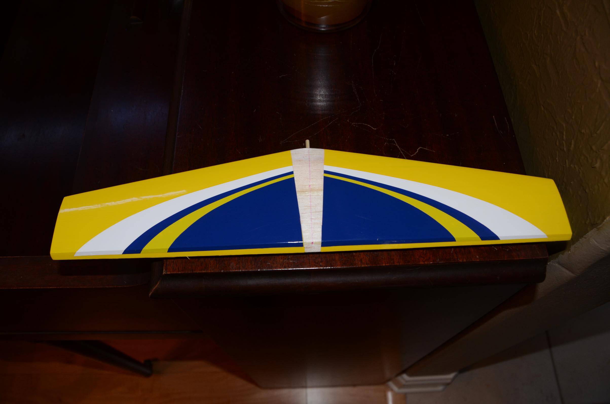

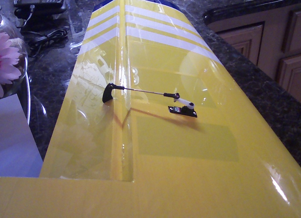

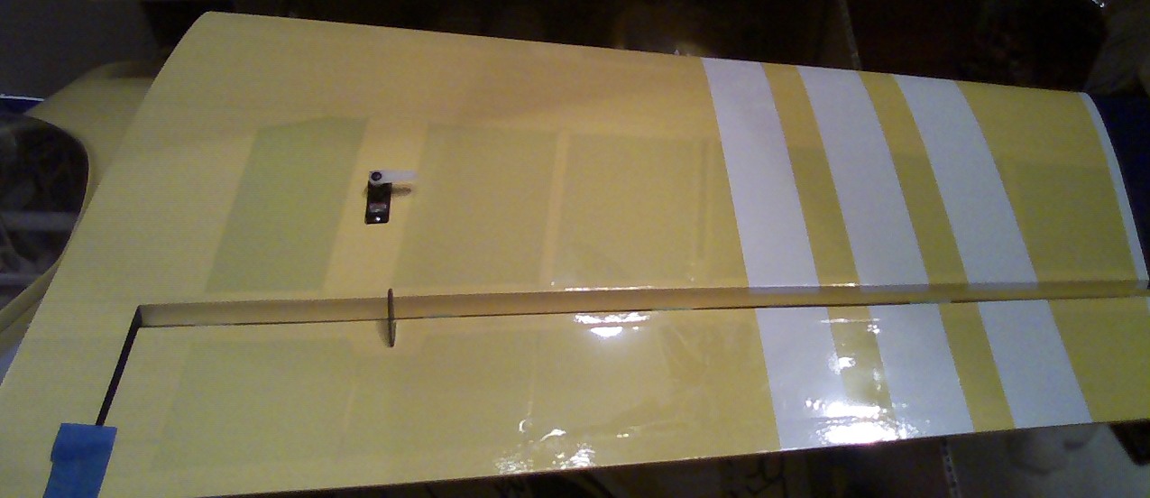

:banana: Just got the wings built up. I am using HS-65MG's in the wings. Here are a couple of photos. The first one is after the ailerons are CA'd to the wing, using the method in the instructions (T-Pins to ensure even spacing). This is with the CF Control Horn installed, Servo installed and the ball-links are ready to be adjusted and put on. I taped the aileron flush with the wing to get the ball-links perfect. Worked like a champ!

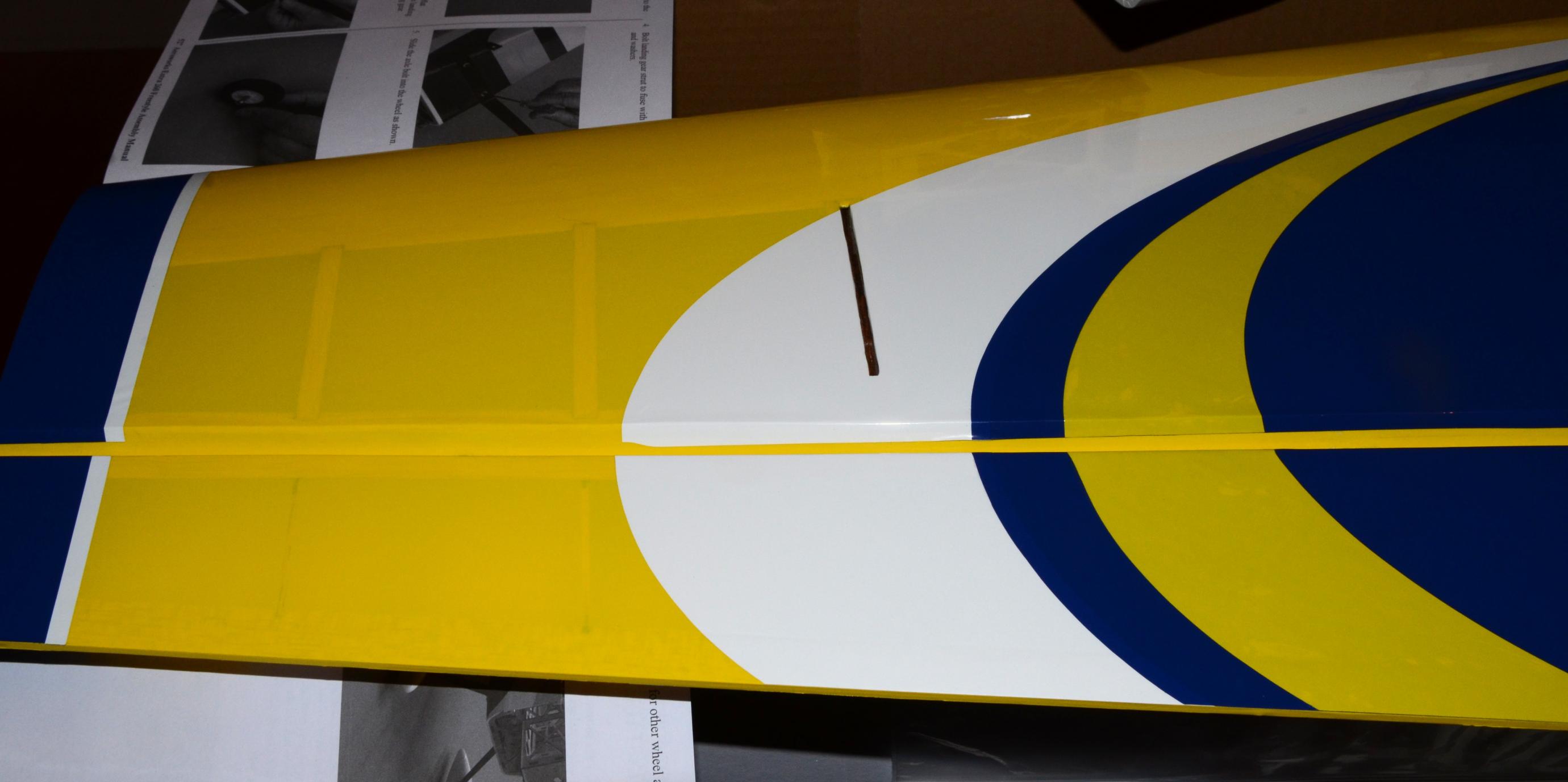

:thumbup: I seal all my hinge gaps; the 2nd picture is with the sealed gap- I used yellow ultracote to cover the gap. My method for sealing the gap is to cut a 1/2" or 3/4" strip of ultracote, then begin on the inside wing at the hinge-line, and seal both sides of the gap with the aileron as deflected as I can make it. This ensure the ultracote won't cause binding during surface movement. I keep the iron around 250F to do this, and the covering seals to either side of the gap quickly. I do this with a Trim Iron. The directions have been fantastic so far!

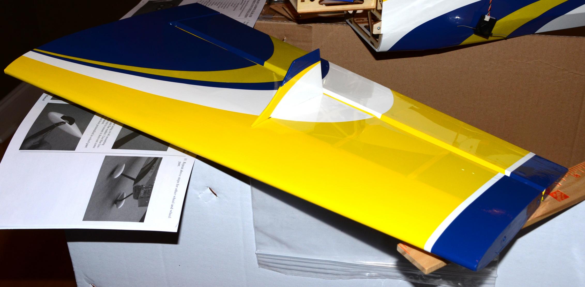

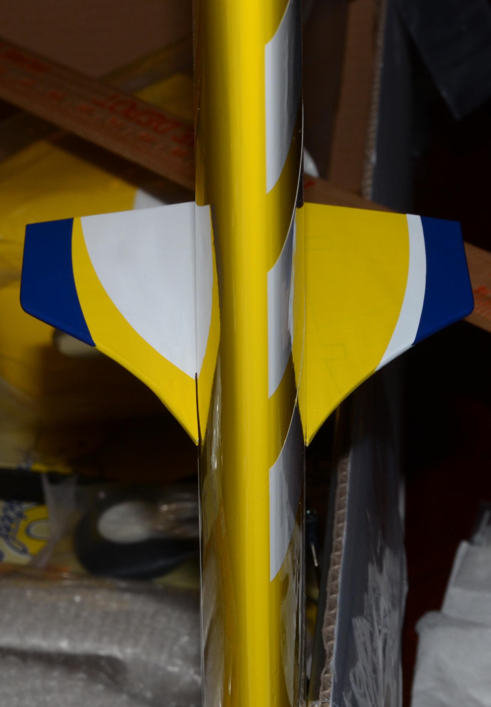

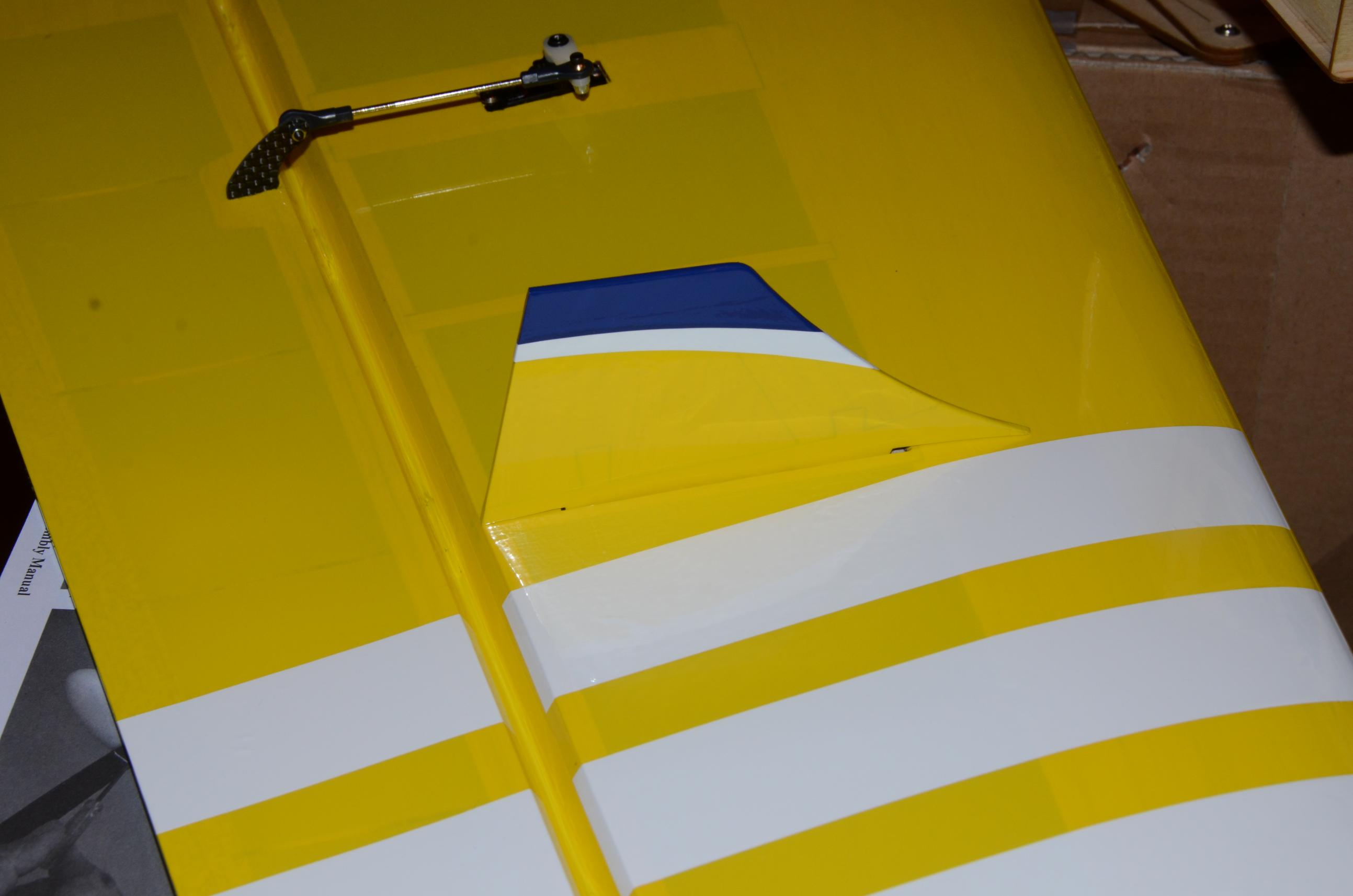

Got the wings done- check out the way the Side Force Generators fit into a mid-wing cavity- very slick. The covering needs to be cut for these, in case you'd prefer just to use the SFG's on the end of the wing. This is such a neat idea, I think I'll fly with the mid-wing installed, and leave the wing tips clean!
Here is what the SFG's look like that slide into the mid-wing slots:
Very straight forward instruction set so far!

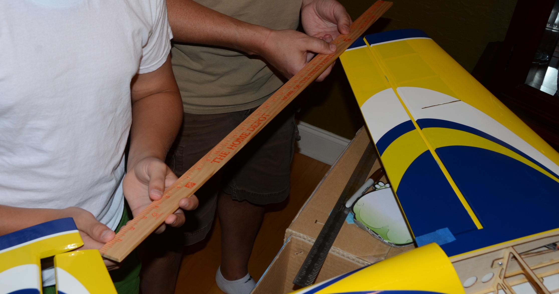

After getting the wings done, I began to put the fuselage together. The horizontal stab is something I obsess over- if it isn't installed correctly, the plane will not fly well, so I try to take my time to get this perfect (or as close as possible).

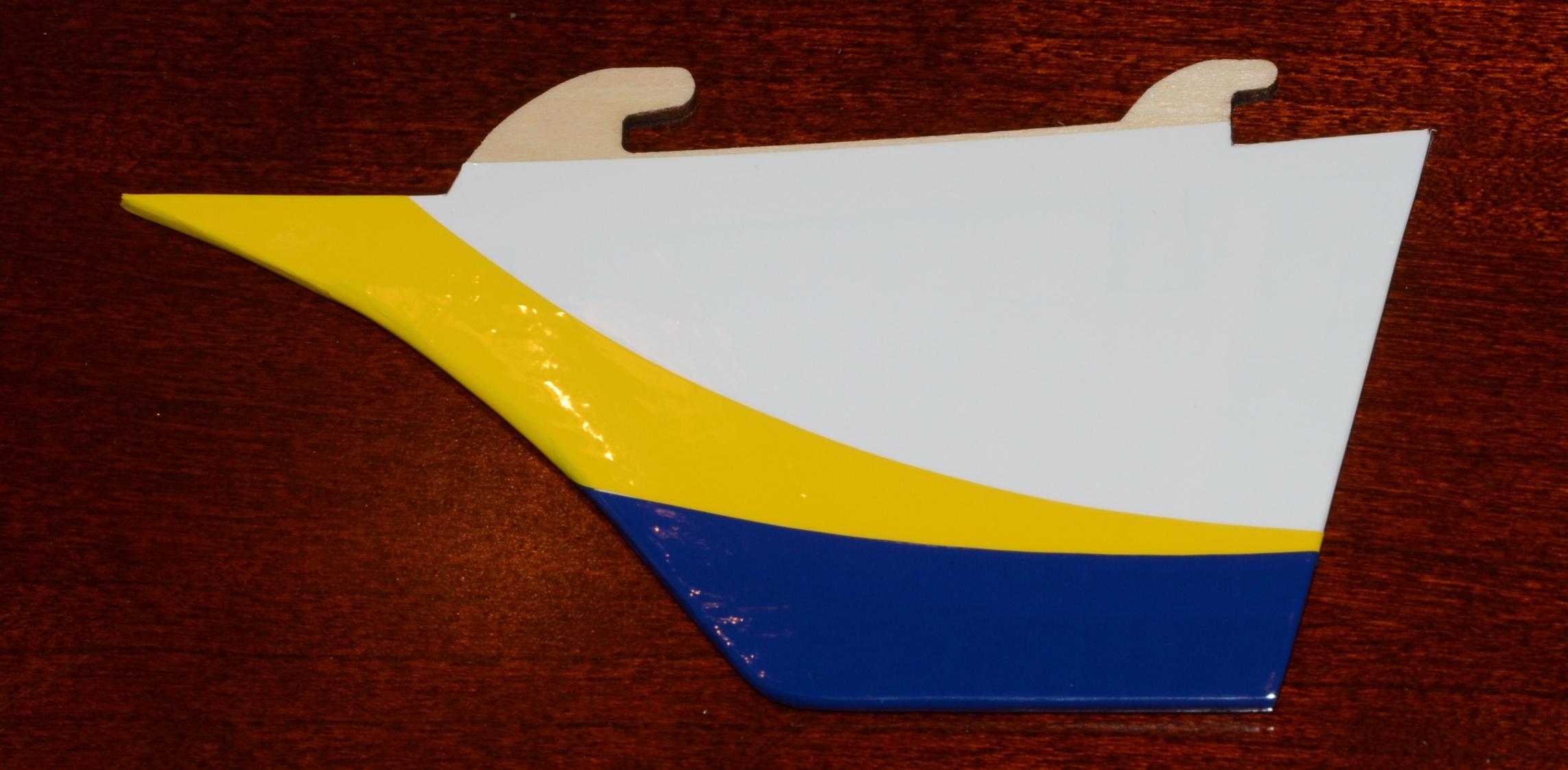

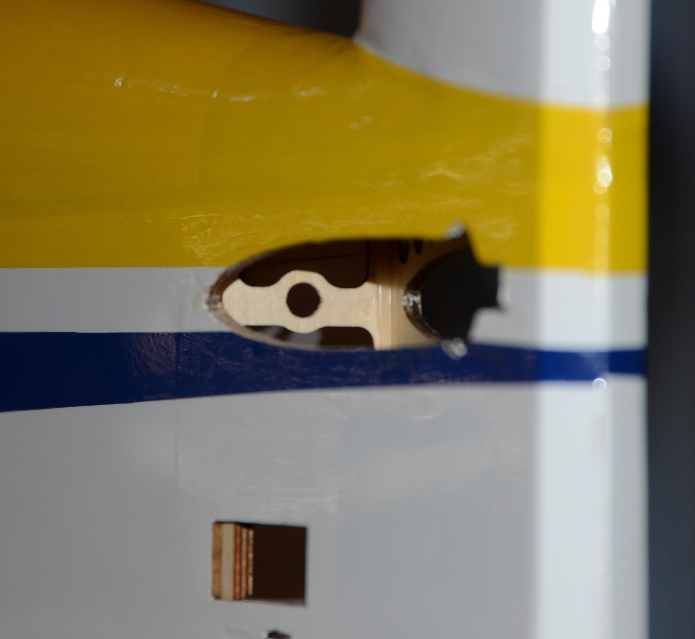

Here is a picture of the alignment system used to help reduce your workload in aligning the horizontal stabilizer (head's up, the elevator has to be inserted first, as both halves are joined at the factory- it works as advertised). The horizontal stabilizer uses a pin / slot system to speed alignment.
Here's the horizontal stabilizer (pin visible):

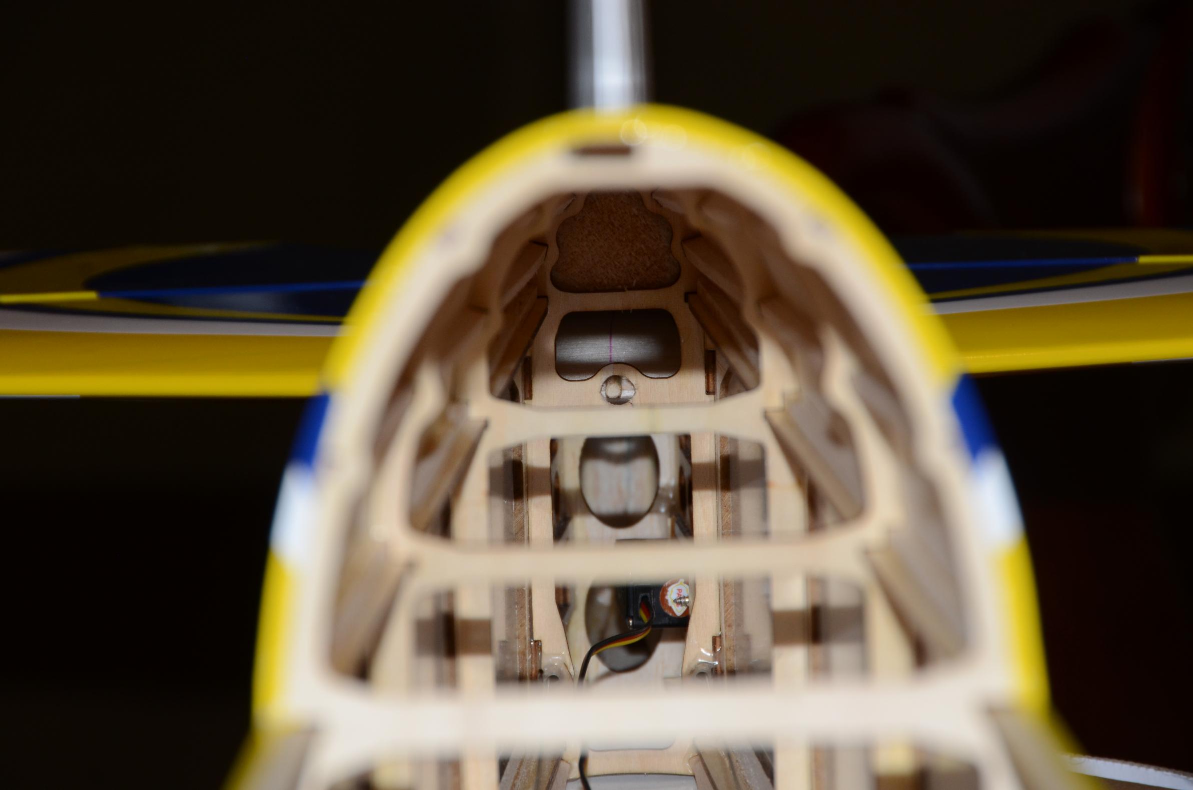

Here's the alignment slot from inside the fuse (looking towards the tail):
Here is the alignment slot from the rear looking forward:

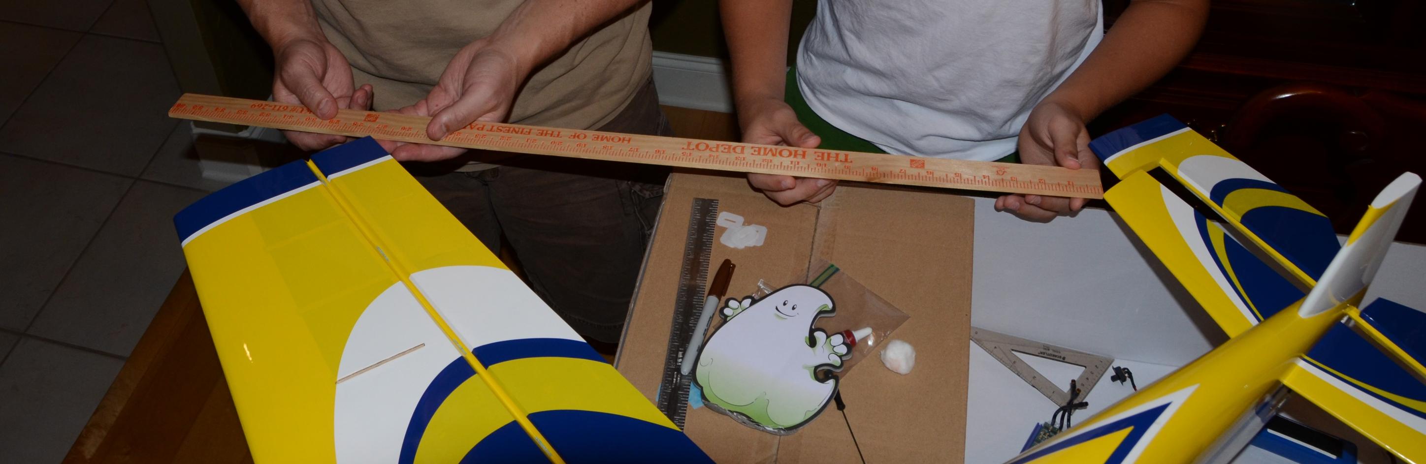

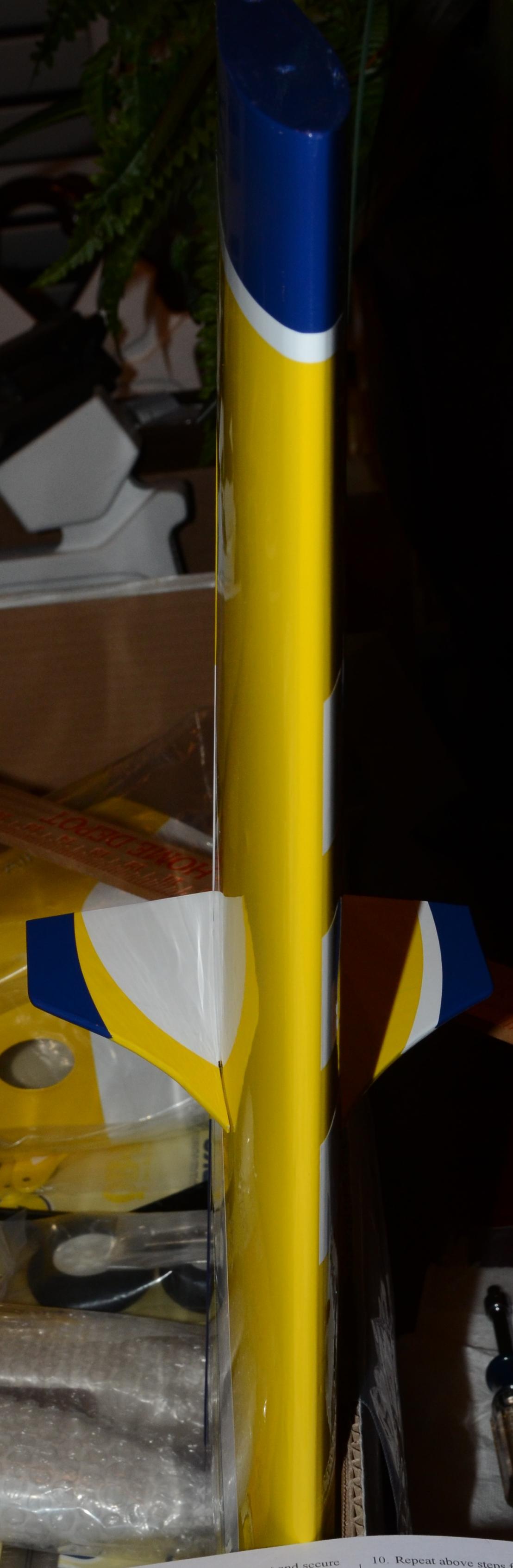

Prior to gluing the horizontal stabilizer, I measure it every way possible to ensure it is square, level and aligned with the wings. I needed a helper to do this accurately:
time + patience x meticulous nature = a well built airplane! :) Keep up the good work!
Interesting - do the instructions tell you to remove the covering? I know that on 3DHS planes, the build instructions clearly indicate to refrain from removing the covering, and just CAing the horizontal stab with the covering on. And I've done that on all my builds and never had a problem...
Luv3d
The horizontal stabilizer comes with covering- pre-removed. The customer doesn't have to mess with cutting it at all- it comes like that right out of the box. I have done the same as you have for all my other builds (all 3DHS or Extreme Flight). Not sure how easy it would be to replace a stab, but this is so beefy...I'd probably be replacing the whole fuse anyway....
