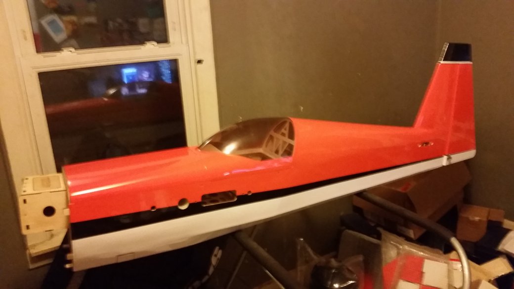

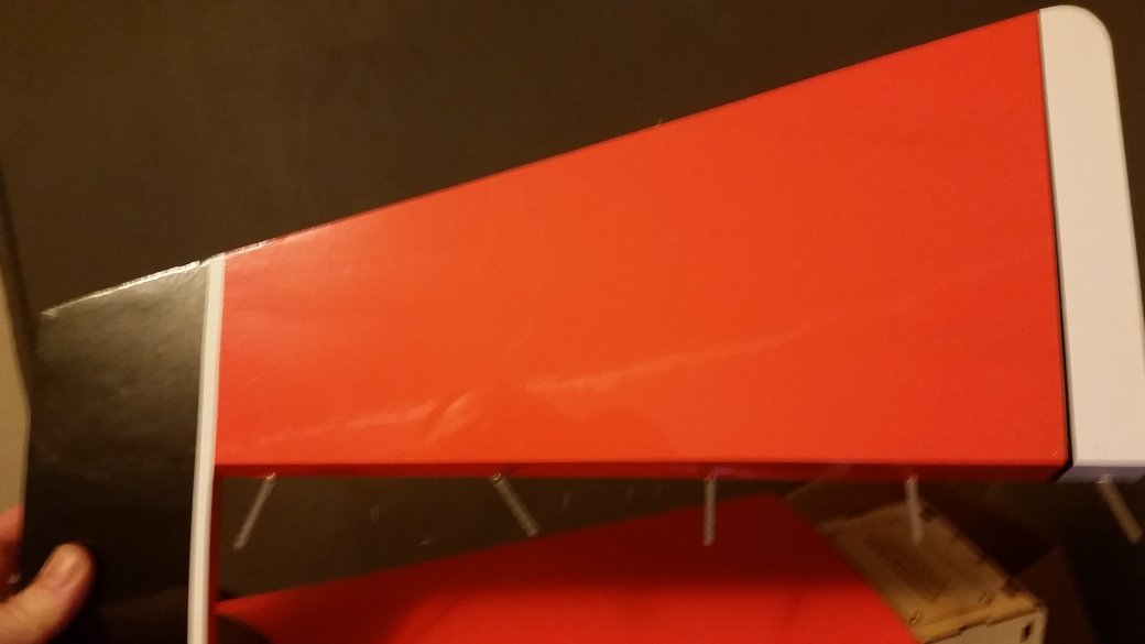

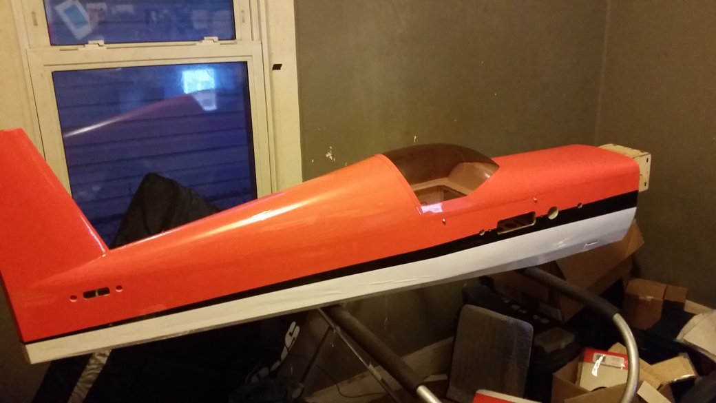

I did get the fuselage and the rudder ultra cote stretched back out, they both had a ton of wrinkles. I hate having to re-shrinking the covering, one slip and you have a hole...but I made it through it with no holes. :woohoo!:

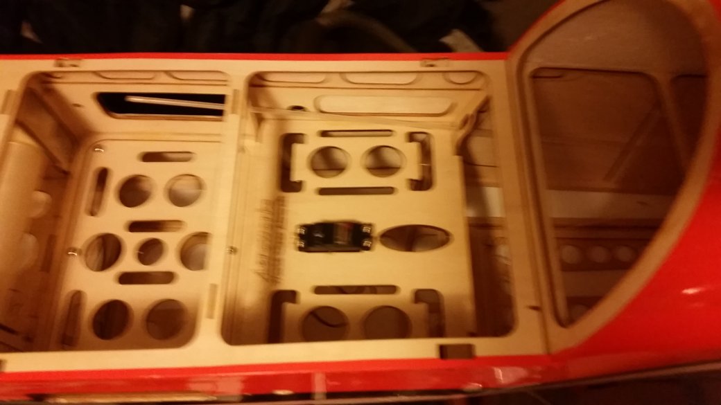

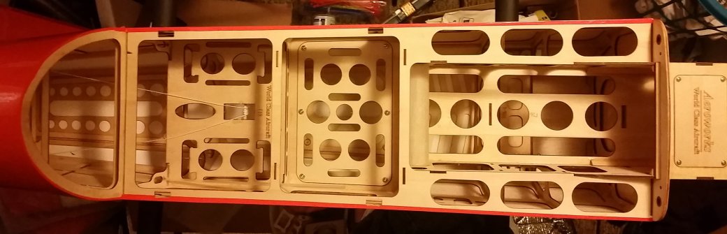

I did get the rudder servo installed. There is a ton of room in the fuse for receiver, batteries, fuel tanks, and all other stuff.

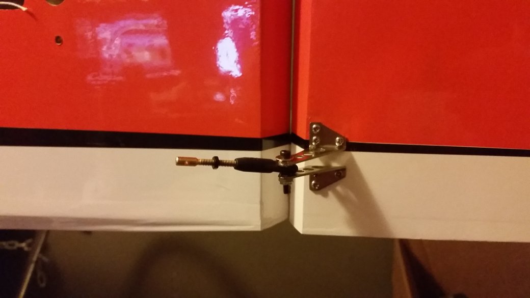

Last thing I had time for last night was I installed the control horns on the Rudder and test fit the rudder to the horizontal stab checking for proper gaping and movement. I do really like the Horns that AeroWorks provides cause there is no epoxy involved

Must admit, I do like the ample room inside the fuse. I noticed the bottom aft fuse structure. behind the turtle deck forward former. It is lazer cut lite ply. This is cool. Typically most arf makers just use stringers. Is the rest of the fuse similar to this? Think it adds any extra weight?
toysforbigboys
The whole fuse is like that....might add some weight, but I will take the weight for the strength...this plane was designed around the DA50, and I am going to put a 60 on it, so I think it is still going to pull vertical forever.
I like the strength plan. Like them light, but I also would take a tick more strength over an ounce or two total. The 60 will yank it around like my pup yanks his stuffed animals around. LOL
If it's like my Aeroworks Extra 300 some of the ply in the bottom of the fuse is to make a tuned pipe exit easier. On the Extra there are two hatches on the bottom. One for a can and one for a pipe.
There does seem to be more room inside this one then there is in my Pilot Edge. I'm also interested to see what your final weight comes out to be.
