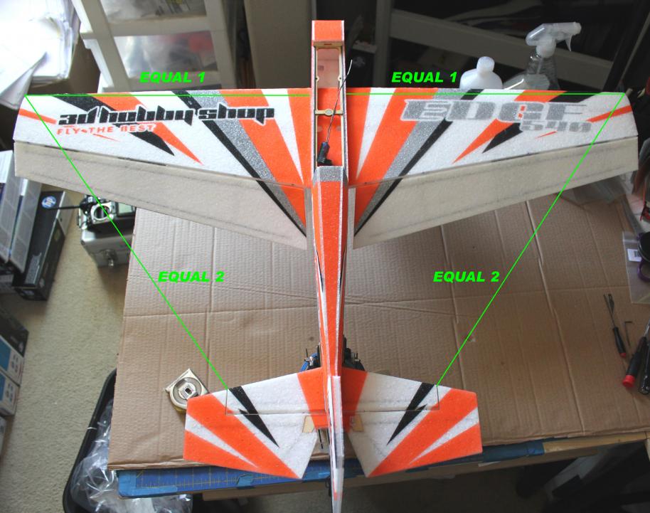

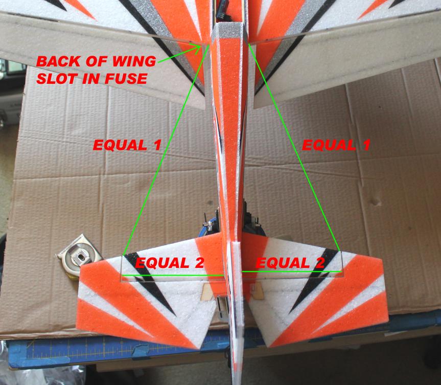

couple diagrams to help with the build

quick notes about the wing "twist" issue some have experienced:
after doing the "taped pencil" test on the wingtips to check alignment, all said and done, the wings on this one were pretty good, just barely warped, typical "epp behavior" sort of issue. Took it out and warped it back just a little bit, test fit again and it was about dead nutz. Level with the fuse on each side and equal distance from wing tip down on each side.
the bigger issue on this particular plane was actually the horiz. stab. Turns out one side was about 1/2" above the other. Simple fix with some pressure, but if I hadn't checked it closely, I would have thought it was the wing, and would have kept messing with the wing when it wasn't really the problem. So as a heads up, if your stab. and wing don't appear level/parallel or on the same line with each other when looking from the tail, take a closer look at the stab. before doing too much with the wing.
