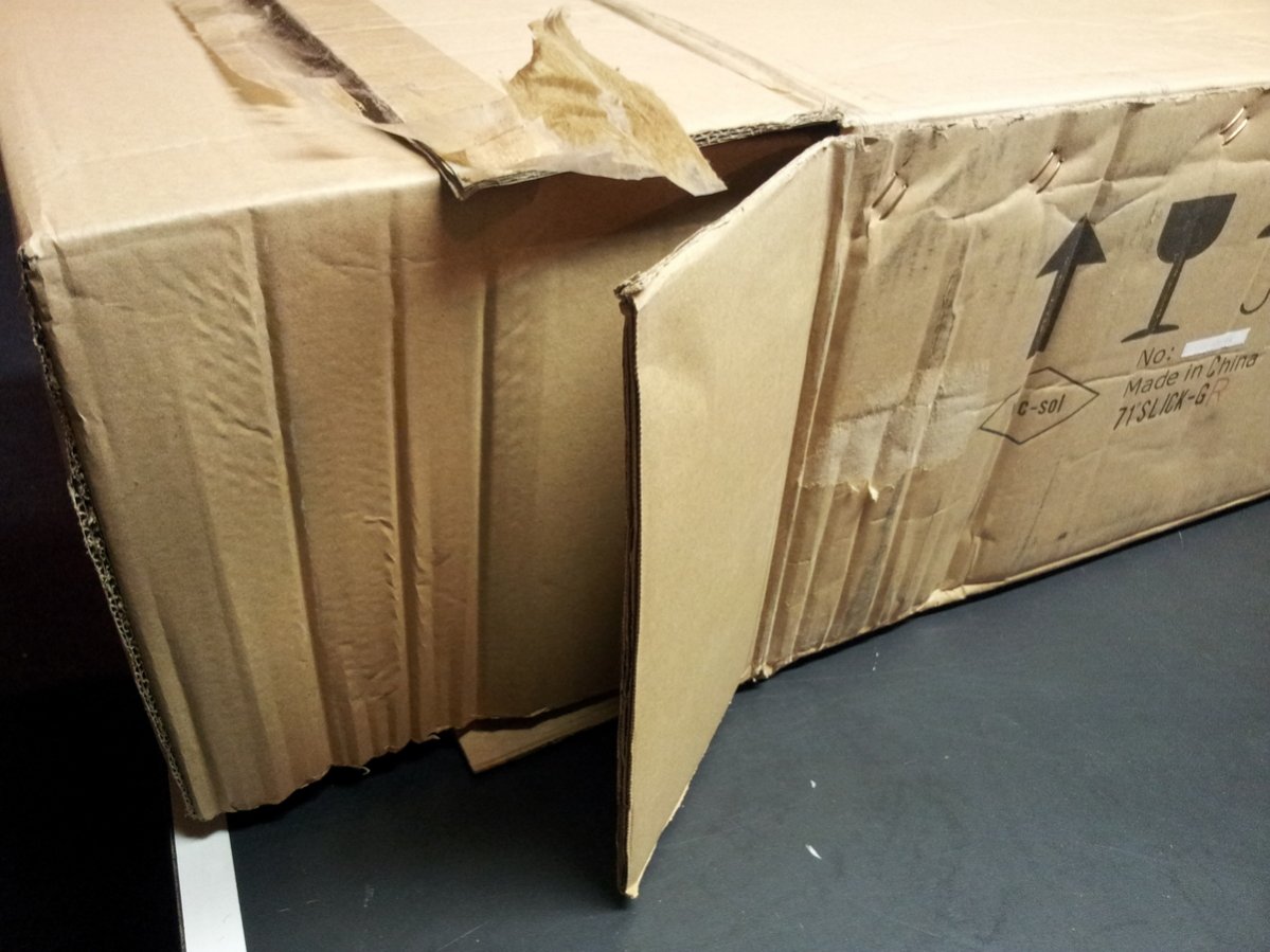

Going back to the very beginning, this is how the box looked when it arrived:
Fortunately, the awesome double boxing saves the day!
(absolutely no damage to the airframe) :D

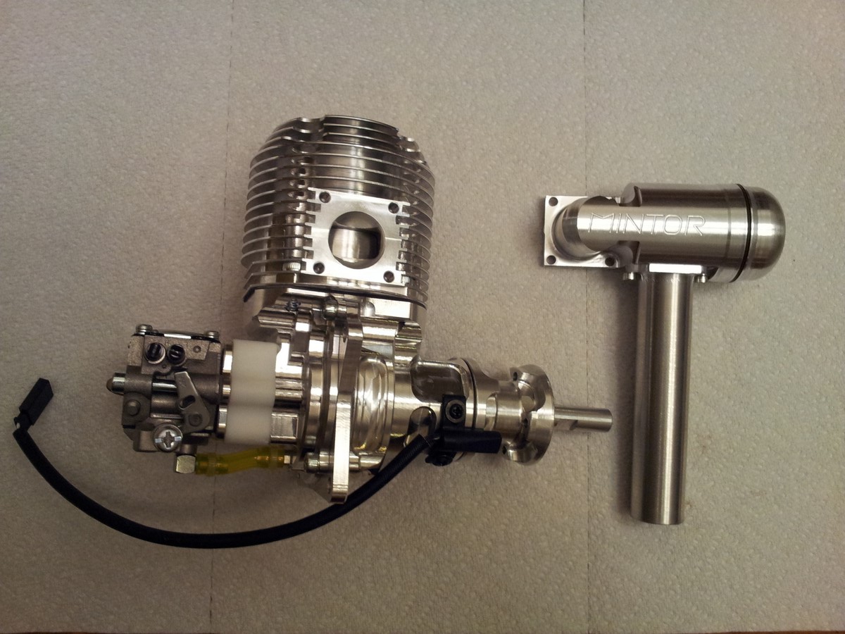

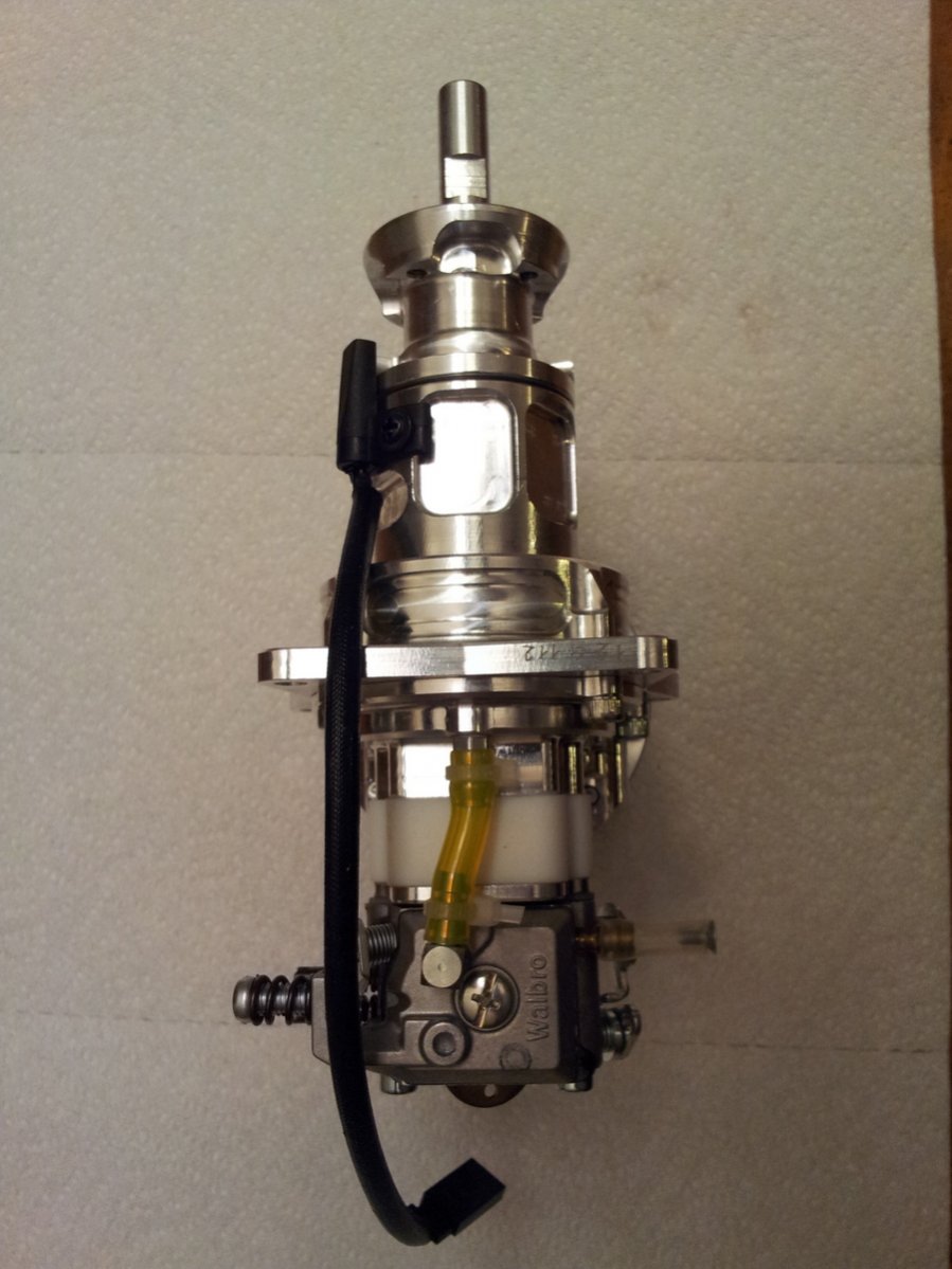

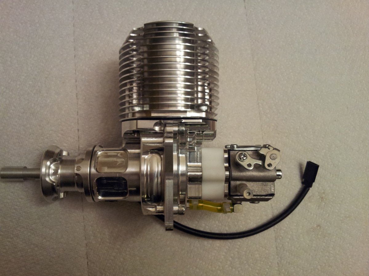

Motor choice: I originally purchased this motor (Mintor 33) for the airframe, but other owners reported that there were quality issues with this engine so I decided not to install it.
Ultimately, Mintor is making good on their quality issues and stands to regroup from last year's issues, but this all happened after I had made my decision to go another route.

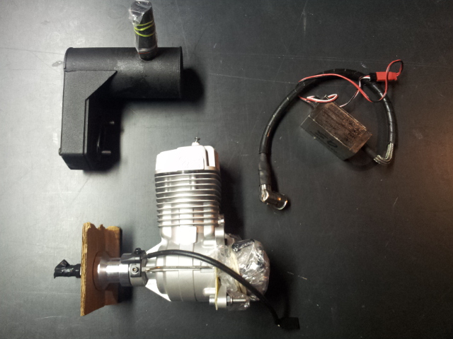

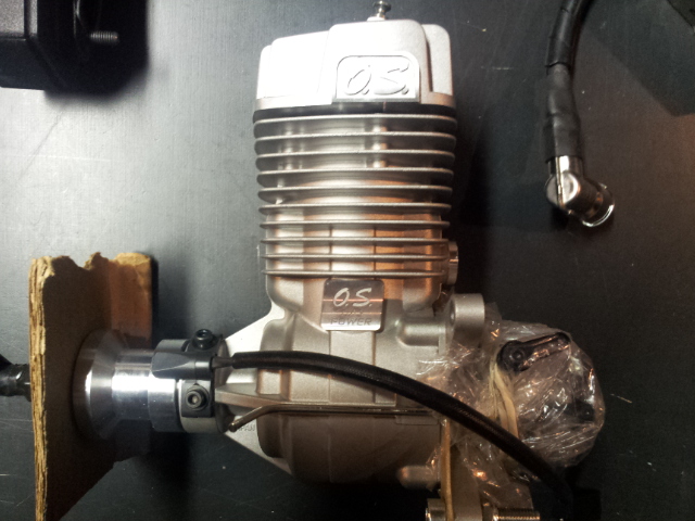

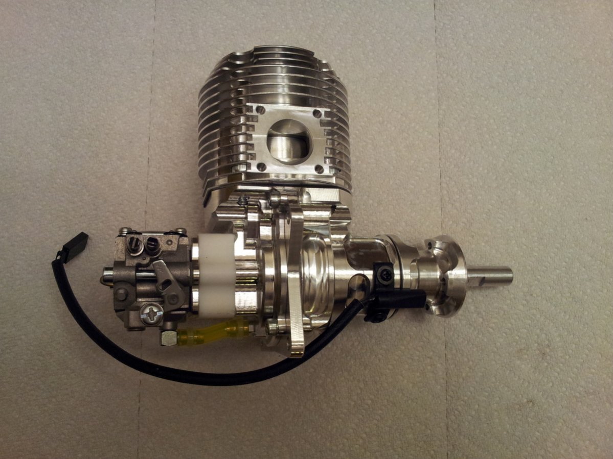

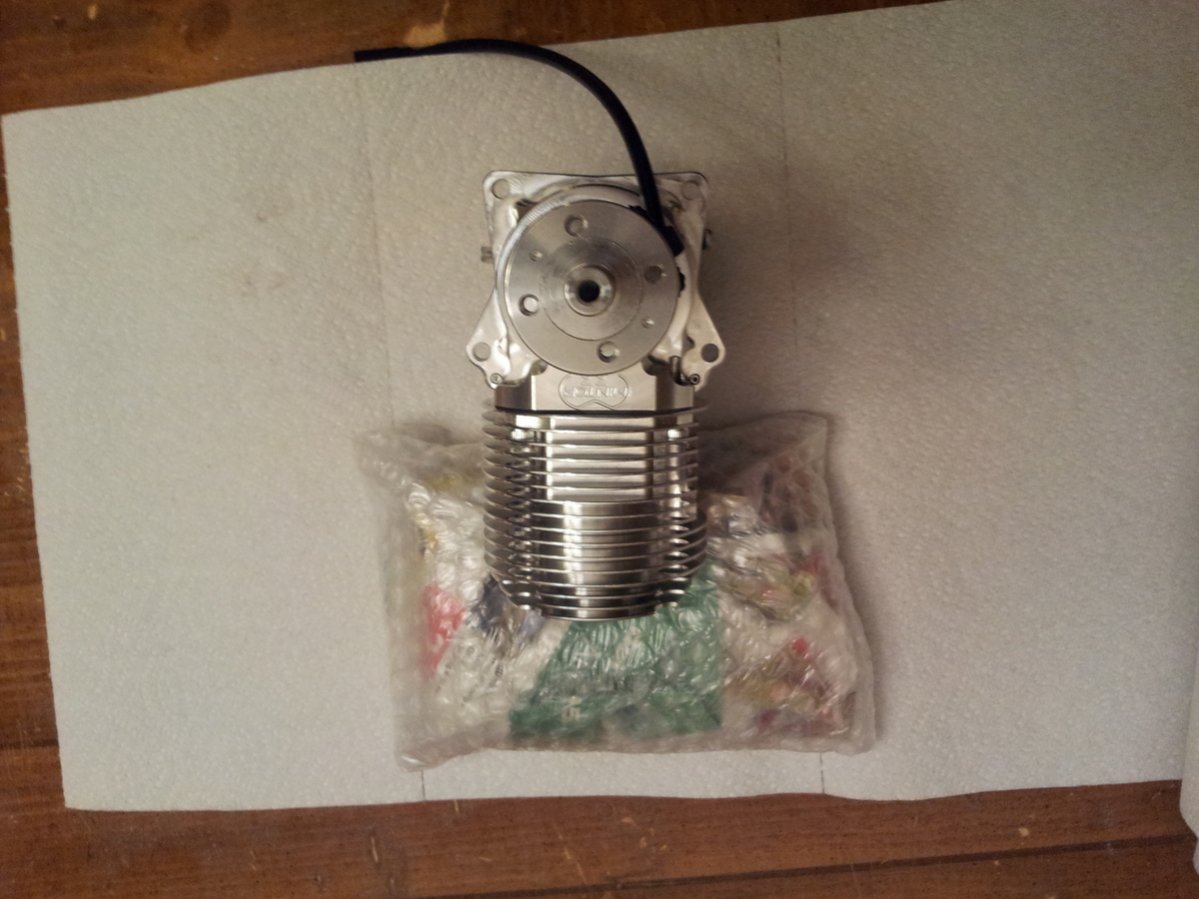

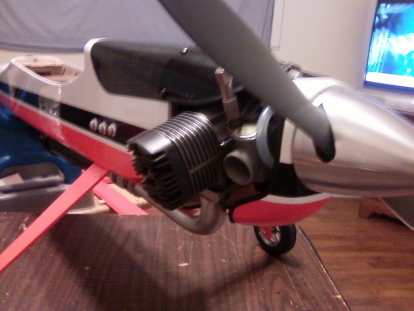

Instead I obtained this motor (OS GT33) for the build:

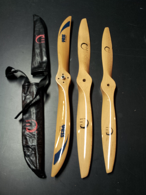

And I also got a few props in the deal!
The GT33 has a woodruff key which is a slippery little bit of metal! But I got it back together.

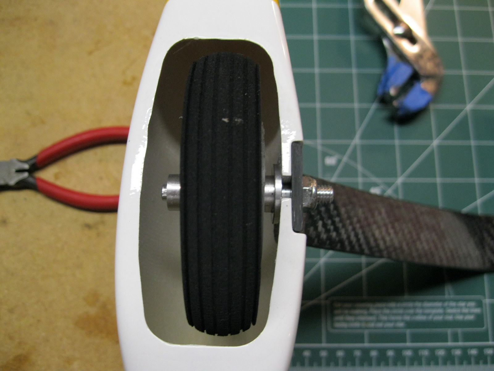

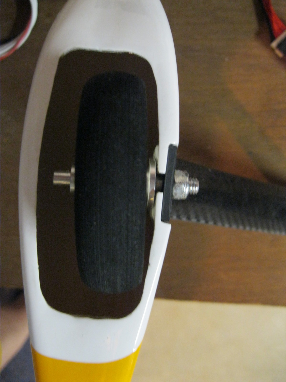

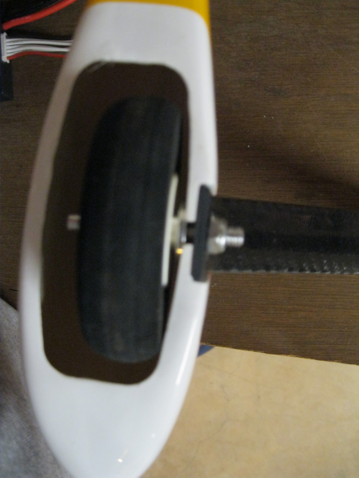

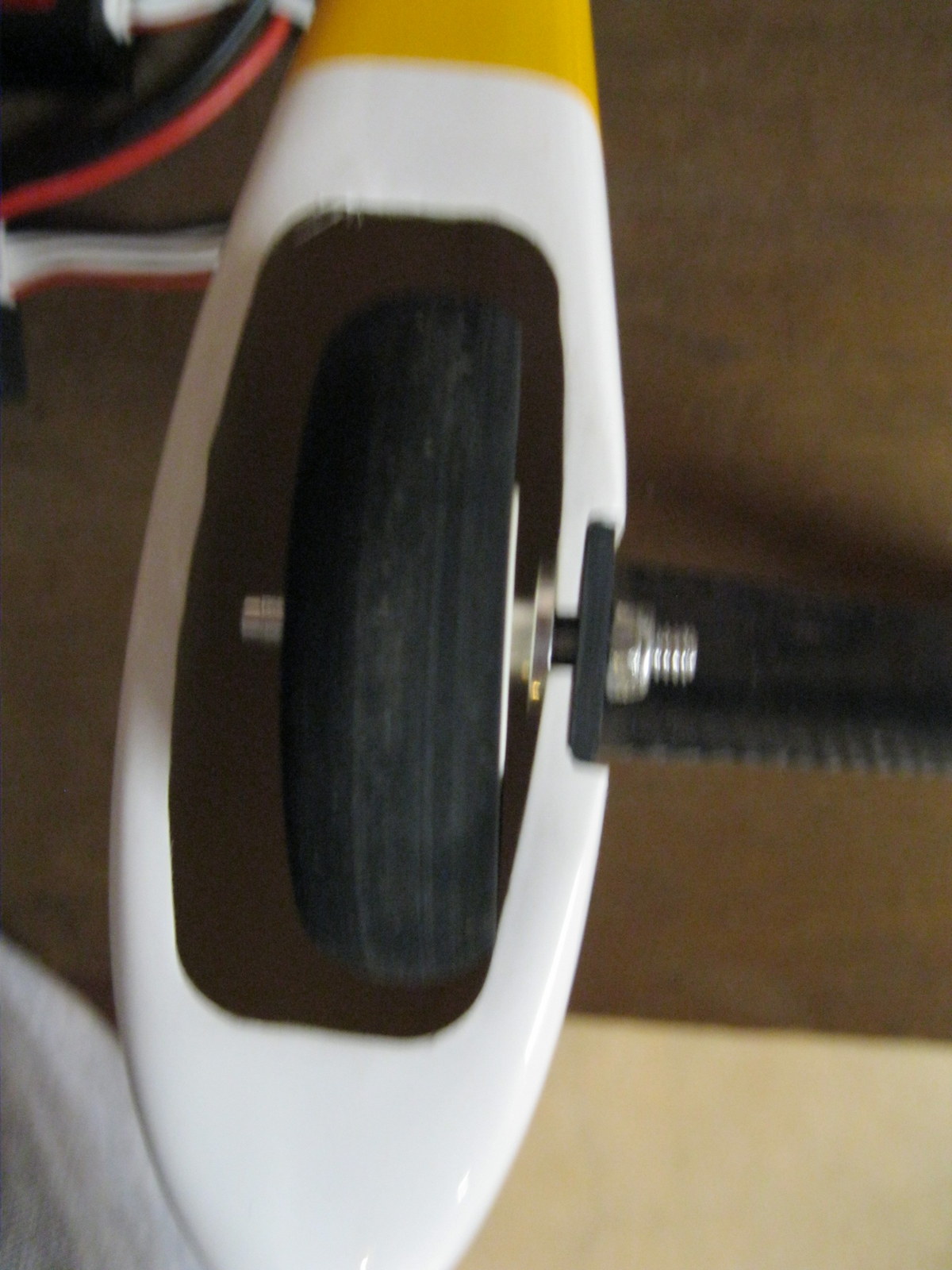

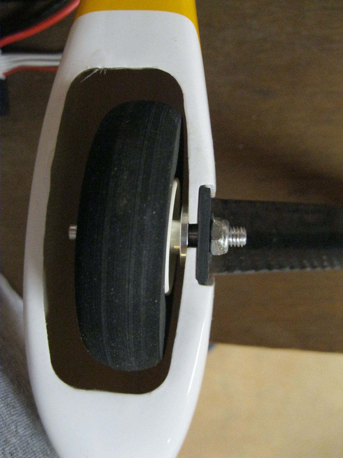

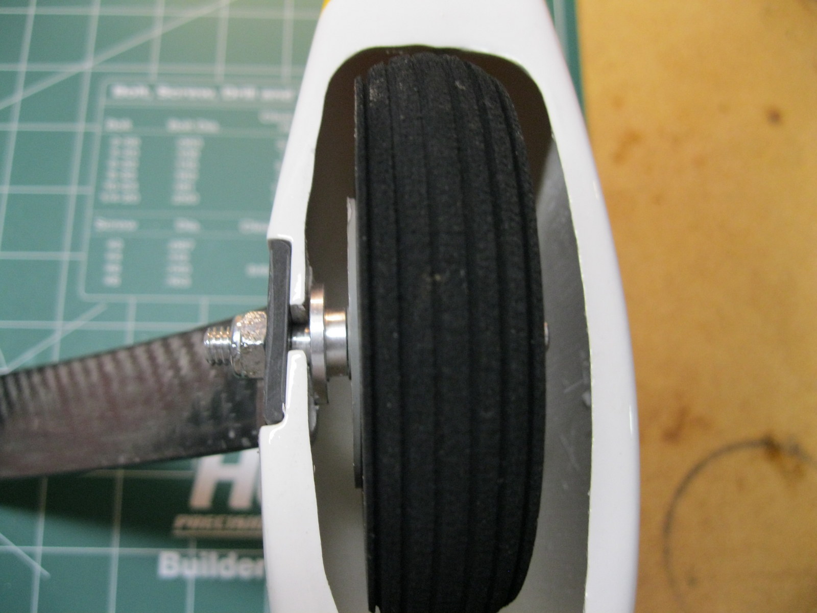

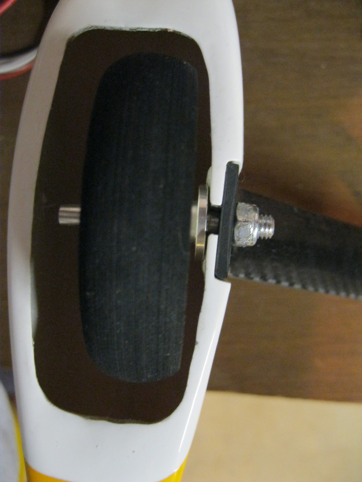

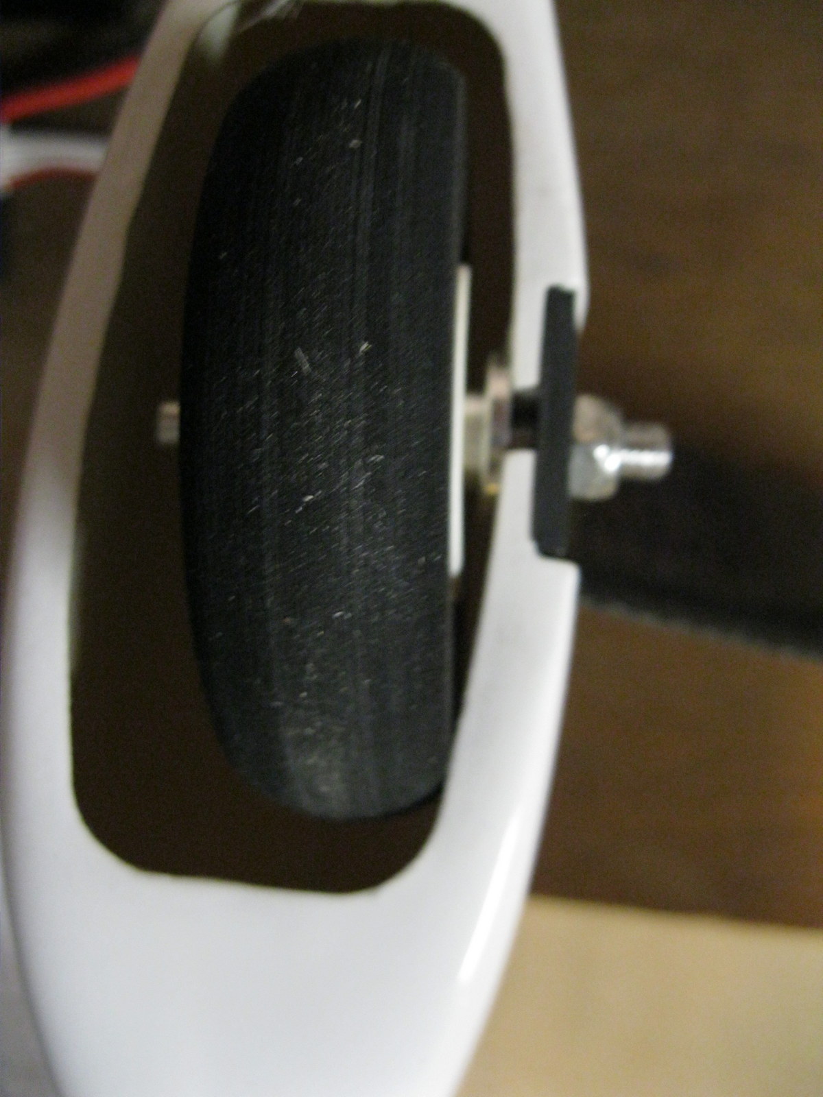

Next step was the wheels...ran into a problem here that I've heard others have had as well...the wheel holes are not round and true!
As you rotate the wheel on the axle, you can see it is out of round and actually rubs on the wheel pant as it rotates.
IMG_3738.jpg IMG_3739.jpg IMG_3740.jpg IMG_3741.jpg IMG_3742.jpg IMG_3743.jpg IMG_3744.jpg IMG_3745.jpg

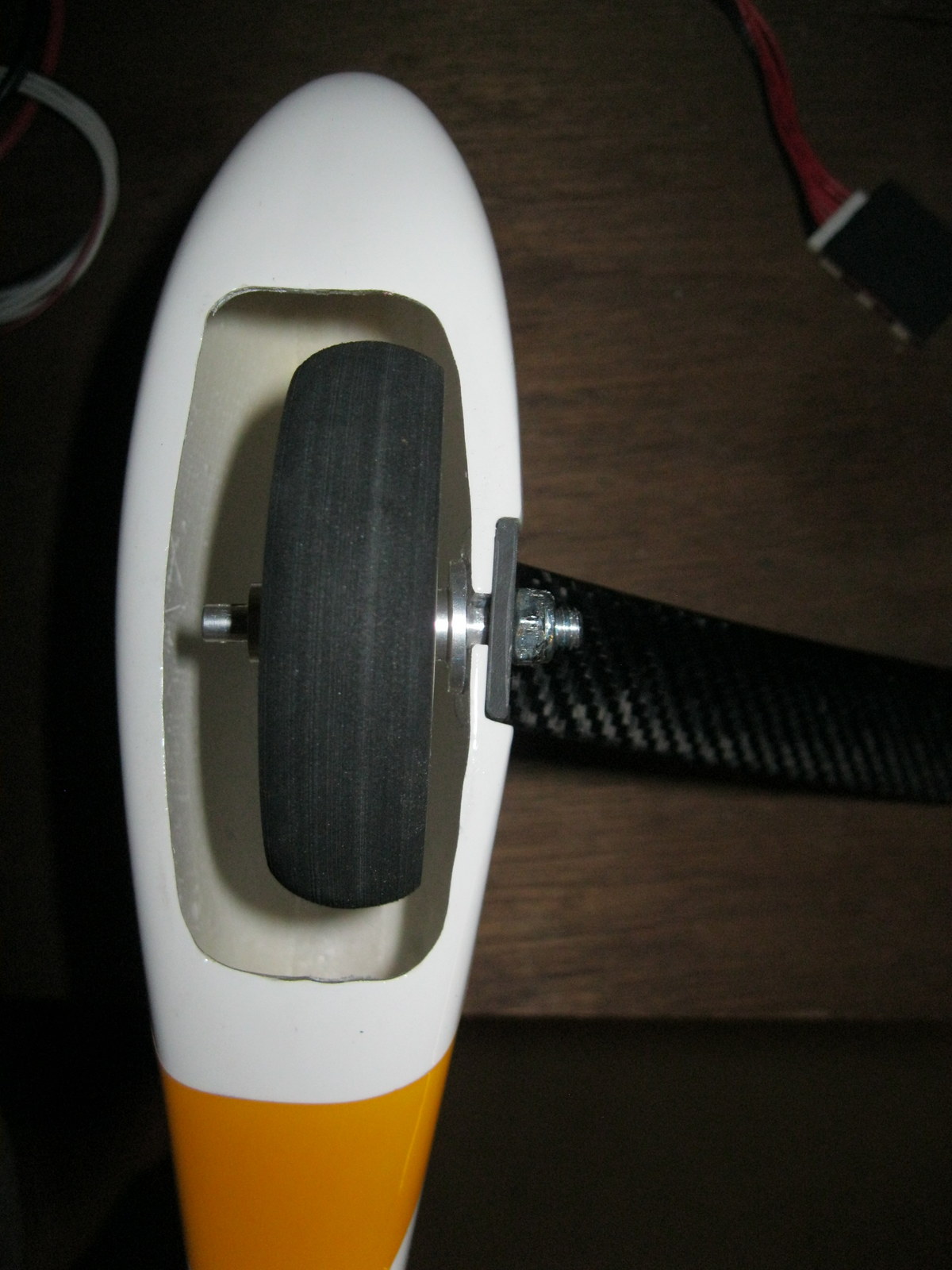

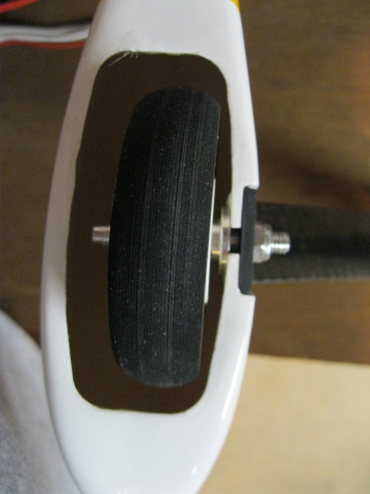

this was pretty frustrating...but I found a solution at my wonderful LHS:
These rotate perfectly and this was a simple solution to the problem. These are also slightly bigger (1/4") than the stock wheels, which is good since I fly off a grass field.
View attachment 9491 View attachment 9492 View attachment 9493 View attachment 9494 View attachment 9495 View attachment 9496 View attachment 9497 View attachment 9498
View attachment 9499 View attachment 9500
View attachment 9501 View attachment 9502
Nice "hop up"
I'm sure the added diameter will help on the grass field.
