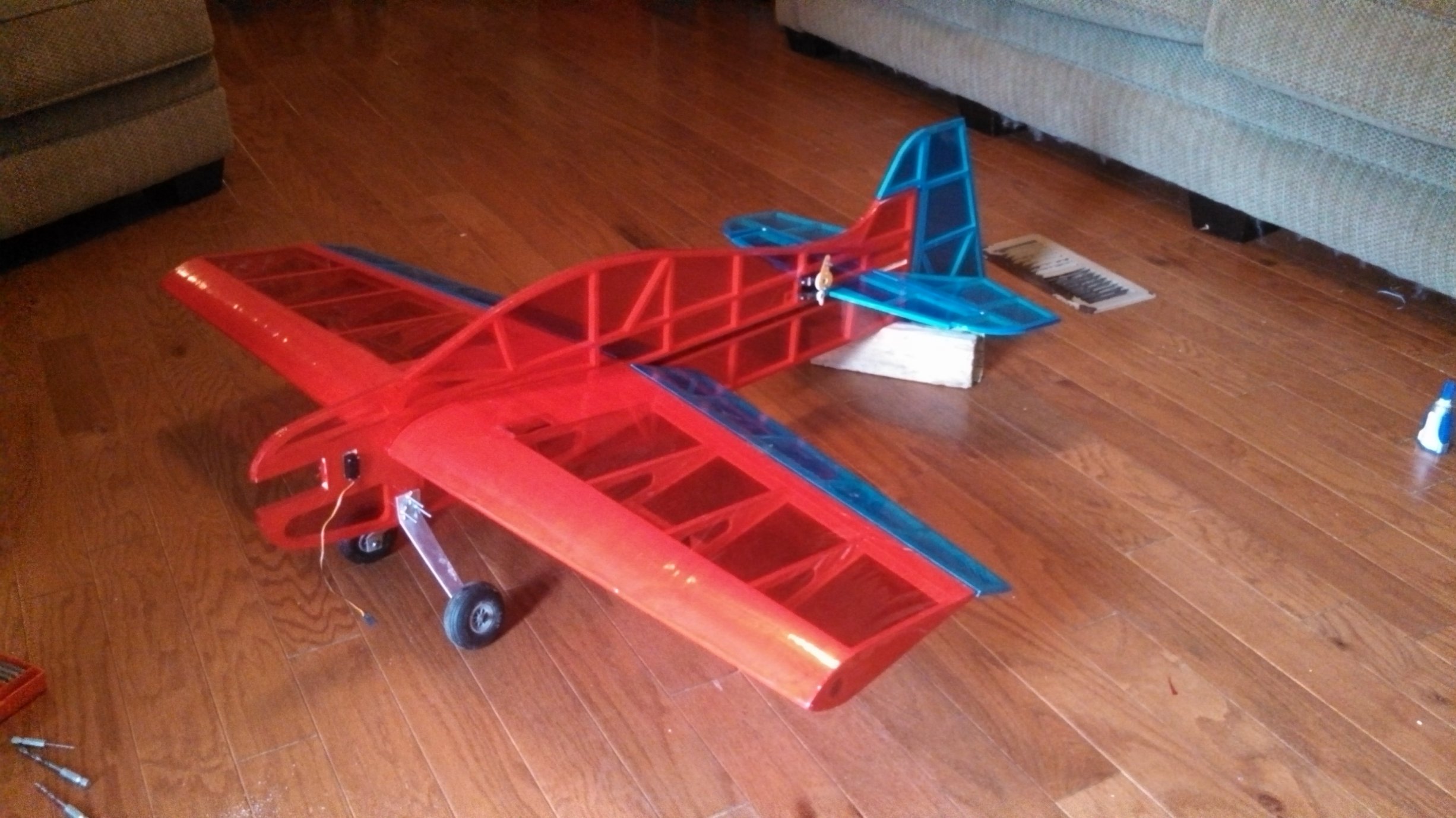

I've got a current build going on, but I see a lot of interest here is in bigger gassers and electrics instead of the smaller glows. I'm just not ready for that jump yet, financially or ability wise. So, if there's interest, I'll do a recap of my progress up to the current point.
Here's where I'm at currently.

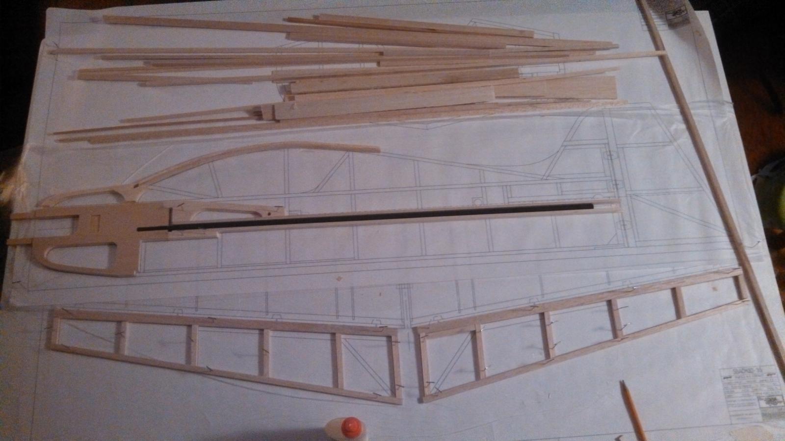

Just getting started. This is an Sbach 35 stick build. Its all cut and glue over the plans. Its my first experience, and I've gotta say, its went pretty well thus far. Here, I've finished the ailerons and started the fuselage and elevator. As you can see, its got a tube in the fuselage that really helps the structure support. Until this was glued, I was very apprehensive of the strength. Now that it is in, it feels rock solid.
A little info on it:
Wingspan 33"
Length from nose to rudder tip 45"
Claimed weight: 2.5-3.5 lbs (sorry,I have no way to accurately measure mine)
Power: 35-40 2c glow (I'll be using an OS 40 fp with a 11x4 prop)
All balsa with light ply sides on fuselage front
Control throws: I believe 45 degrees on aileron and elevator, 50 degrees on rudder
Servos: power hd1711 mg on controls, hs65 on throttle
Radio: Futaba 8fu with FrSky 2.4 module
Hope you enjoy the recap as I can post it.
